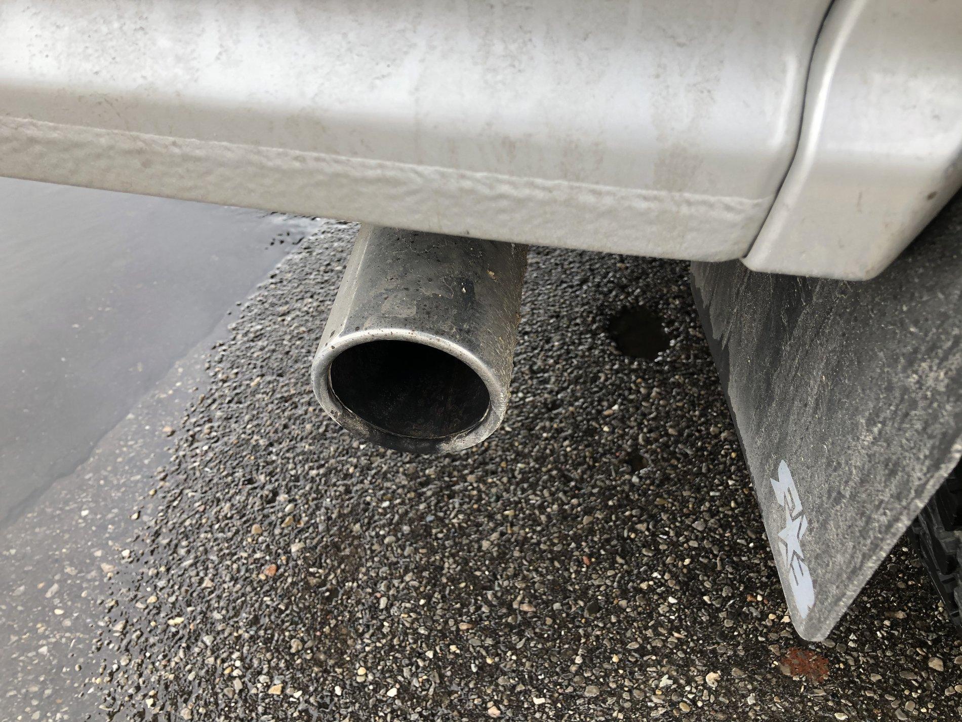

Gone Blue
Brett
Dec 25, 2019
57
60
SE MI
2019 Ford Ranger SuperCrew XLT 4X4 Ingot Silver
A new Ranger merged in front of me on the highway a couple weeks ago. It was blowing blue smoke out the tail pipe for a couple miles. I was shocked. Well a couple weeks and 1,000 miles later my truck started emitting a burning oil smell on start up which it never did from new. This started at around 5,500 miles. In addition, I have the chrome package and love the chrome exhaust tip. So much that I make sure I wipe it off after I wash the truck. The tip was always clean. However since this oil smell started I am seeing black crap on it. The truck is going into the dealer tomorrow because of a rear defroster and trailer wiring issues. Thinking I am not paranoid about the oil smell and dirty exhaust tip and that something is going on with my truck ? I will let u know what the dealer says. G.B.
