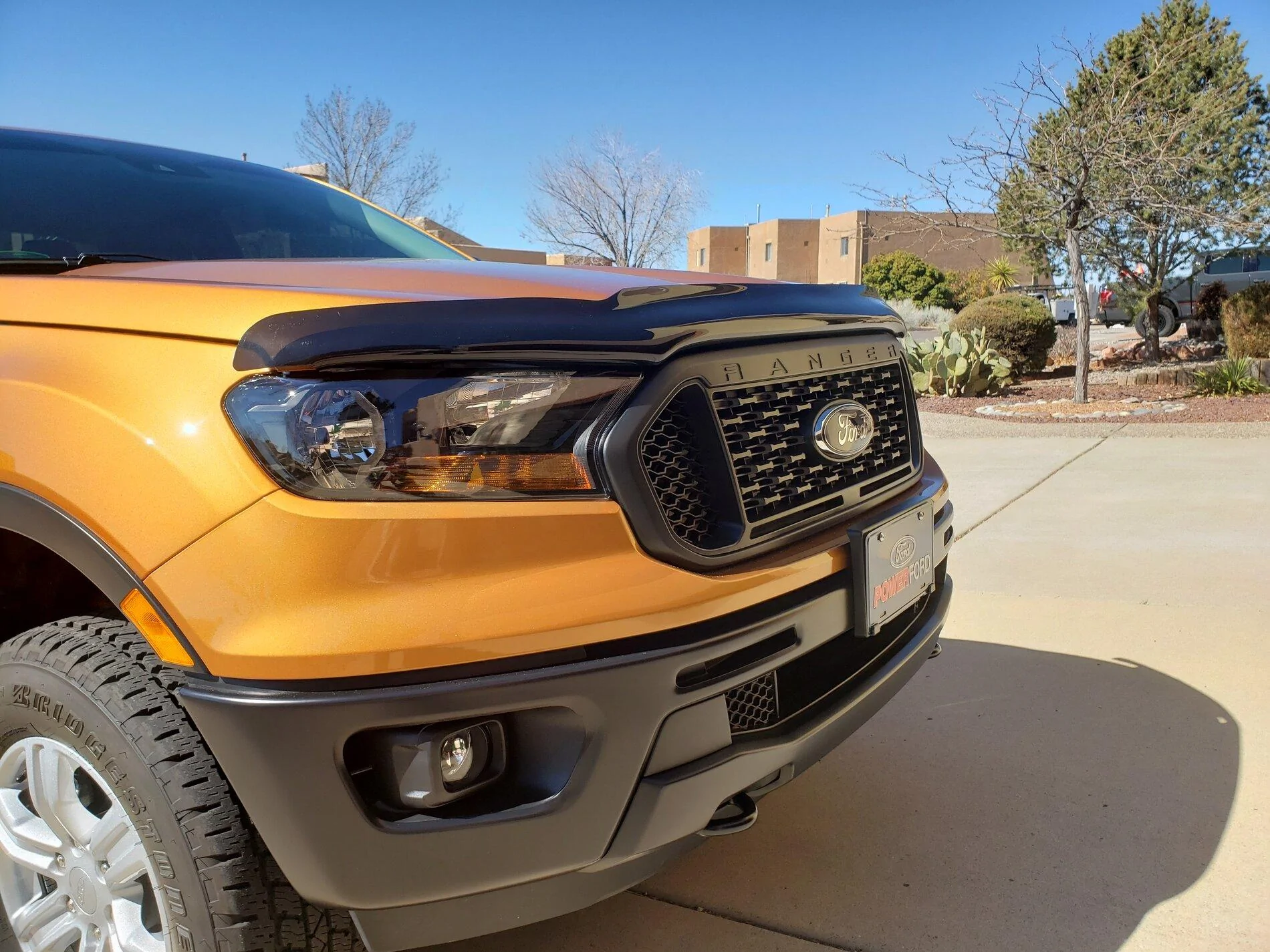

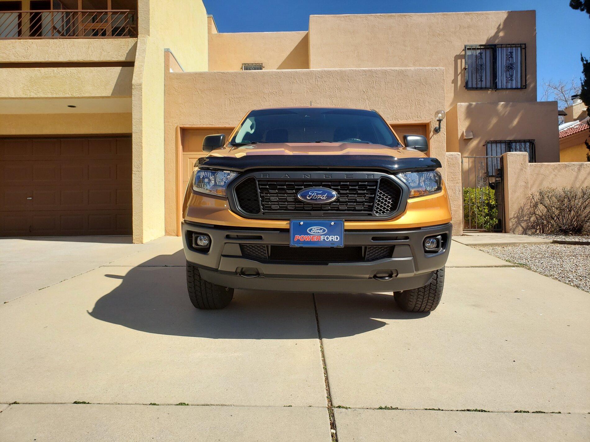

I tried to adjust the hood latch on my 2020 Truck but the grill has a different configuration that the the 2019 in the Video. I can't find any place to reach through the grill on mine to pull on the six tabs and unlock them. So does anyone know how to release the six tabs on this type of grill?

If you grab the large black plastic top plate and pull toward you and pull up near the front of it at the same time they should pop out on their own. No need to reach through. Just be careful and move slowly.

Thanks. You are exactly right and I learned that through the process. A Ford mechanic at my dealership also showed me how to slip a flathead screwdriver under the front leading edge of the shroud from place to place and pop it out. I will be doing a post shortly on my experience with this endeavor.

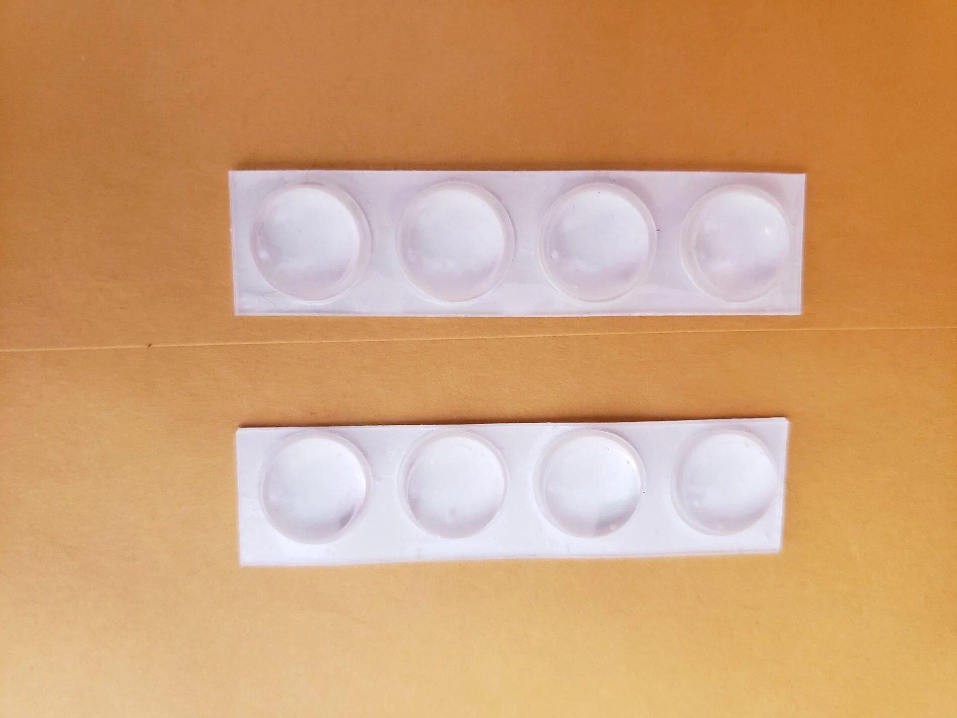

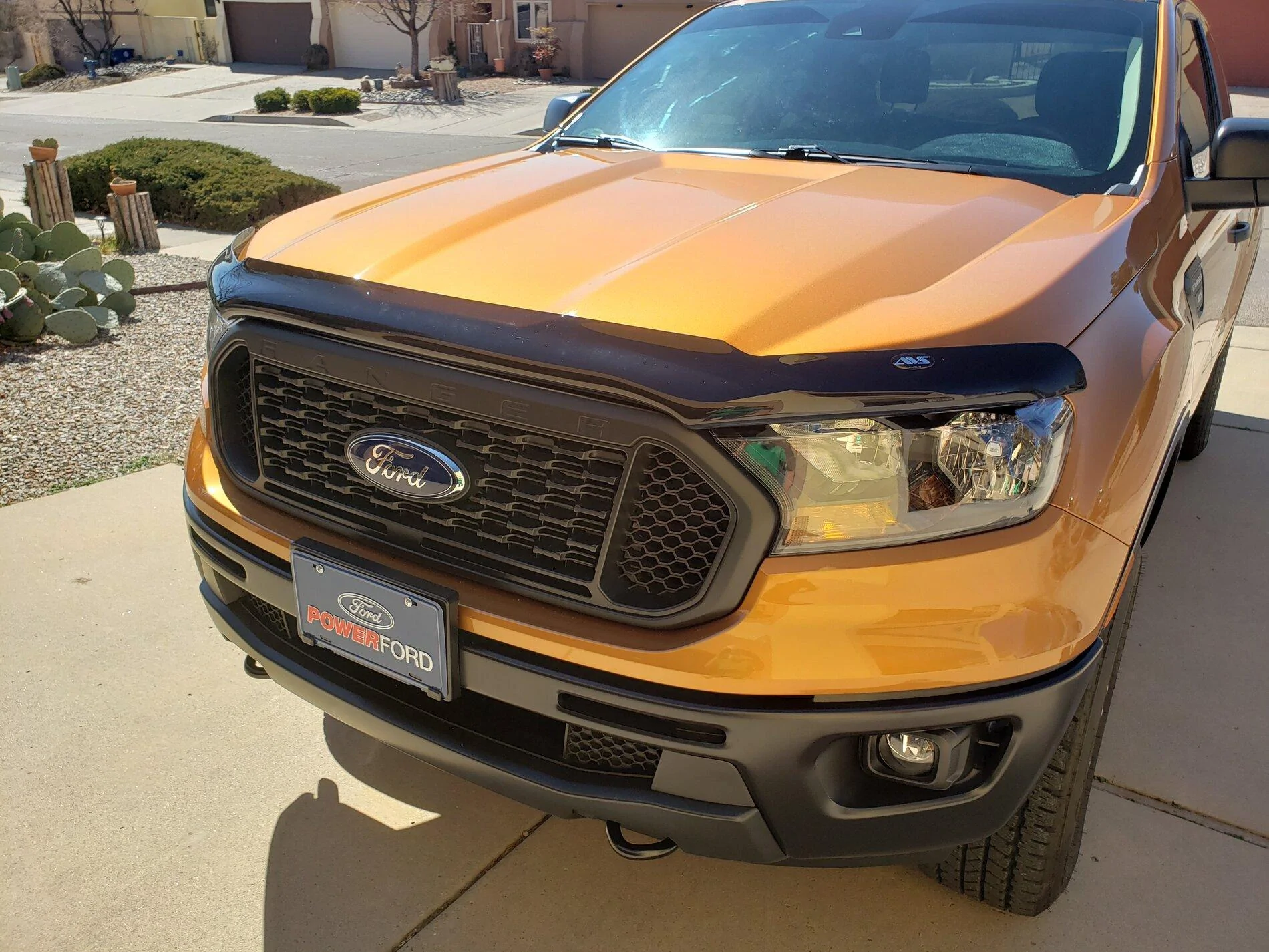

I haven't attached the Bumpers to the AVS Bugflector II yet. If I did, would attach them to the Deflector itself to protect the paint.
I can't imagine how the Deflector could touch the paint unless enough pressure was put on it to break it or shatter it. I tried to press the Deflector in by hand and couldn't get it near the paint. It doesn't seem reasonable that the force from the wind while traveling could push the Deflector against the paint? Has anyone had any issues or experience with this or any idea why the Bumpers are really needed?
Thanks for your input.

I put mine on the deflector. Doubt it will ever flex that much and they'll probably all fall off after a while, but I put them on anyway.

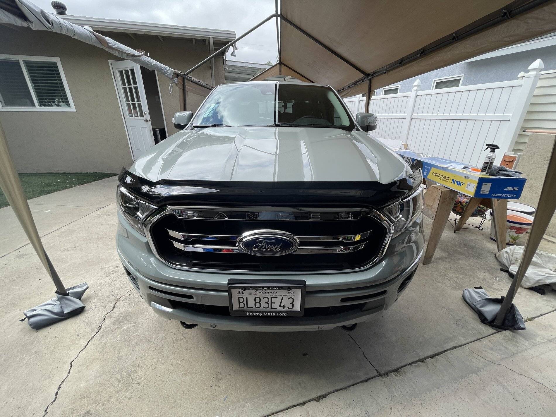

Installed the AVS Bugflector II. Easy install with no drilling or sticking anything to the hood. This is the first time I’ve ever used one so hoping that it works to help protect my hood and windshield. I also have the WeatherTech wind deflectors on the windows, which I’ve had on just about every car.
Edit: BTW the kit comes with little clear bumpers that AVS says to stick on your hood in case the deflector hits some seriously heavy wind. I stuck them to the back of the deflector instead.
