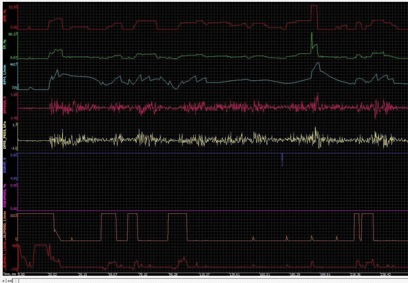

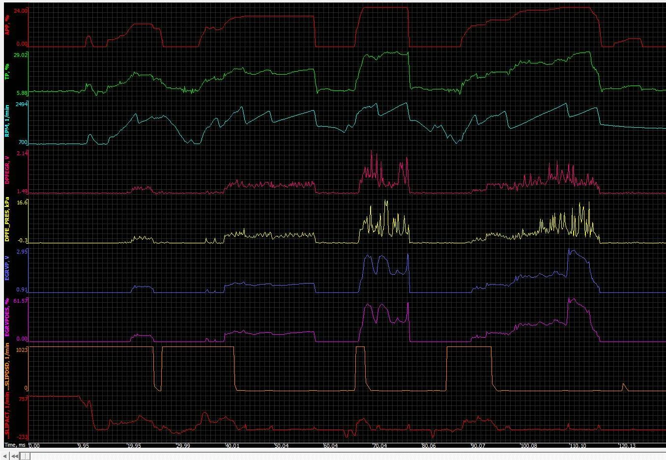

My first road test log was looking at some variables I thought might be relevant to either the EGR and/or Torque Converter hypotheses. The lower two traces are Torque Converter slip, Desired and actual. Can't say I understand what I am supposed to be seeing there.
I have no idea why the DPFE and EGR signals chatter around like that. Looks really noisy to me.
Anyway, anybody see anything worth investigating further?

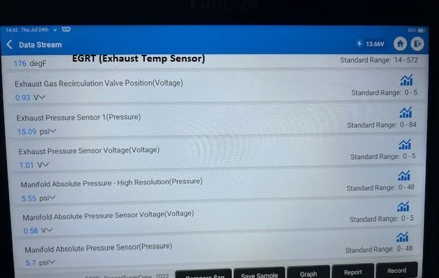

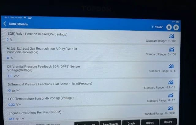

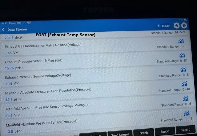

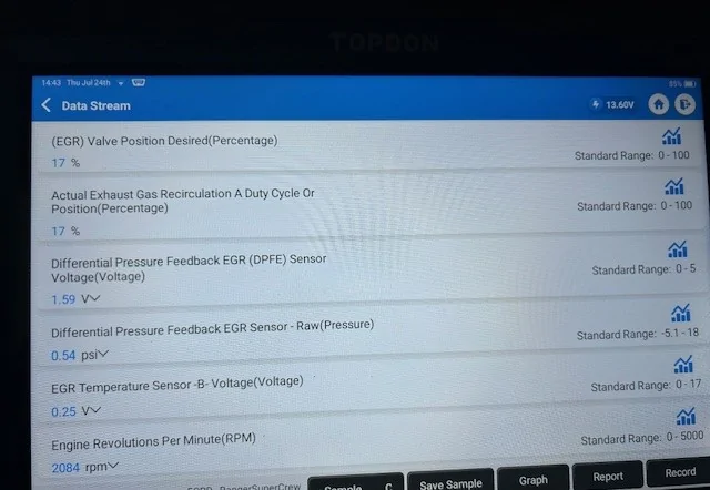

I wanted to post some screenshots of normal PID parameters that I pulled from my truck, I have no issues with Buck or Surge etc.
However note that to get these PIDs you must have a scanner capable of displaying (ALL) of them- Forscan is limited on what is loaded into the software and in previous trys with the older versions, some of these are missing
This will hopefully help those that have replaced the DPFE and still experience the Buck/Surge symptoms and give a reference to normal PID parameters.
I loaded all relevant PIDs I could think of that are related to the EGR system and took screenshots at
Idle & 2000 RPM.
This was not a drive cycle, these were taken parked, the 2,000 RPM shots were taken with truck in gear (parking brake set) and foot on the brake to load up the engine.
The most important PIDs to view are the DPFE (Pressure/Voltage) @ Idle & 2,000 RPM and the amount the EGR valve is open - most importantly is the EGR valve is closed @ Idle and only open 17% @ 2,000 RPM.
Note: slight variance of values may be noted, but you do not want to see any major difference.
The issue is example of a failed DPFE would be the EGR Valve is open to a greater percentage than 17%, this is what bogs down the engine and it cannot overcome the extra flow of exhaust.
For example @ 71% vs 17%, if the DPFE is under reading the actual flow it continues to command the EGR valve to open until it matches the commanded percentage, this is how the EGR valve can be commanded open to a greater percentage than it needs to be.
So the DPFE does not see that the EGR valve is actually opened to 71%, it sees it at a lower percentage and not enough.
I included the MAPT sensor PiDs for the simple fact that the MAPT sensor sees the increased EGR flow and the MAPT sensor also is an important sensor for Fuel / Timing Control.

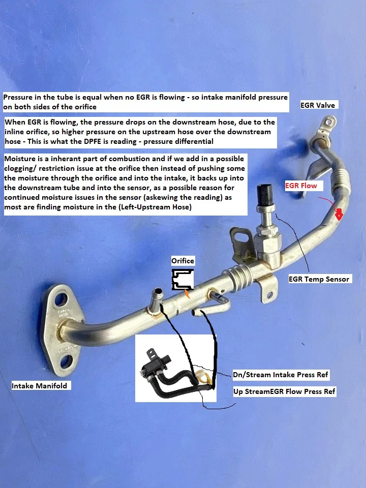

Plus to clarify:
The DPFE Sensor & Exhaust Pressure Sensor are 2 separate sensors
The DPFE is mounted next to the MAPT sensor (Left side of engine)
The Exhaust Pressure Sensor is mounted next to the EGR valve, (Right/Rear Top of engine)
The Exhaust Temp Sensor is mounted on the same EGR Tube assembly where the DPFE hoses route.
Normal EGR Related PIDs
Note: At Idle the DPFE Pressure = (-0) you want to see a (Negative (-) reading at idle
Idle - Screen 1
Idle - Screen 2
I realized that part of the top of the screen was cut off, so I edited the screenshot.
2,000 RPM Screen 1
In Gear and (engine under load)
Park Brake Set & Foot on Brake
2,000 RPM - Screen 2

Thanks for the post. I must have a later version of Forscan than you used, because I can track all the variables in your screens. The static values you posted are useful but don't give me insight into how things are working under road conditions. If you can ever post runtime traces, I would be very interested.
Sensor readings that 'appear' incorrect can result from a variety of causes. The sensor itself, the wiring between it and the PCM, problems with the A/D conversion system within the PCM, or software (maybe some other stuff, who knows).
I have other traces with the EGR valve disconnected, and the DPFE data, while not appearing to show much change in average flow (from nominal), it does still show a fair amount of noise. I don't really get that, probably time to put a real scope on it.
I have figured out I don't need to monitor both the voltage and % values for the EGRVP, since they track identically. I'll just stick with the voltage going forward. Same seems to be true for the DPFE data.

I threw this together - Operation Notes
Just something to factor in a as a possible issue for those with continued issues after the DPFE replacement.
The only way to confirm is Live Data view of the EGR PIDs and or remove and inspect the tube assembly
