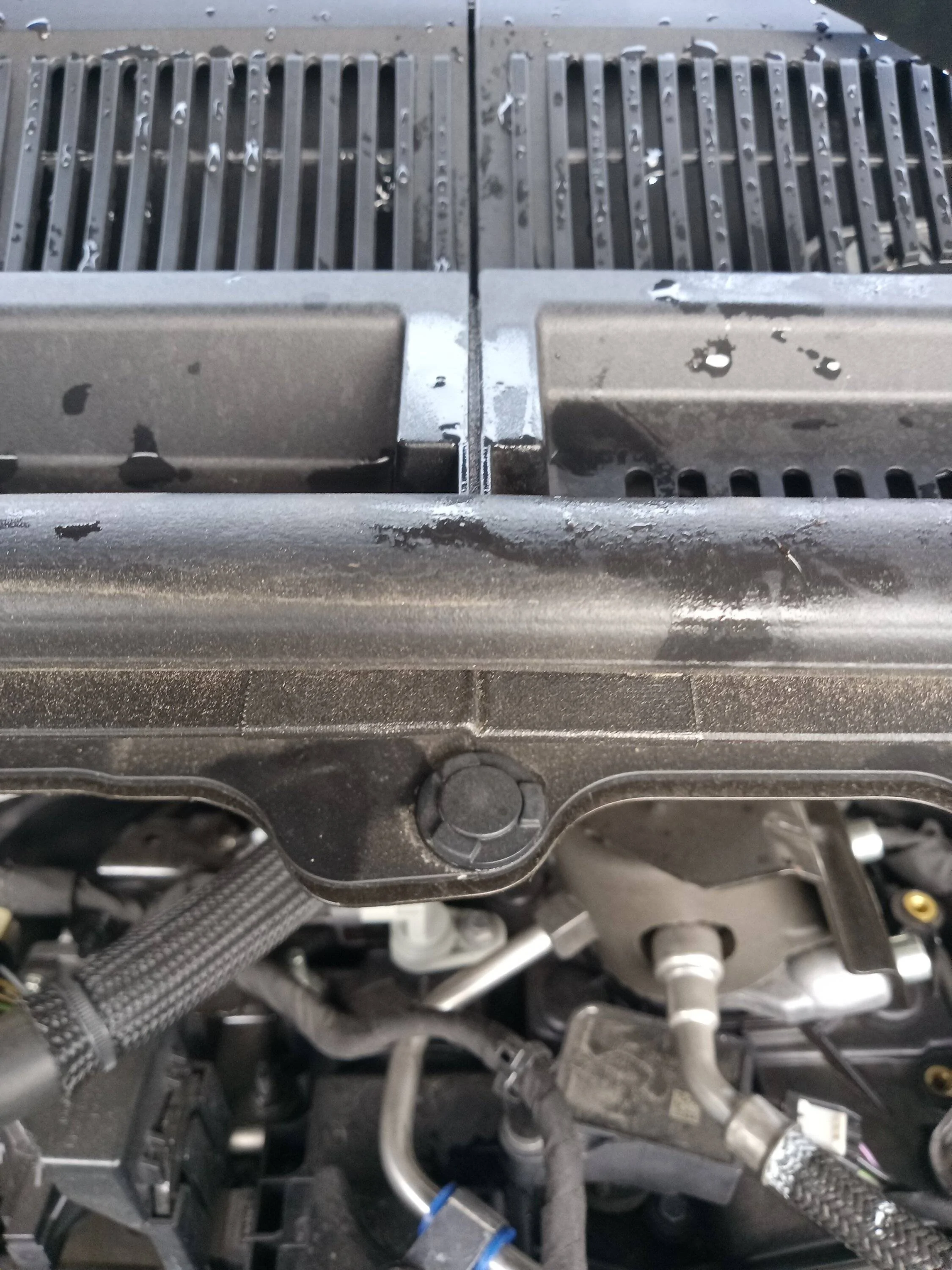

So the thinking is that the water is pooling in the vented chamber, not draining there, and then going OVER the inside raised cowl rubber strip onto the engine. And the pool floaty approach blocks it from going over. Does it actually drain from up there or is that the source problem? My level may be helping there but I do get major winter rain and snow

it does not pool per se, if you focus on the seam where the (2) plastic cowls split, it runs along that seam is one part of it.
The other is the mating surface of the plastic cowl to the metal frame of the cowl.
There is a thin gasket on that mating surface, however it really does nothing.
The rainwater will drop off the bottom of the plastic rivet that attaches the cowl, in the pic (center fwd)
So, the options are, add sealant to the mating surface, use a different gasket or use a catch type trough to reroute the rainwater away from the top of the engine.
The main thing (issue) is the split design, it runs down that split to the plastic rivet and then drips off the bottom of it to the top of the engine. Some have added sealant to the seam split
The TSB - adds the engine cover (if not installed) to help divert the rainwater, however the engine cover is a half-*** attempt to fix the actual problem, as rainwater will still drip on the edge of the cover and gravity feed its way down to the plug wells, depending on parking (nose down) position.

OK thanks, good explanation
