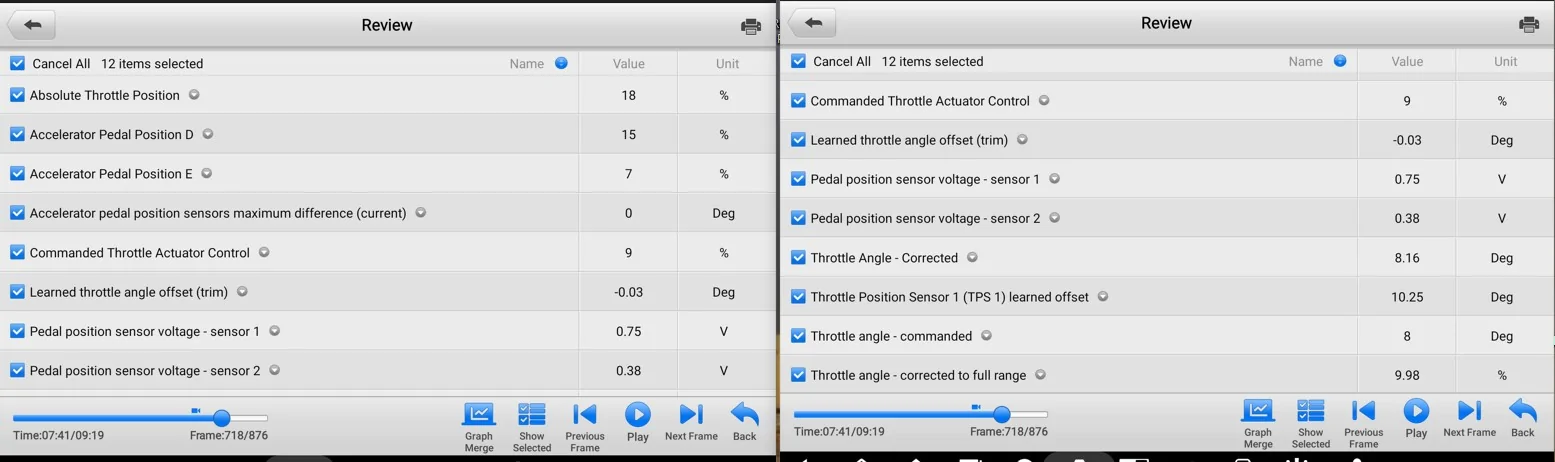

Code: P2112 refers to an issue with the Throttle Position (Input)
You may want to at least look at these PIDs to see if you see any dropouts.
Note: there are a number of PIDs related to these that provide - True/False, relating to error or mismatch of data.
I wanted to keep it somewhat simple as any fault (error) will be seen by these PIDs as that is where they will be picking it up.
I recommend checking these - for SAFETY especially if you had a 2500 RPM throttle bump at idle, Uncontrolled after start.
YES - The system should enter LIMP Mode as it did and if it fails again hopefully it will do the same.
Not trying to scare you - just a recommendation for safety reasons as you are trusting the PCM to follow its set commanded programmed procedure for TPS & AP (Mismatch Correlation) to revert to LIMP Mode.
Ironically, the TPS PIDs was part of my building a Ref: Database to have on file of what is normal to see - This was done yesterday:
Note: This is the KOEO (Key On Engine Off) Test
KOEO @ Rest

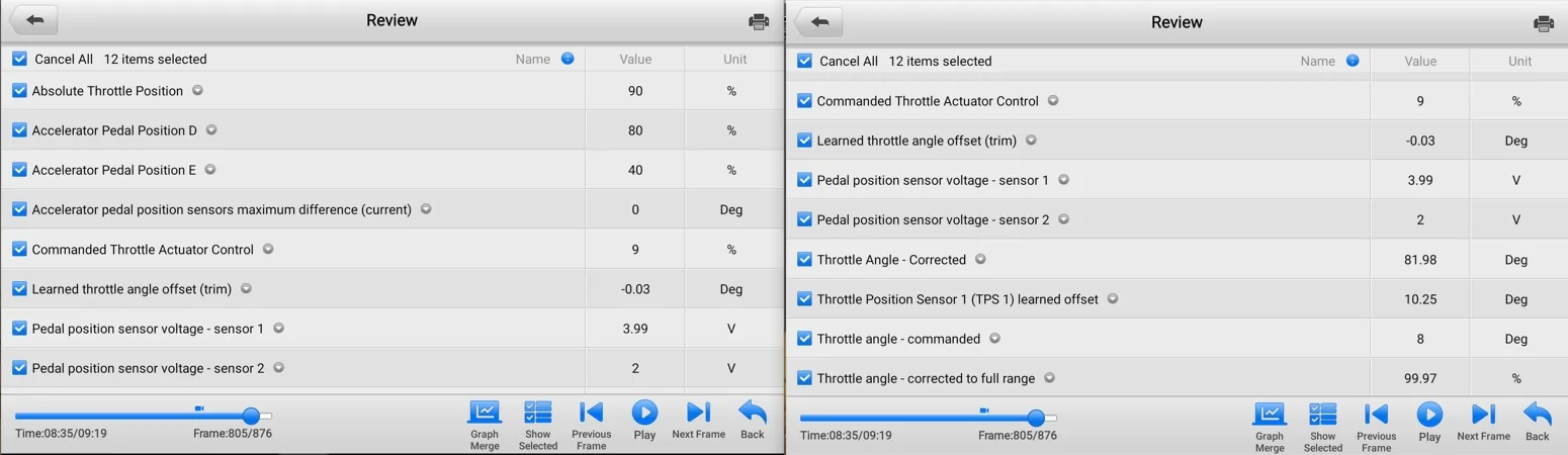

KOEO - Full Throttle
Ref: PIDs should change without any dropouts and slowly move along with slow movement of the Accelerator Pedal to (FULL THROTTLE) Pedal on the floor
KOEO - Full Throttle.
