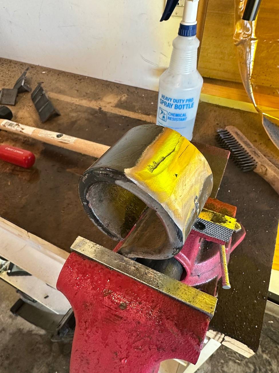

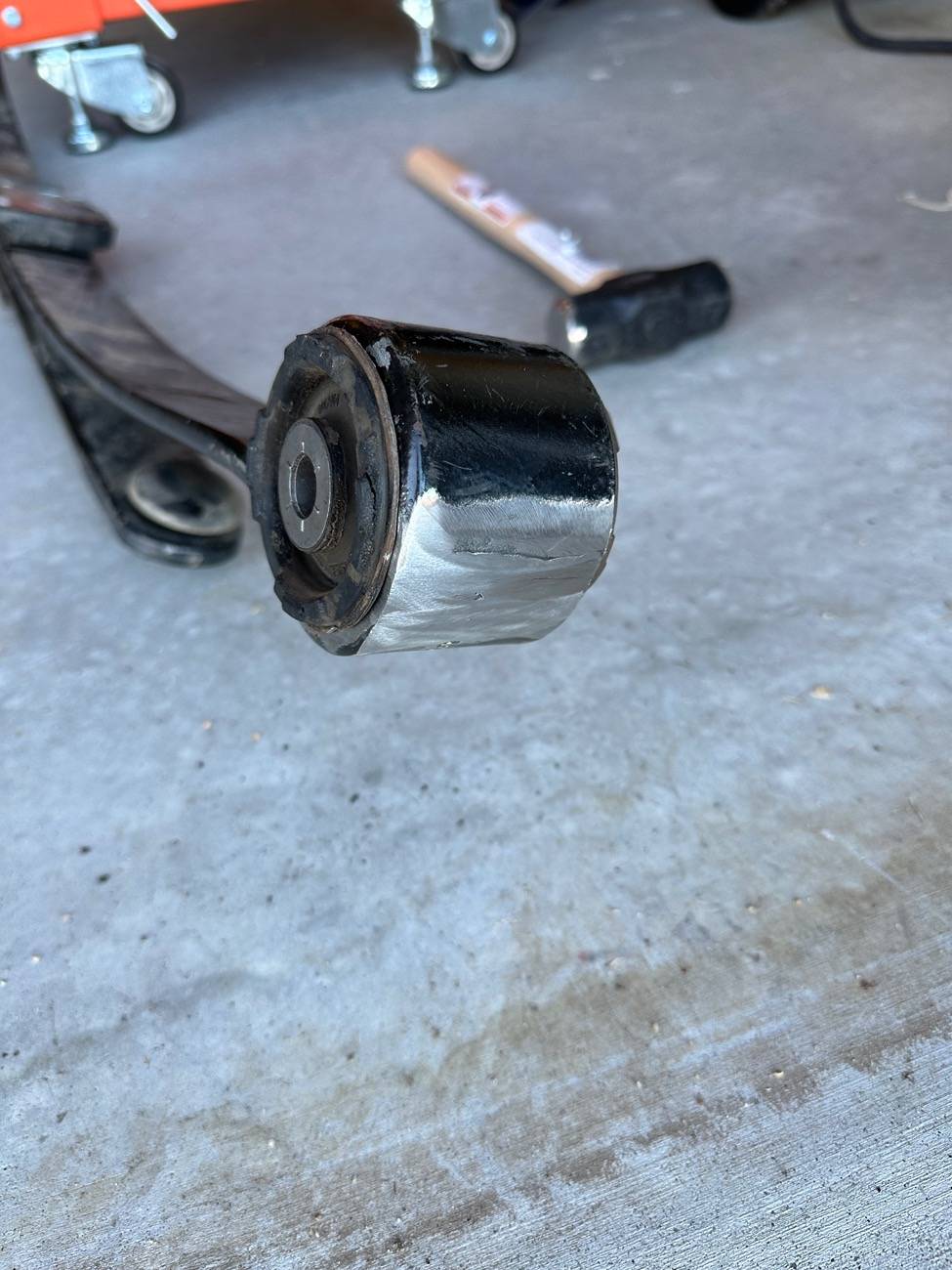

Well! I did it! Tons of grinding to open up and clean the crack, and 10+ beads of ER70S-6 and cleaned it up. Drove for a dozen miles tonight and it’s holding.

That is impressive welding work! Did you check the leaf spring on the other side of the truck? You should be able to get a finger up around the knuckle and feel for a break.
I checked the drivers side and it’s fine for now. Just drove 3 hours back to Denver with a truck full of family and gear and the weld held up great! Even hitting a pothole unexpectedly!

Great job on that weld, Joe. I weld like pigeon sh-t so it would have been beyond my capabilities.
If you look at one of the pics, you can see my test welds in the background trying to re-learn a lot in a short period of time :)

Leaf is still holding up close to 3 weeks later... getting the replacement spring has been... taking for ever.. and is still a week out. Some of this is due to 2 holidays happening around the time I ordered the replacement, some winter storms, but also it seems just general slowness on everyone involved on getting the parts shipped. Now the Tremor springs are sitting at UPS not moving... so still TBD. Hoping to get this all closed out by end of next weekend.
In the end if I had to do it again knowing getting factory parts like this could take close to a month to get delivered... I may have just gone with some Icon multi leaf springs that would have been here in ~ 5 days.
Good thing the weld is holding, or I'd be SOL on a car right now. Close to 500 mi on the spring. I am driving it very gently though.

Well, Its over! The welded spring held up for close to 700 miles and I got my Tremor springs in hand and installed!
The weld looked just as good as it did the day I put the spring back on the truck!

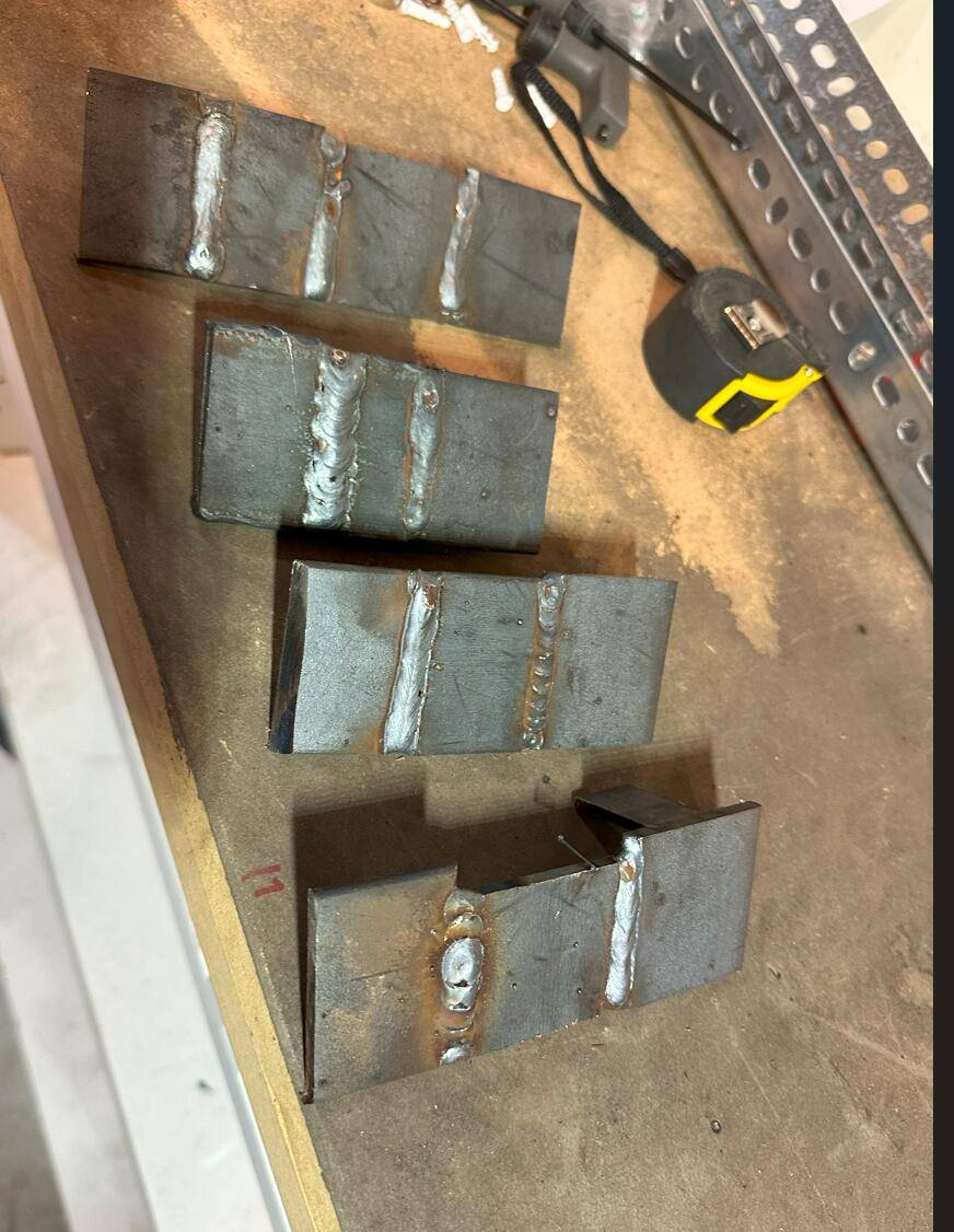

Also, pics of my test welds - the first real welds I've done since I was in High School almost 30 years ago. A few different techniques used there to see what was working and what was not.
