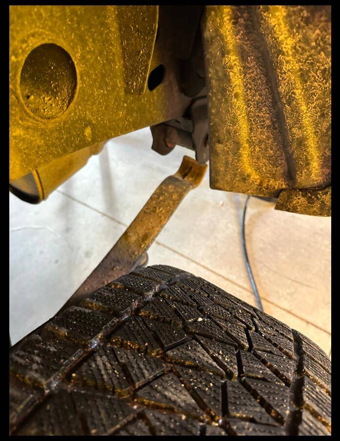

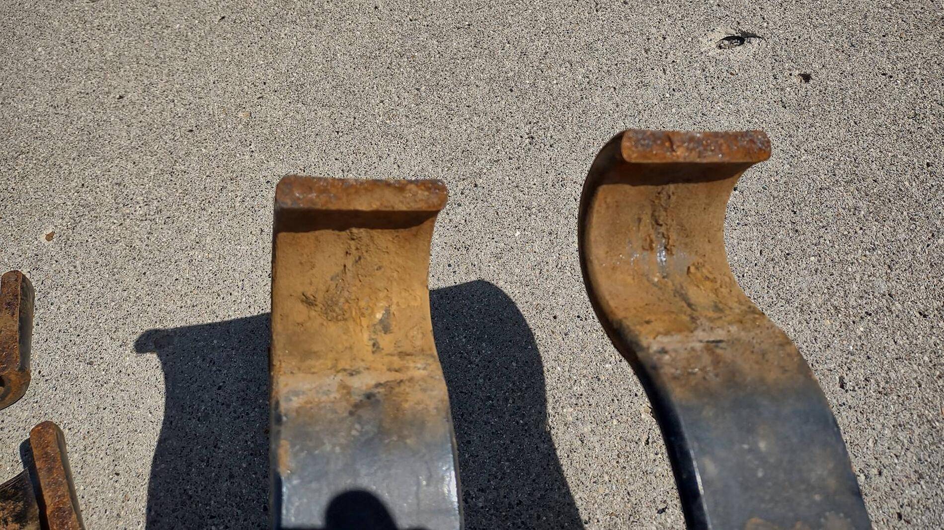

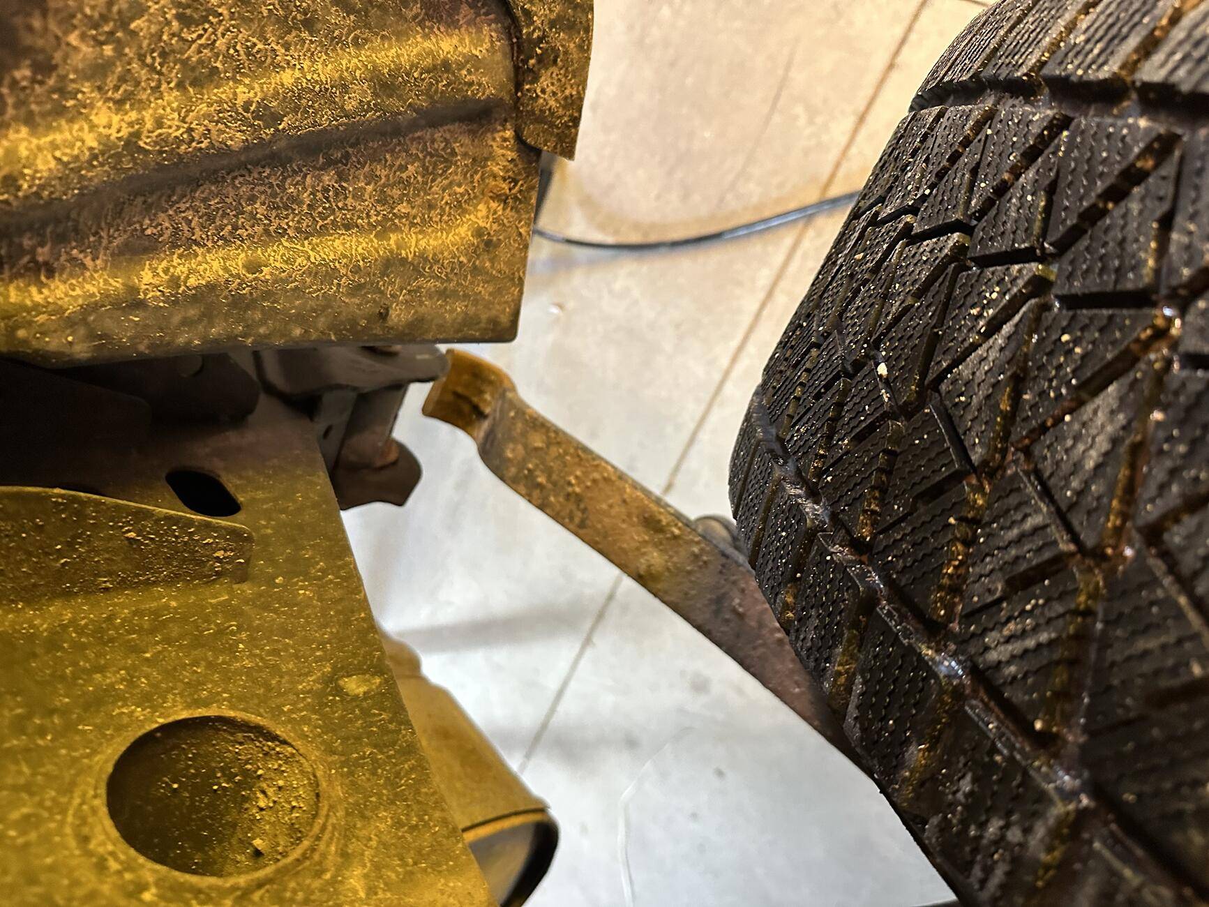

Well, Its over! The welded spring held up for close to 700 miles and I got my Tremor springs in hand and installed!
The weld looked just as good as it did the day I put the spring back on the truck!
