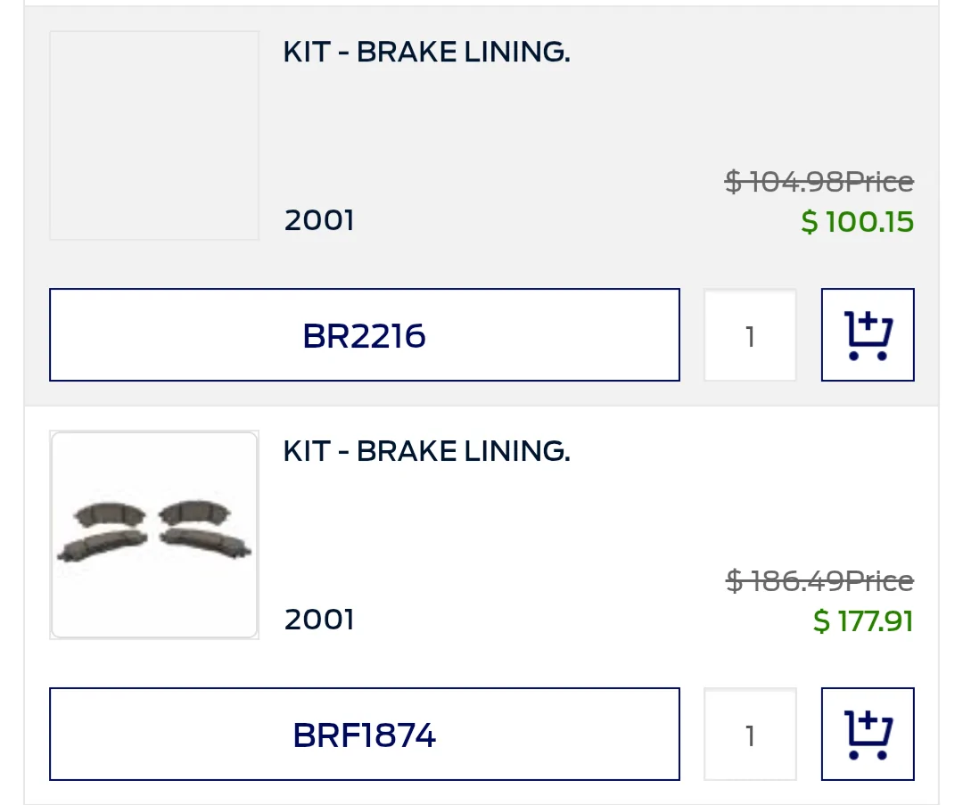

2. I went on Ford's website to order a new set of front brakes and there were 2 different sets available: BR2216 and BRF1874. I thought maybe the F stands for front, but they are both under the front brakes section and both have the same number from the parts diagram of "2001". What is the difference in these 2 sets?

Check min rotor thickness and then measure your rotors. I am a big fan of full swaps too. However I did my wifes car at 75k and just did pads. I guess I have been pissing money away for years.
those 2 part numbers appear to be the same, one might just be an updated part. I am a big fan of the power stop carbon fiber ceramic pads. They bed in amazing with the break in procedure and create zero dust. Really good initial bite too. Just a thought.

BRF1874 is the Original Equipment (OE) Spec kit. It is identical to the exact brake pads your truck had when it rolled off the assembly line.
BR2216 is the Retail/Value Spec kit. It is Ford's budget-friendly alternative line designed for standard aftermarket maintenance.
