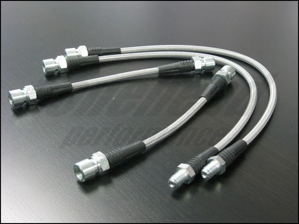

I come from performance car world so I'm not quite getting this problem since I drive the Ranger like a truck...ie, zero late braking...but the first fix to remove soft pedal would be to replace the rubber with braided SS brake lines like these?
My guess is that no one makes them for the new Ranger...for the reason that few people attempt to track their trucks...but you never know...Maybe Dr. Phil can chime in since he actually did...:)

That only goes so far with the pedal feel.

I stopped using SS lines on my production race car(s). I’m convinced that any difference in pedal feel is either due to replacing the fluid with a fresh bleed, the previous lines were shot, if some other worn component in the system was also replaced (like pads). A lot more flex is taking place in the OEM floating calipers and if any longitudinal or lateral pad tapering has occurred (inevitable wear characteristic of floating calipers) that will very noticeably increase pedal stroke.
Ive had an entirely new braking system. MC, calipers, pads, rotors, and SS lines - swapped back to new oem lines and there was ZERO difference in the paddock and in race conditions. Also did the same in reverse where I swapped to SS lines with not detectable difference. Finally, I’ve had more SS lines fail on me than rubber and was very lucky it happened with a lot of runoff in front of me.
