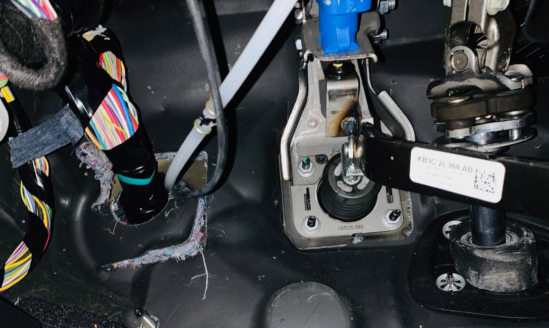

I installed it inline with the boost pressure line inside the cab after it comes through the firewall. It basically eliminates any vacuum pressure fluctuations you can have from the manifold.

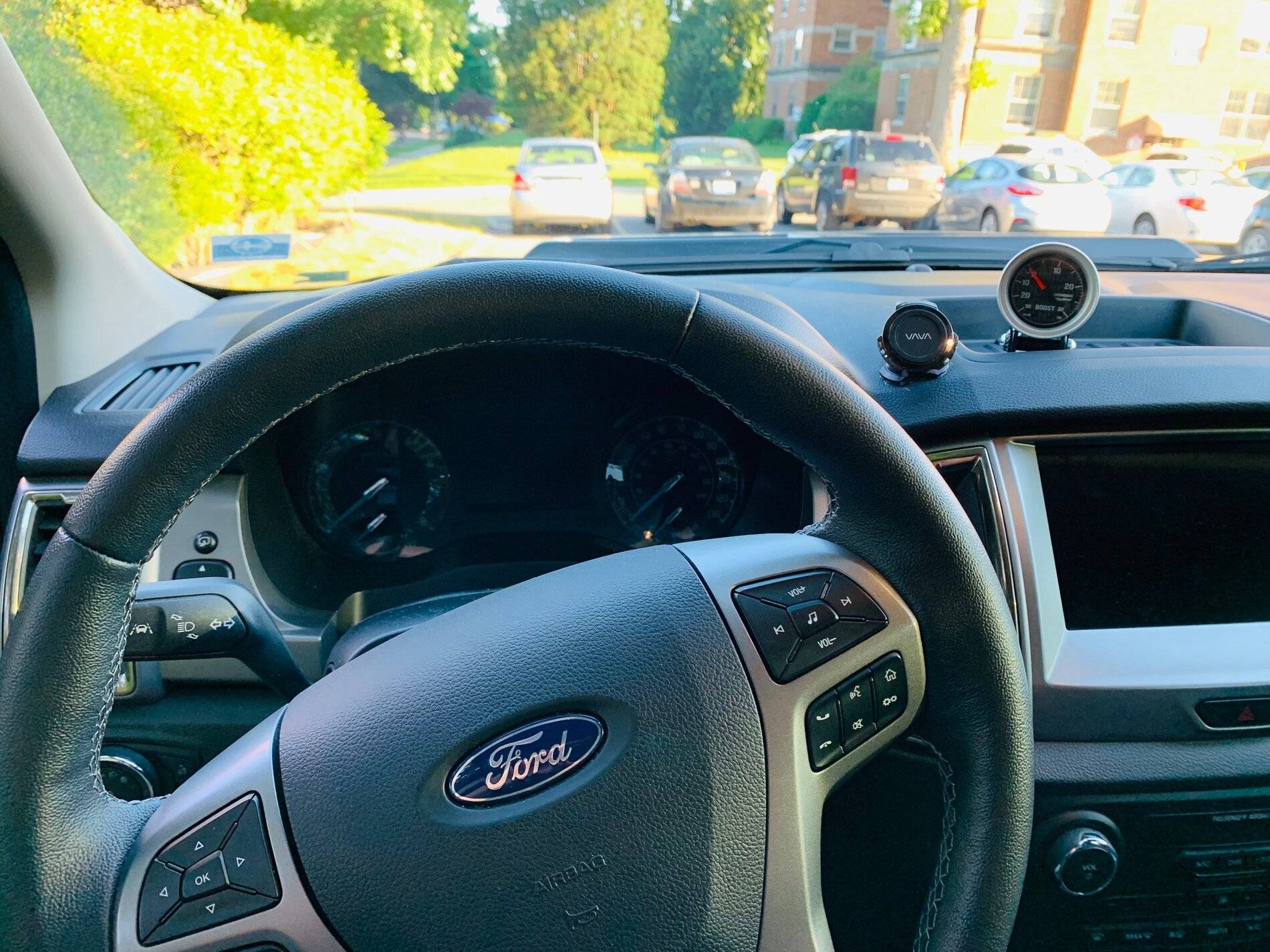

Well, I got my gauge in (still tweaking the dash tray mount, so will post pics later) and everything seems fine, but I am experiencing vacuum fluttering using a ~$75 Autometer gauge. I may snag a restriction fitting at some point, but will probably leave this as is for a bit.

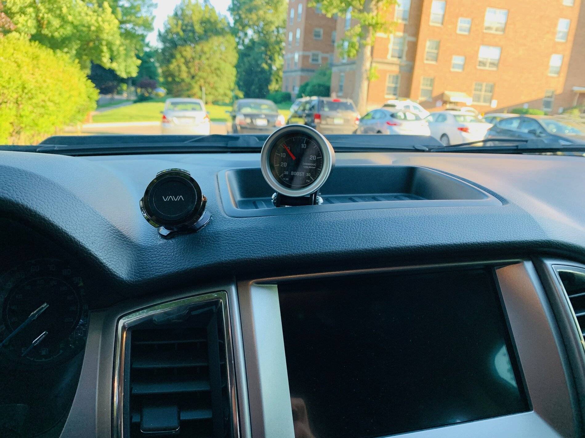

Cleaned up my dash tray install yesterday. Rerouted the tube a bit to hide it and drilled out a new hole in a spare tray I ordered from Levittown. Overall pretty happy with the look of it and I retained a decent amount of tray space with the new placement.
I also installed the pressure restrictor that ISUACE recommended (visible in the 3rd image, sorry for quality). I still get slight needle vibrations at times, but it is better. The noise on the other hand, I did not expect. This thing sounds like there is a BOV down by my brake pedal when the turbo is spooling. I might relocate it to the engine bay if it gets annoying.

Nice job... I haven't heard any noises with my restrictor. How loud is yours?
Seriously? Mine makes a very loud hissing with any boost, so basically any time you are accelerating on the freeway I hear a quite loud hiss. I tried to record it with my phone, but didn't get great results. I am thinking about just removing it and dealing with the needle vibrations. Curious as to why yours does not make noise. You said you installed it within the cab, right?
I'd check for leaks... mines totally silent...

I just took the thing out. I do not believe there were any leaks, as I could put my finger over the small pinhole outlet on the restrictor and could mute the hiss by covering it. I also used the same clamps in other places on the install and reused the ones that were used on the restrictor. All is quiet now, just with small needle vibrations. I'm just going to keep it this way, works fine.

As I said before, it is difficult to get the connections made due to the location of the "nipple" on the intake manifold. That part took me about 10 minutes, and about 3 minor cuts! The hard part was fishing the tubing down through the heater ducting. I had to take out the top-of-dash tray, after which it went the first time. I mounted my gauge in the tray.
If you use nylon 1/4" OD tubing, and a "PLASTIC" wire fish tape (available from Home Disappointment), fish the tubing above and to the left the hood release cable as seen from the inside of the cabin. With a little effort, you can then pull the tubing by simply pushing it over the ferrel on the fish tape, and pull from the engine side. Took me about 20 minutes total.
