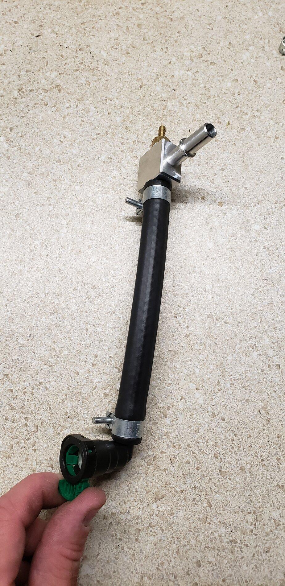

Thanks for the confirmation! I also ordered the same cp-e Ford EcoBoost 2.3 MAP Intake Manifold Pressure Reference MAPtap... hopefully things go smoothly...

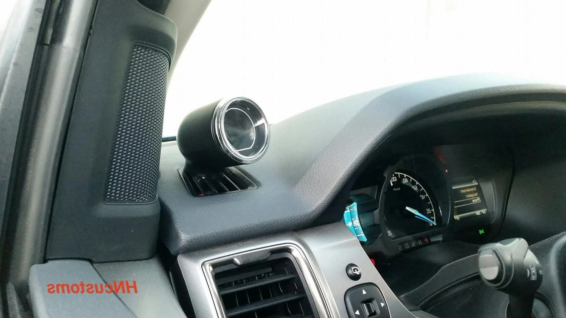

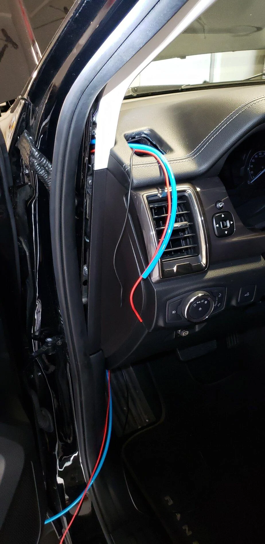

I am going to try and mount it near the A-Pillar using the small defog vent on the dash. Australian Rangers have a vent with a gauge mount built into it... I'm going to try and use this and see if I can get close...
https://www.amazon.com/gp/product/B0018ALWOE/ref=ppx_od_dt_b_asin_title_s00?ie=UTF8&psc=1
But having these in the US market would be awesome...
Update.. I talked to HNcustoms down in Australia... they said they could make this vent gauge pod for LH drive Rangers! Its a bit pricey at $125 AU.

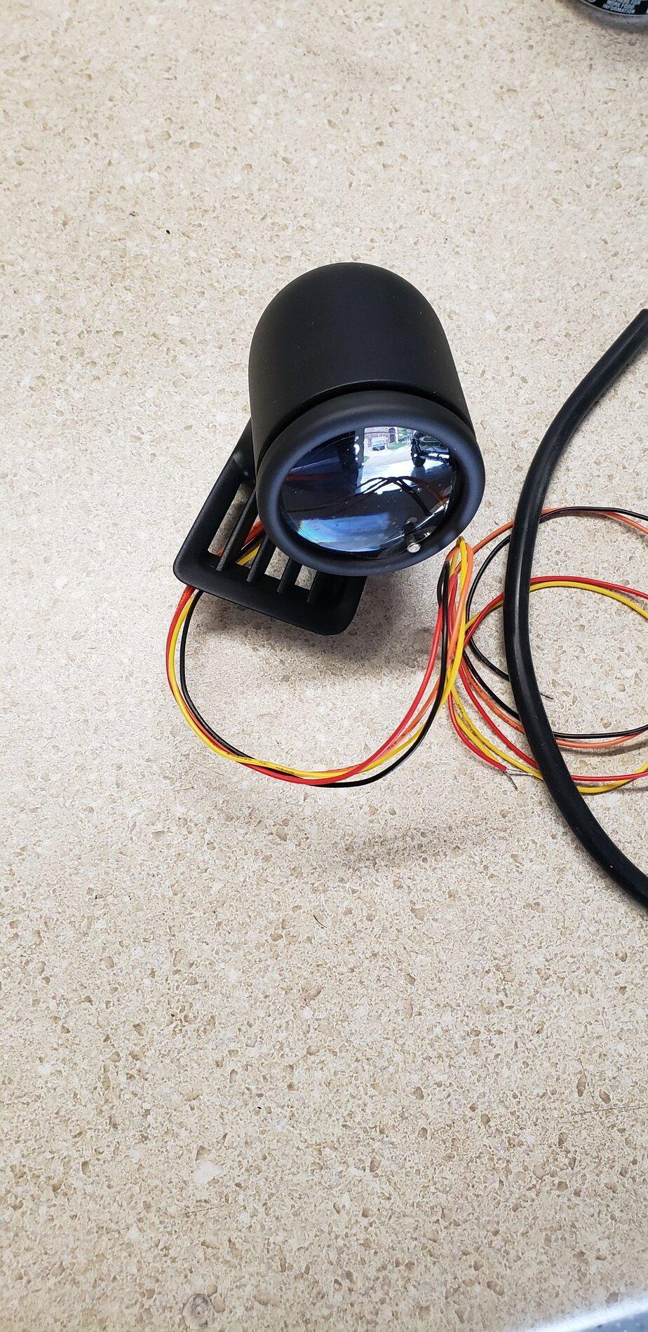

So update... HN Customs in Australia is shipping the US LH drivers vent pod... its $114 USD. I'll get pics for you all once I get it.

Let's see how this goes...

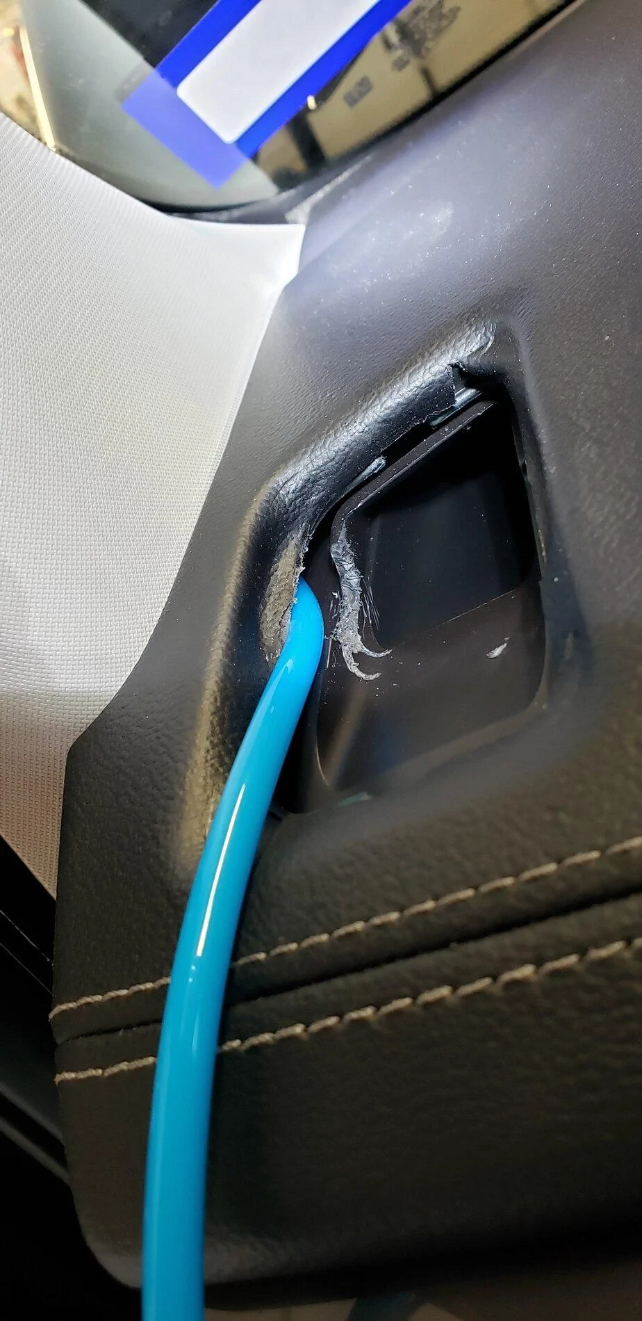

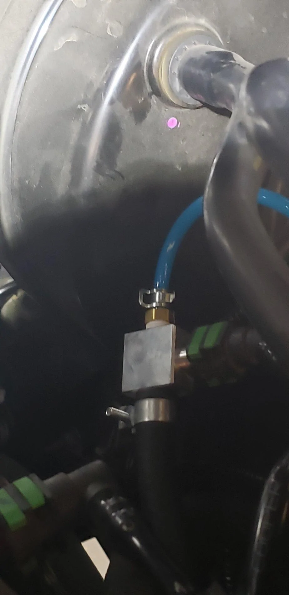

And for the record this was not a 20 minute job. Getting the boost line through the rubber firewall grommet sucked. Also... you have to grind down/cut out a bit on the LH side of the vent itself to get clearance for the wires/tubing so they don't get crimped. Disregard my haxor job with the Dremel. You don't see it anyway once the ventpod is back in place though.

Yes it does. I thought I mentioned the best way, but using a nylon wire puller is the best way. I got mine at Hime Disappointment.

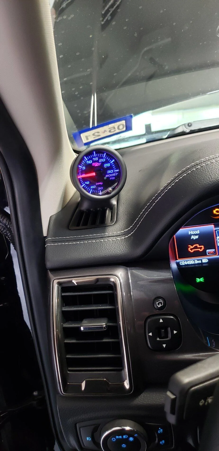

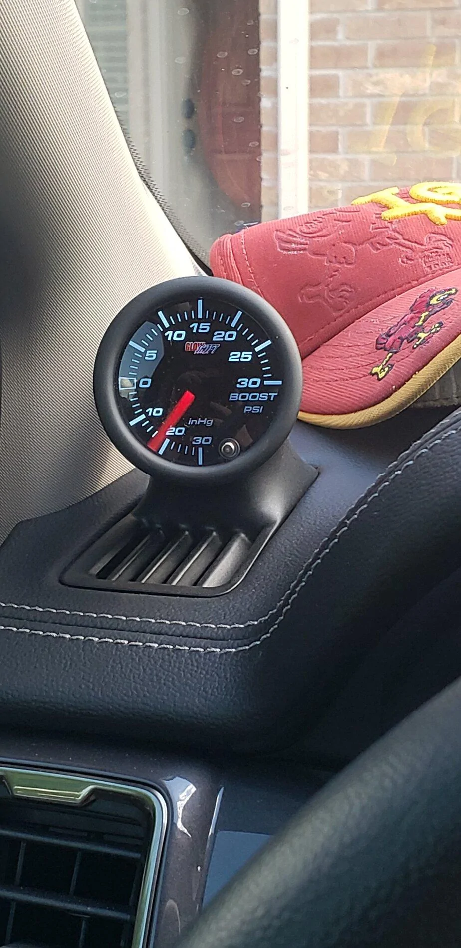

So got it done... shows vacuum at idle.. gets up to almost 20psi at full throttle. Also has a slight flickering under vacuum. Other than that trying to decide what color to go with! Might stick with white or turn it back to blue..
