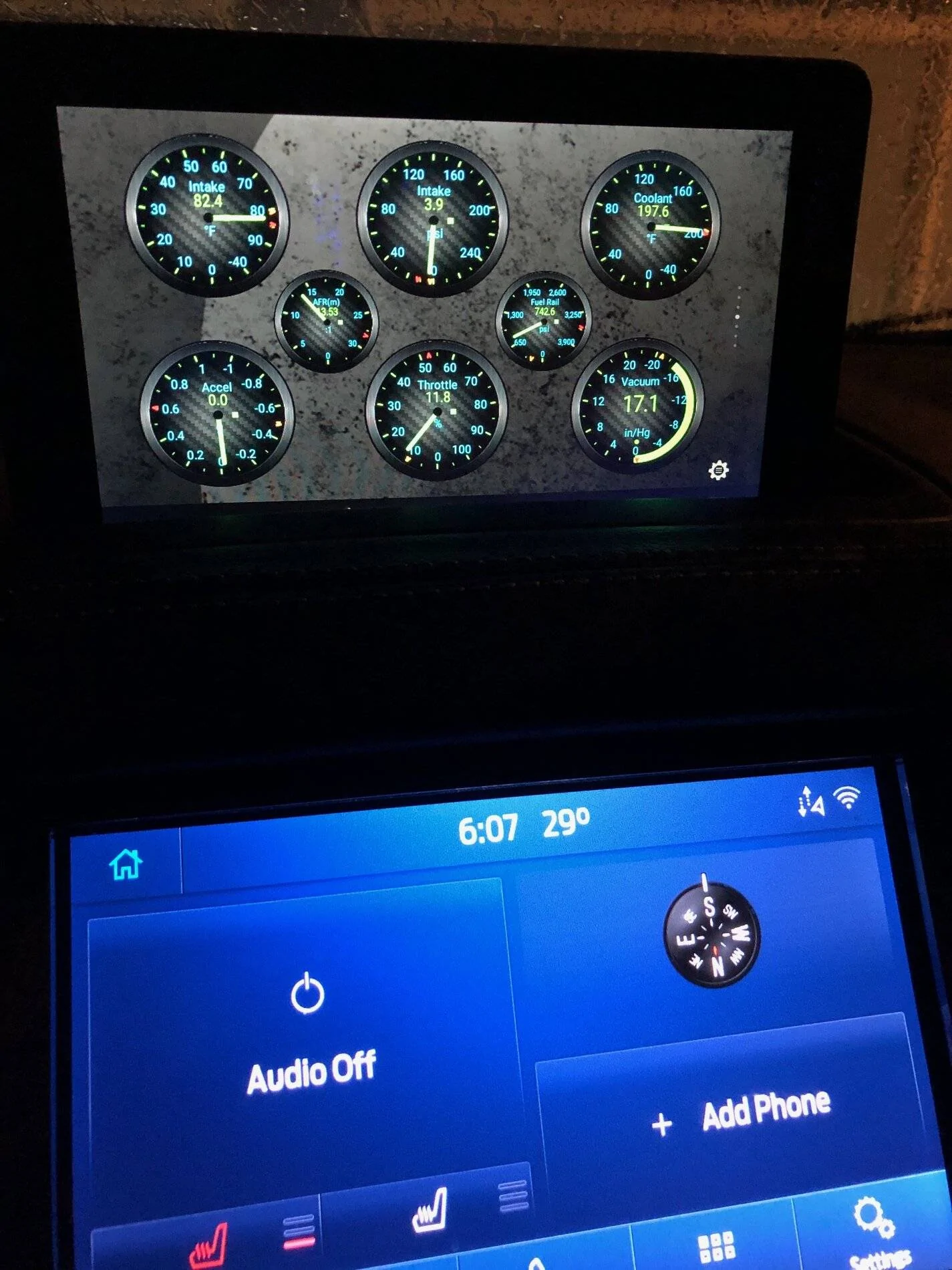

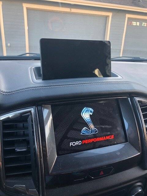

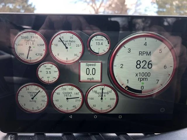

If you have or buy a cheap android tablet it would be MUCH easier to install a wireless OBDII device ($20 and plugs into your OBDII port) and download Torque Pro ($5) to the tablet. Then you can have your boost gauge and many other gauges that we have sensors for in our Ranger engines. Sadly oil pressure and oil temp are not available (we don't have sensors...go figure :frown:). Probably the 2 most important gauges if you want to watch what's going on in that 2.3L beast. There are many posts on here about setting up Torque Pro...just do some searching in this forum if you are interested.

^^^ Good, humorous video on how turbos work for you.
And I agree with the tablet/obd Bluetooth idea. I had one in my 6.0l and it worked great.
