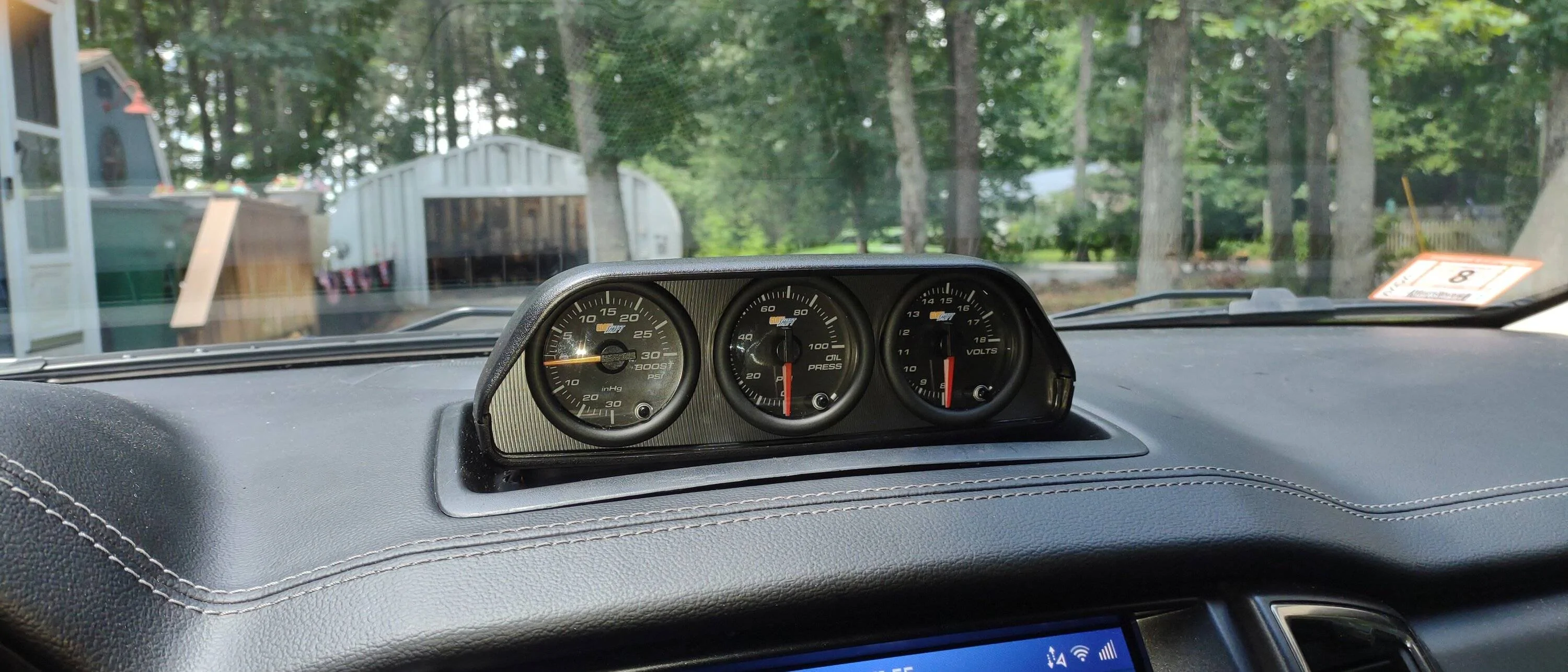

I finally got my gauge pod installed on the top of my dash where the upfitter switches were and noticed an unusual behavior of the boost/vacuum gauge when on the vacuum side. Looking to see if others have the same phenomenon happening.
When cruising at a speed that has the throttle open enough for manifold vacuum to be in the 0 to 10"Hg range the gauge needle is very steady. But when I slow down and the throttle is barely open with manifold vacuum in the 10 to 20"Hg range the needle oscillates rapidly about 1 to 2"Hg. If I remove my foot completely from the throttle and coast the manifold vacuum will go to 20 to 24"Hg and be steady.
I suspect what is happening is a very small throttle openings the ECU cycles the throttle open and closed rapidly to maintain speed which changes the manifold vacuum and is being measured by the gauge. Just wanting to know if others with a boost gauge are seeing the same thing.
Other than being a distraction I am concerned if this is not normal what impact will it have on the long term reliability of the throttle body and boost/vacuum gauge. I can fix the gauge by putting a capacity tank in the line (already a very small size restrictor in the gauge fitting).
Look forward to comments. ?

I like the gauge cluster. What are gauges? Where did you get it? Cost?
The gauges are Glowshift 7 color black series gauges. The volt and vacuum/boost were approximately $50 each and the oil pressure was $90 (comes with the sensor and weather pak harness). Also had to buy from Glowshift an oil filter sandwich adapter ($30) for a place to install the sensor. The gauge pod was from Autometer and was $100. Also needed a tee block in order to tap into the manifold with out cutting any factory lines ($30).
I normally buy Autometer gauges but wanted something that integrated with the interior and the Glowshift gauges are LED back lit and have 7 color choices and seemed to fit my needs the best.
The Autometer gauge pod has a pedalstil on the bottom that is about 3/4" thick. It made for a simple mount to the bottom of the dash tray and aced the gauges just above the surface of the dash.
