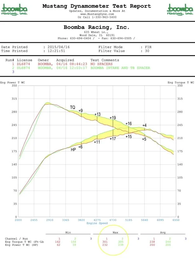

I know it's a big ask but a before/after dyno or 0-60 type test might impress us.
it was already posted, on the first page
edit: my bad, not the same motor

Those TQ and HP numbers make me think this is a 2.0 dyno and not a 2.3.
The Dyno Charts are indeed from a 2.0 not a 2.3 Ecoboost.
Might as well delete that and upload one of your spacer on a 2.3, showing that one is edging in on being misleading.

Here’s the dyno for a stock 2016 EB Mustang with the TB spacer and intake manifold spacer. Dyno numbers look correct for a stock 2.3L EB too given that is a Mustang Dyno which is 12% lower than a Dynojet.
Looks like it allows peak hp to be achieved and maintained 1k earlier in the powerband, which is impressive. Ok @Boomba Racing when you have a TB and Manifold spacer combo ready to go like you do for other vehicles, I give you permission to take my money…
