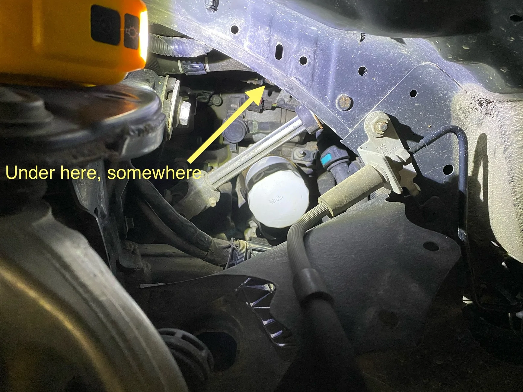

Ah, the simplicity of drawings. They do make it look a lot easier than it will be.
If you do your own oil changes, take a look in there next time. It’s in there about a foot deep and airline tech is right about the starter being an obstacle. The steel wheel well arch is also a bit of a challenge.
Even if you’re simply curious, retract that splash shield and have a look. Yikes!

Yes, I do my own oil changes. It's not unfamiliar territory. 😉 I MIGHT be able to plug it with a cap. What I need is the right tool.

If you’re thinking you can cap the block heater without removing it take a look at the images of it and the cord/plug. The red rubber portion of the cord plugs into the block heater. Then the nut is tightened to squish the red rubber to seal into the block heater. So it’s already plugged and will not leak antifreeze out or let water in. If you’re thinking of removing the block heater then you have to drain the coolant and remove the heater. Then you could use a pipe plug with the same thread to plug the hole left by removing the block heater.
