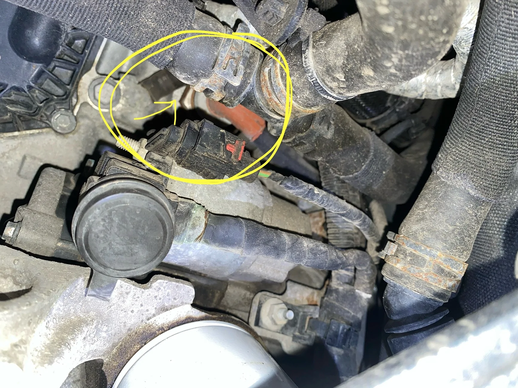

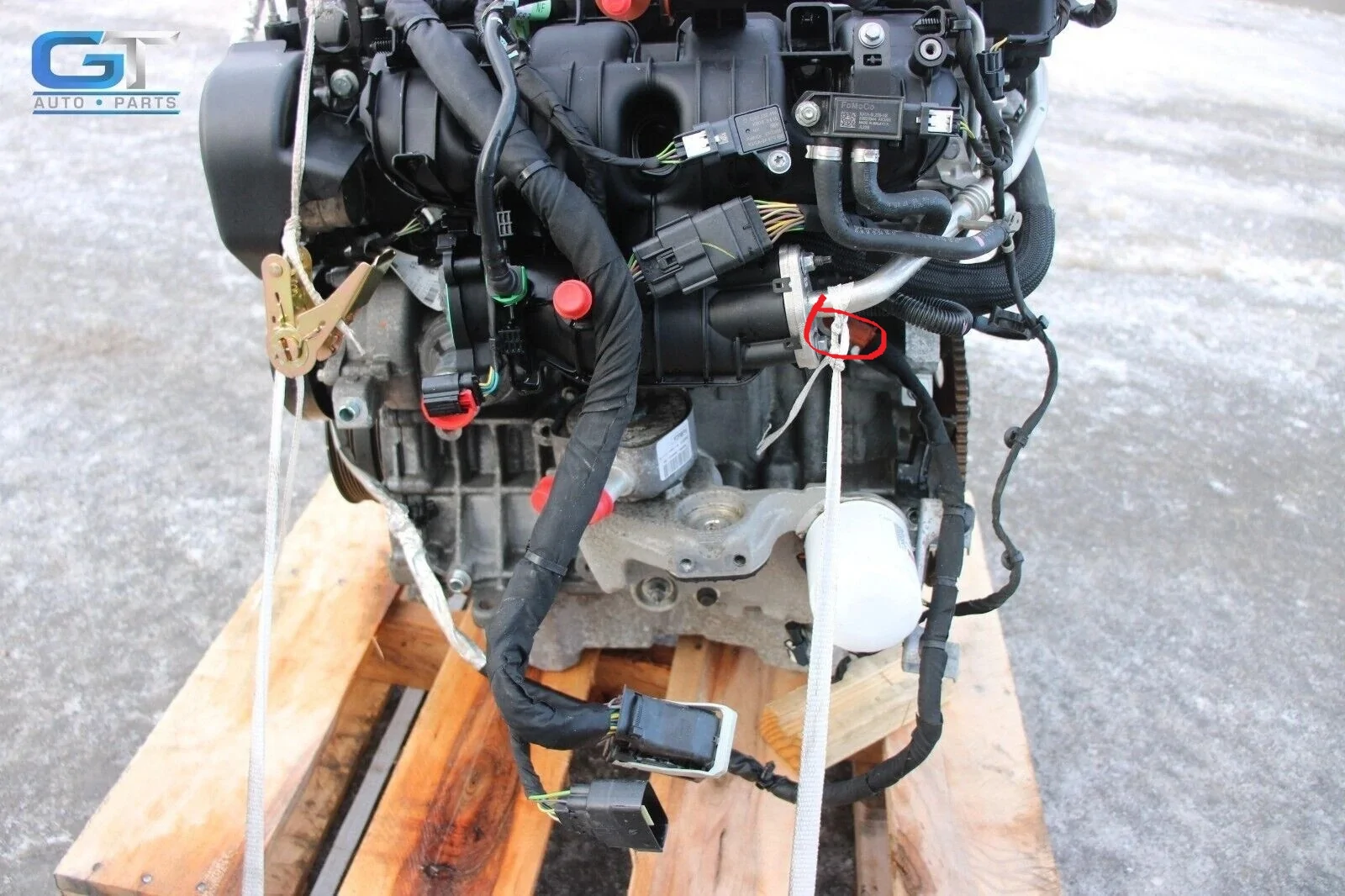

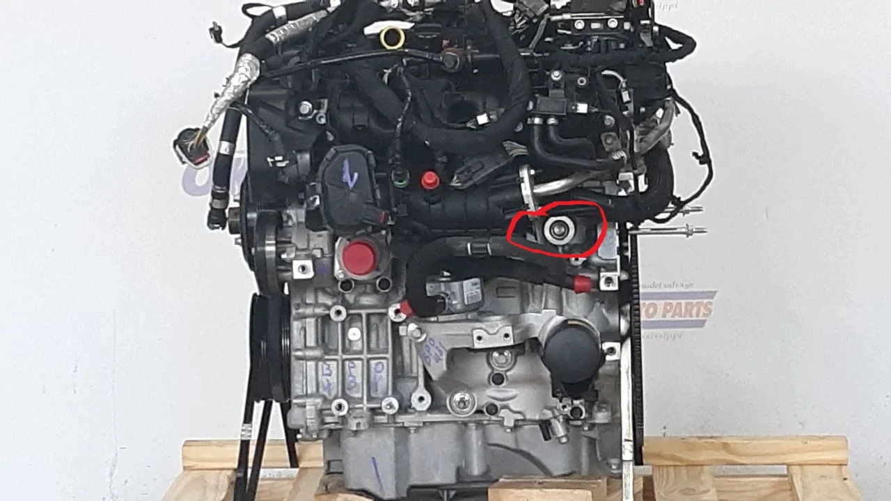

I think this is where it mounts
Hard to find one on Ebay with it actually installed even Ebay.Ca
I think its mounted at the (Red Arrow) behind the coolant hoses and you can just see a glimpse of the boss.
So, if I am correct, it can be done without pulling the intake, however limited access.
I can see why the early versions of the manuals, called out to remove the intake, only for easier access (Does not appear to be required)
I will add that the manuals do not call for it - BUT you could pull the starter for more access, much simpler than pulling the intake (IF NEEDED)

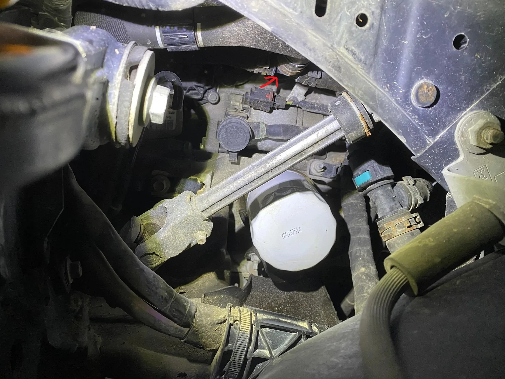

Gotcha, so if you mean this…..
…..then, it’s really in there deep! A tough thing to get at, that’s for sure.
Yes - that's it

Wow - I’m sure the next time you change your oil filter, you’ll have a look in there and see how well-hidden it is. Seems like a very expensive recall for such a small item but a fire below the brake fluid reservoir is a dangerous thing.
