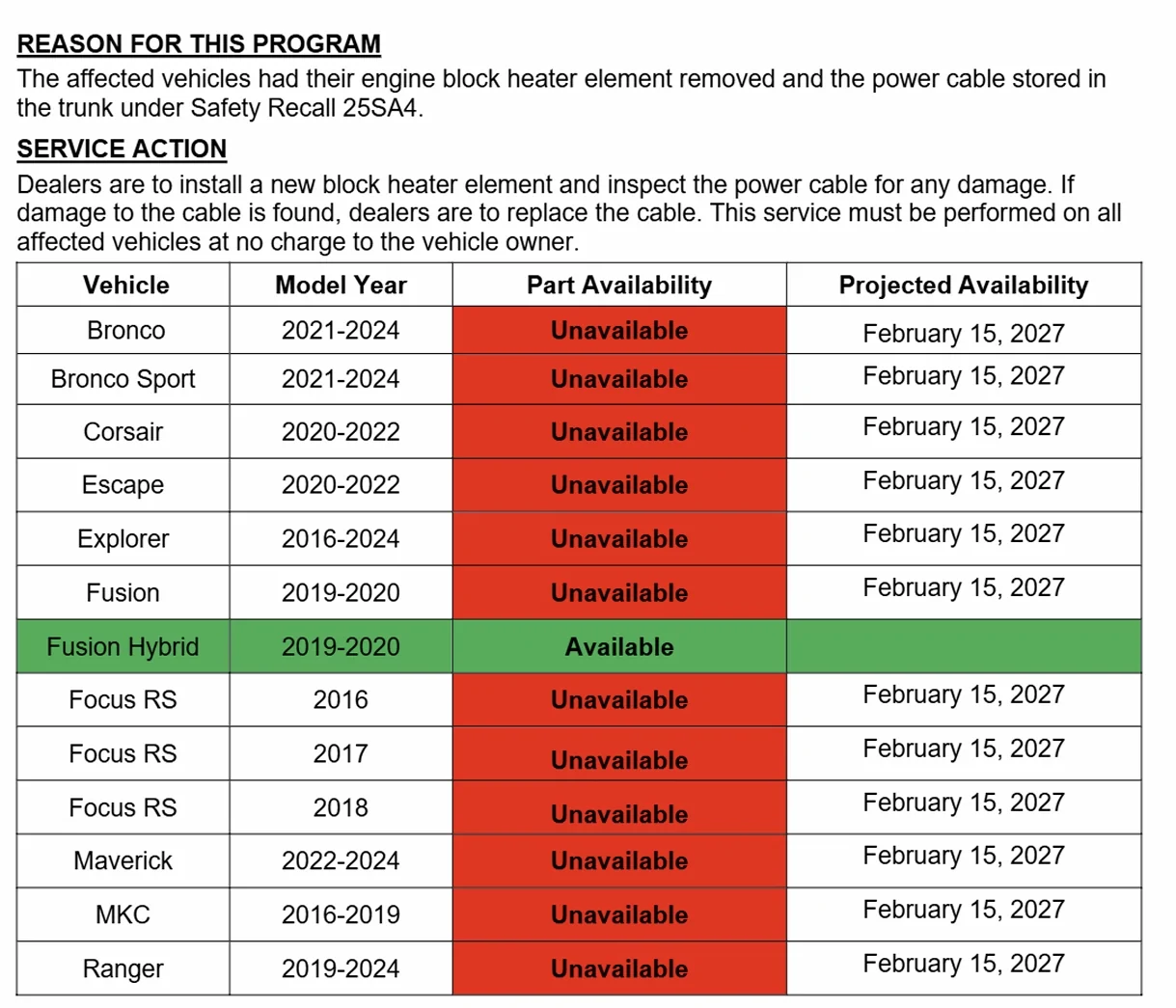

Update: Latest revision - posted:
The heater is available for the 2019-2020 Fusion (ONLY)
Projected date - parts availability for all others including the Ranger - Feb 15 2027

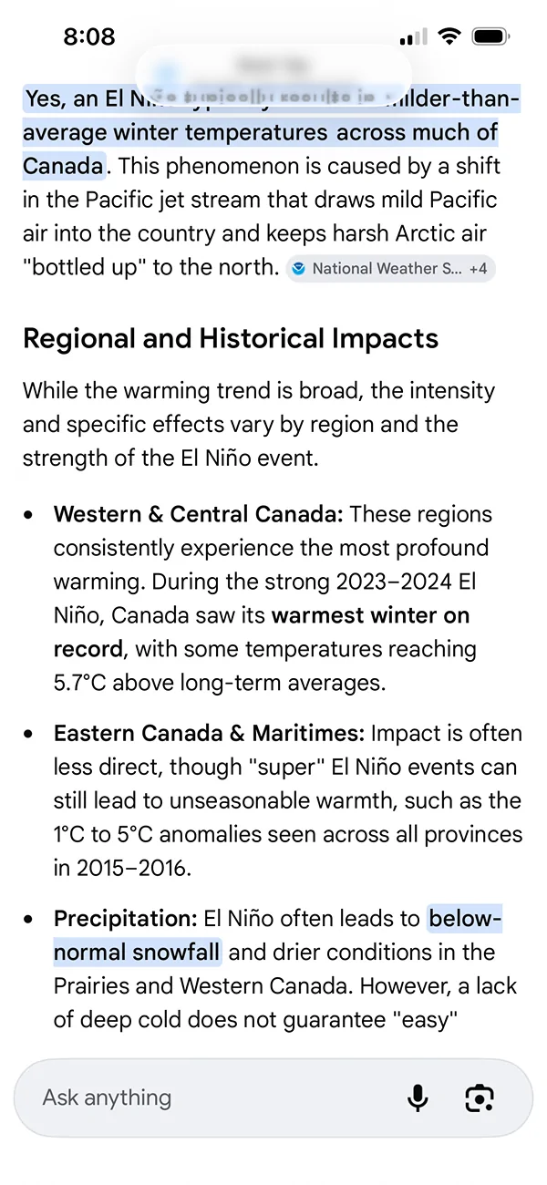

Well we’re supposed to have a super El Nino this year so that should help with the wait
