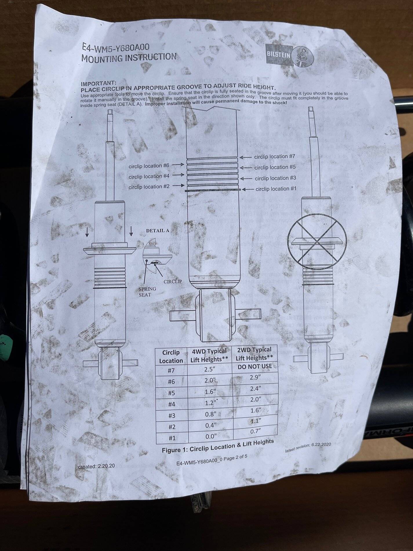

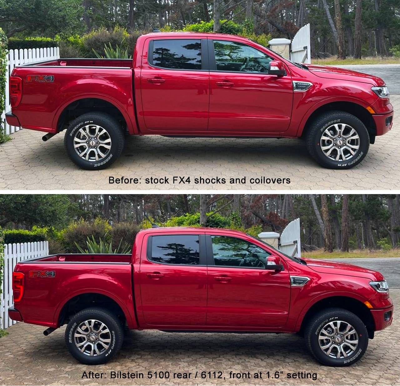

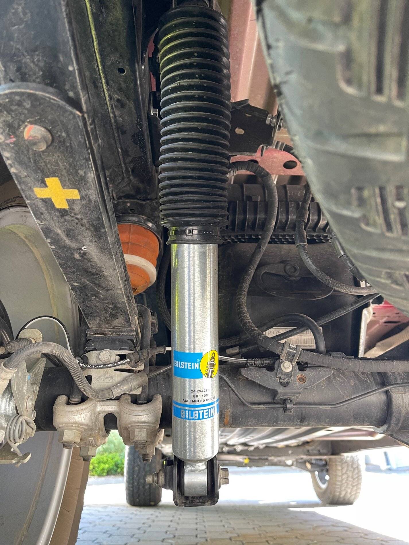

I installed Bilstein 5100 shocks on the rear of my new FX4 and put the 6112 kit on the front, set at the 1.6" ring. I still have about 3/4 inch of rake from front to back - I didn't want it it to be completely level and I liked how this looked on some other trucks on this forum.
I'm happy with how it came out, and it rides dramatically better than stock. The 1972 Cadillac ride is gone, and it is firm without being rough. I drove my previous 2020 4x4 for a few months with the 5100's on the back and stock in the front, and that made a big difference. This is a significant improvement over that. Glad I did it.

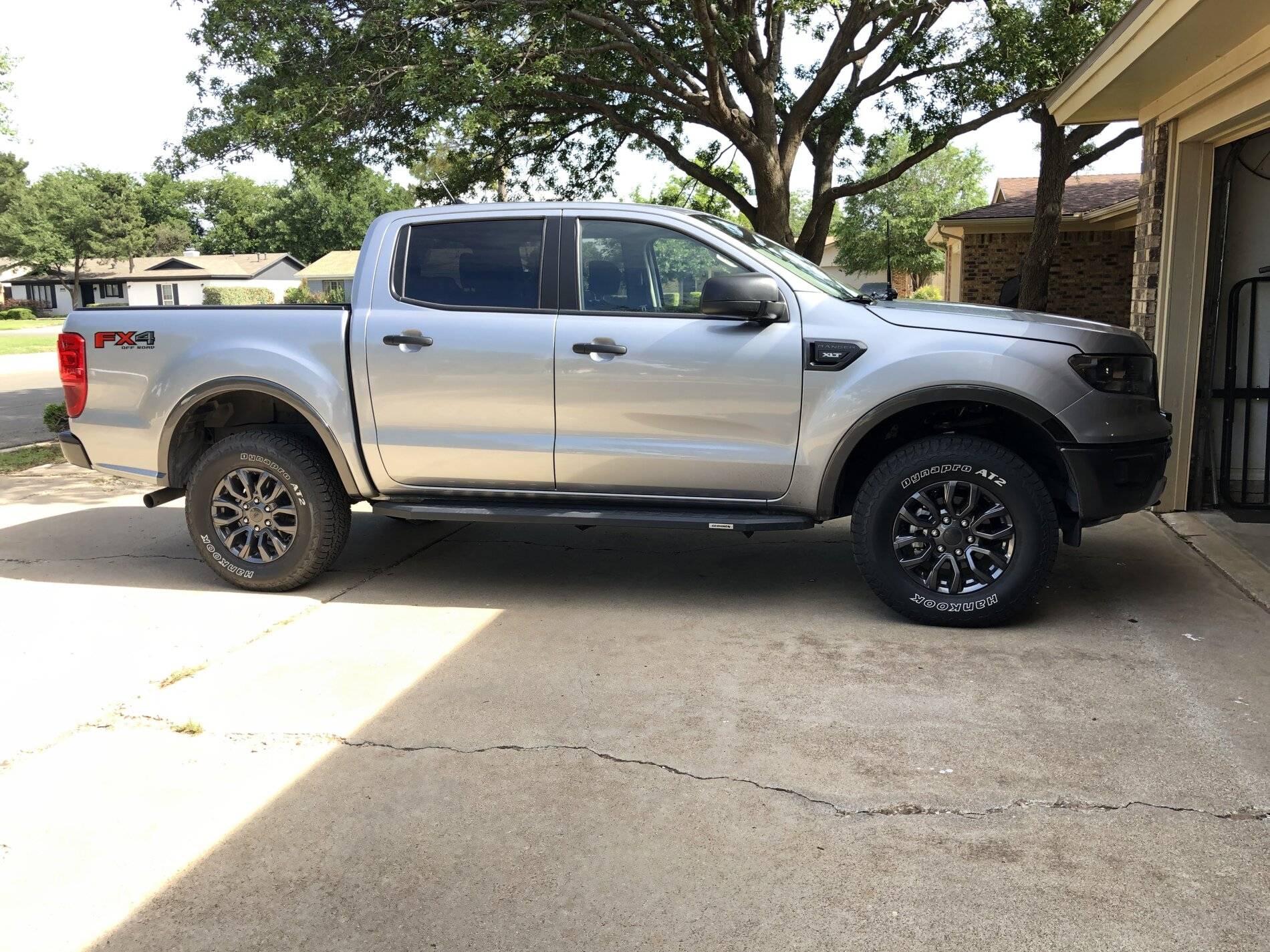

I have exactly the same setup, except that I set it to 0.80" and changed the tires to 265/70R17.

Looks great with the larger tires!

How did you get it set, did you have a shop set the 6112 prior to install?
I just used a pair of pliers to move the retention ring to the next cutout, then the next.

2 inches will still leave a little bit of forward rake. A little looks OK to me.
I had a local shop that I trust install them. I did the rears myself last time and that was easy. The front is work I could do but I didn’t want to burn a bunch of time figuring it out, and I’d still have to take it in for an alignment.

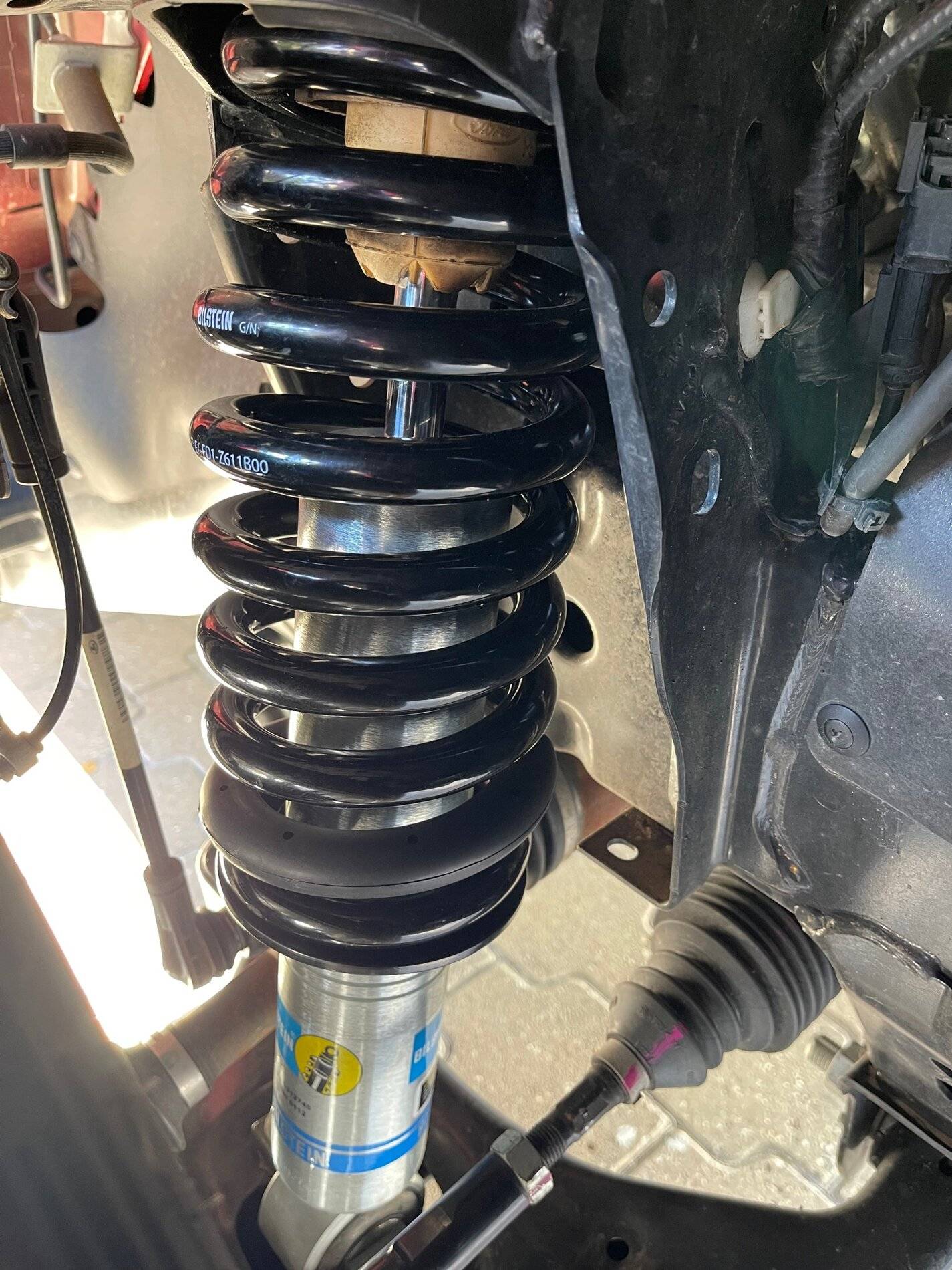

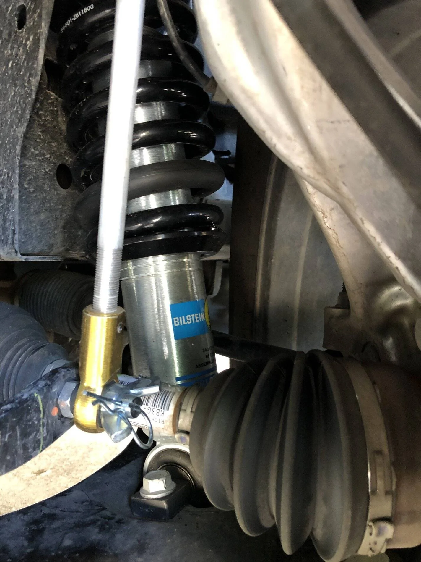

What does the 6112 do for the front?
Would you consider 6112 all the way around?
The 6112 is a larger diameter shock than the 5100. Because of this; the stock coil spring will not fit around it. It is sold with replacement springs, but the upper stock components are reused. This means your stock strut assembly will need to be disassembled. This would also be true if you installed 5100s in the front, but not if you ordered something like the FPP Fox struts that are pre-assembled. 6112 shocks are not available for the rear.

I bought the 6112 kit for the same reason LoneRNGR did - I got tired of waiting for the 5100s that were out of stock. I'm glad I replaced the springs as well while it was all taken apart. The OEM springs should work fine with the smaller 5100 struts.
If I want to upgrade the back shocks at some point those are quick and easy to do myself. I don't plan to do much off roading - I just wanted to fix the ride and make it less boat-like.
