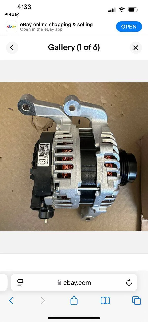

However, if you view Ebay pics of alternators, they have a label with 150 stamped on it.
So, 150 Amps is the nominal range with a Max Output of 170 Amps

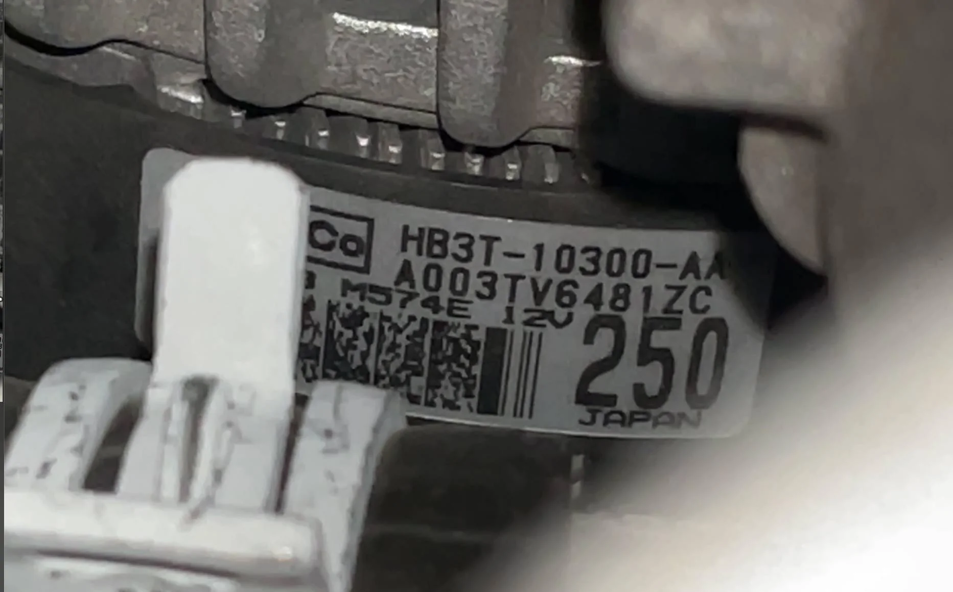

2022 Ranger Tremor XLT
The Tremor has a 250 amp alternator
Pictures show the stock 150 amp and the 250 amp for the Tremor
Awesome - Thanks for the CORRECT info and installed verification

Just to finish off the requirements to upgrade the Alternator - if one was to choose to do it.
Then the 250 Amp Alternator & Replace the 225 Amp fuse with a 300 Amp Fuse on the BMFL.
The only noted (that I could find) As-Built file would be in the PCM would need changed to tell the PCM that a different amperage alternator is installed for the LIN circuit control of it.
No changes in the BCM as the BMS data files remain the same
7EO-162-01
From: Factory - 0085-0000-0085 (150-159 Amp Nominal)
To: Tremor - 008F-0000-0025 (250 Amp Nominal)
So, change xx85 to xx8F
