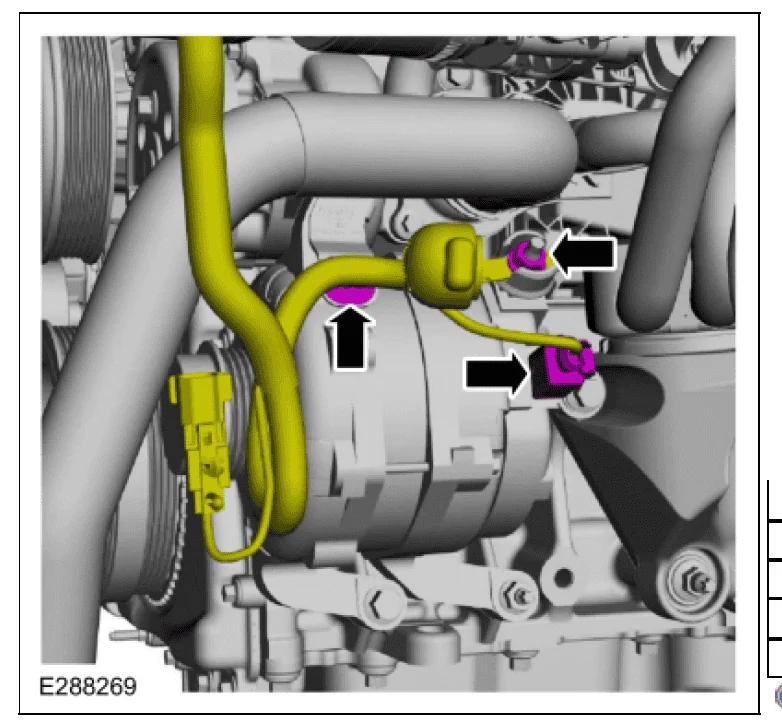

looking at schematics....how low do you guys think it is on the engine?
this seems to show it above the centreline of the crank if its correct.
Looks like 3 bolts. 2 short ones coming from the drivers side to the engine, but one that comes from the engine side and screws into the alternator - kinda strange.
I'm sure somebody could make a splash guard easy enough to protect it from driving through puddles or on the highway. However, anything above hub centerline is going to get it soaked. However I do recall now something about the rear axle seals also not being sufficient for water above axle centerline. Can't remember why though... The breather tubes for the front axle and transaxle I think are also just barely level with the top of the tires.
Not a problem for most people but always good to know your vehicle very well before venturing too far off pavement.
