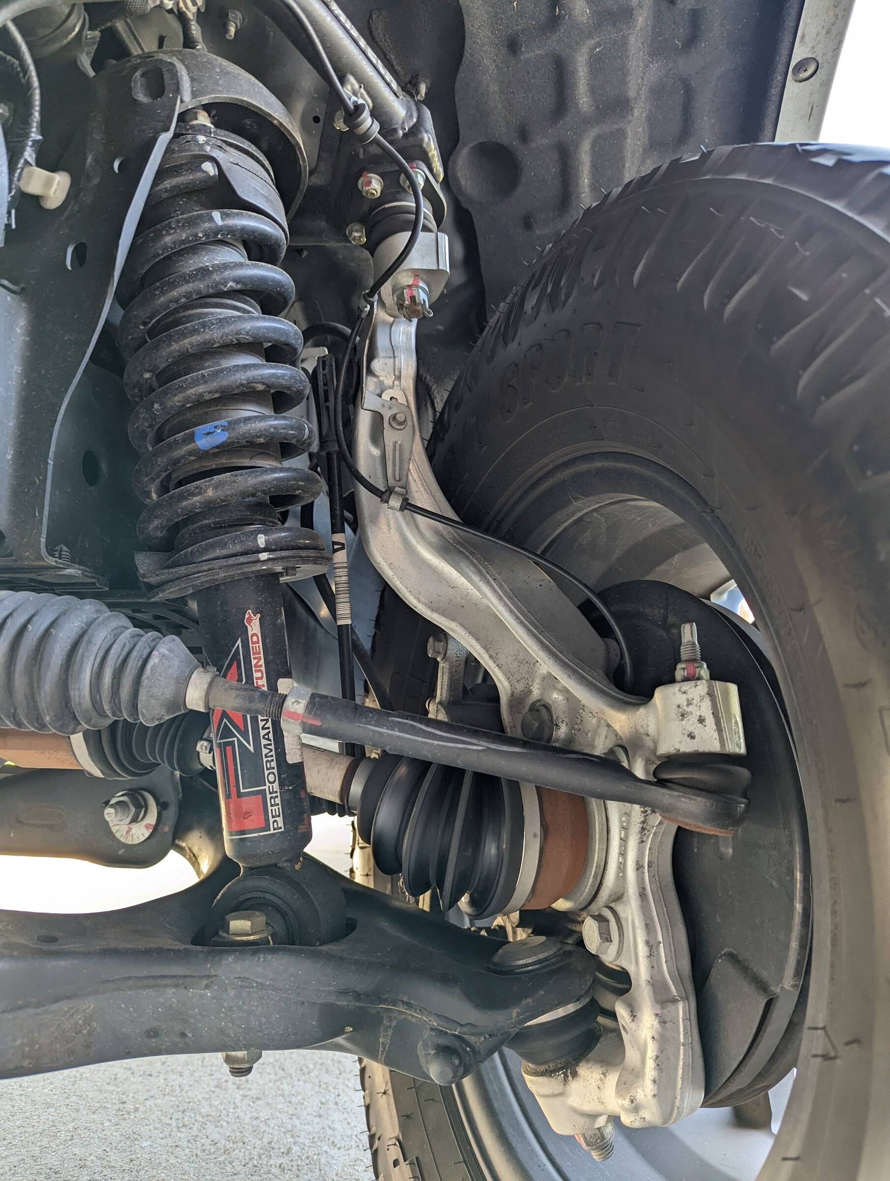

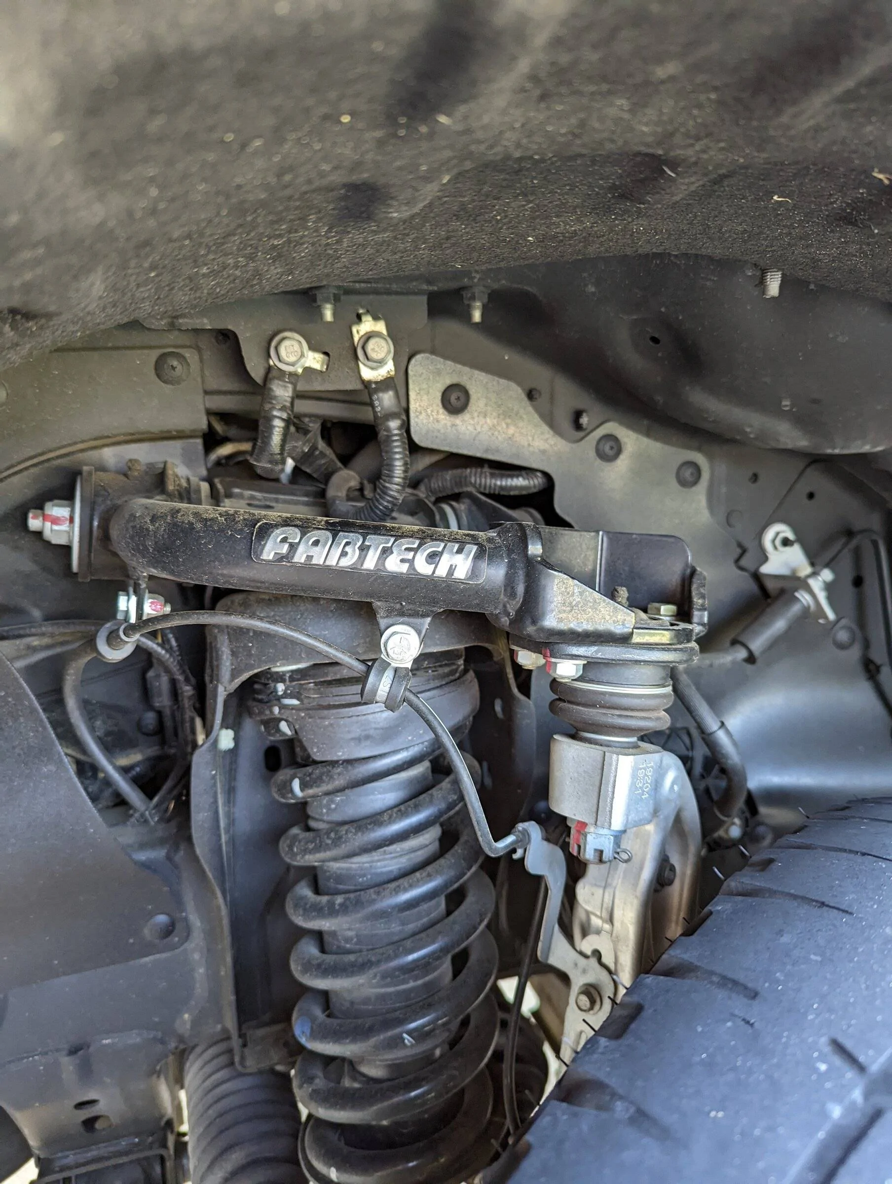

Upper control arms appear to be aftermarket. Attached some pictures with a closer look at what's going on under there

Wait a sec! You have the factory shocks on and a different UCA?
??‍♂ Do I? This is what was on it when I bought it two weeks ago. This is why I'm here. To learn what I need to learn. ?
So I guess I have factory shocks with spacers. That's probably the main reason for the uneven tire wear in the front?
Pretty sure that’s it. The FX shocks aren’t all that good. Many here ditch them as quick as they can. Go with some aftermarket ones that give the same lift and get an alignment and you’ll see a notable difference. Plenty of threads on here discussing shocks.
