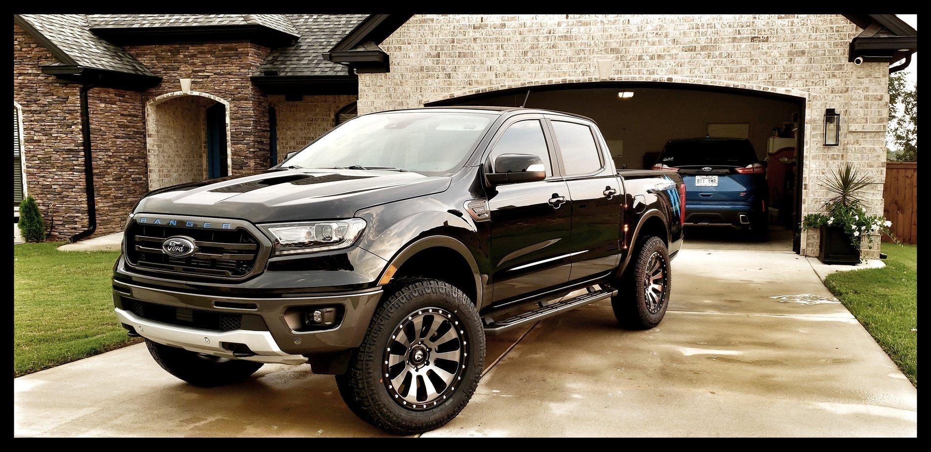

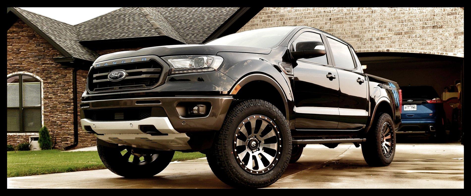

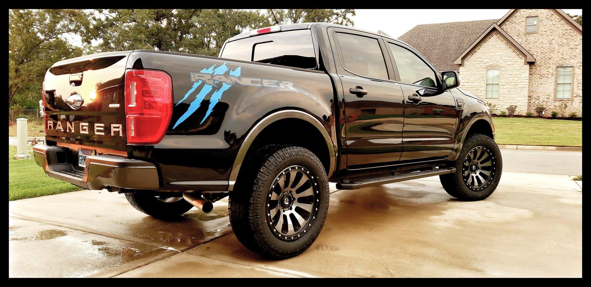

I guess it's my turn, just did a Ready Lift 3" level. Truck is tall now, really need that shit handle for the drivers side and I'm 5'9".
Tires are ProComp Sport AT 275/60/20 with 20x9 +1 offset Fuel Tactics. I did have to do some heavy crash bar cutting.
Grimlock is sitting pretty now, this will all I be doing for a while. :rockon:
The wife is going to kill me.

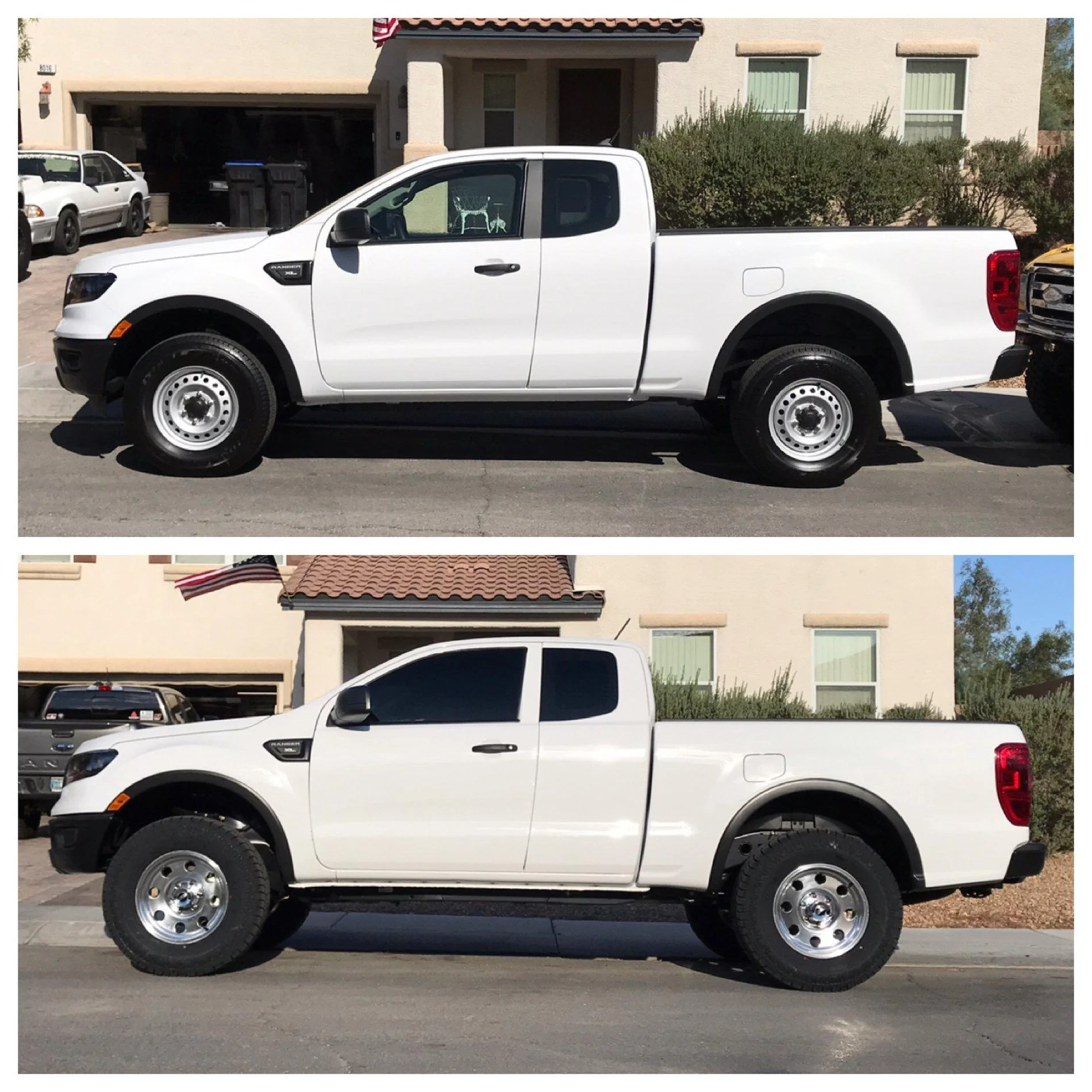

I went with the 3'' Ford Ranger Lift kit. Gave me a fully balanced 39" height front and back. Measured from the ground to the center of wheel well.
Before and after.
COOPER AT3 285/70/17
Looks great.

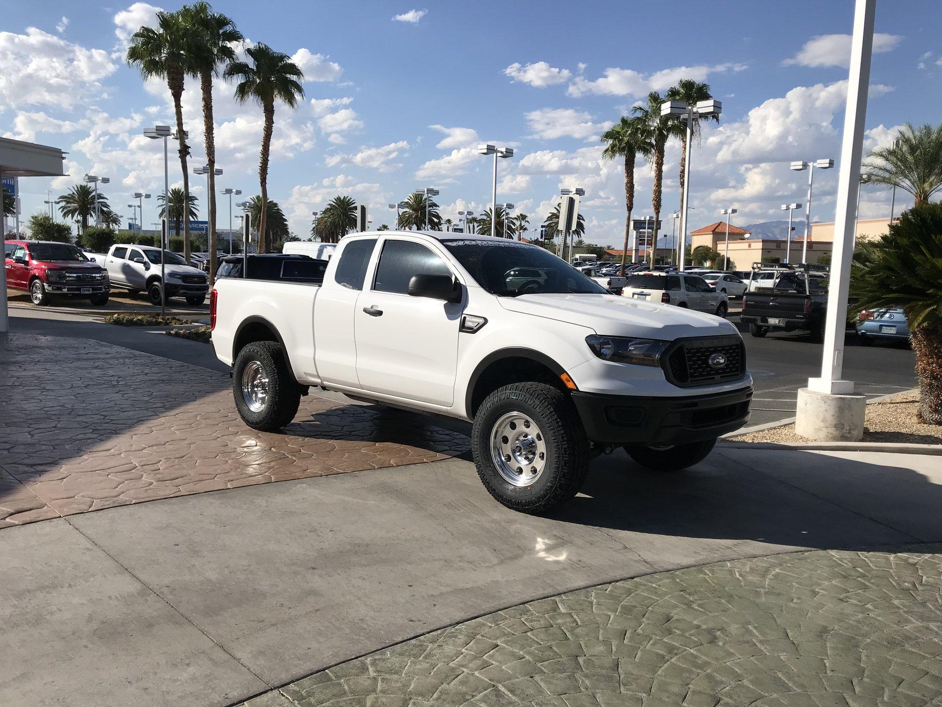

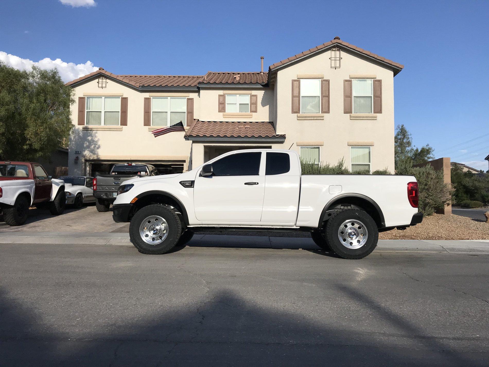

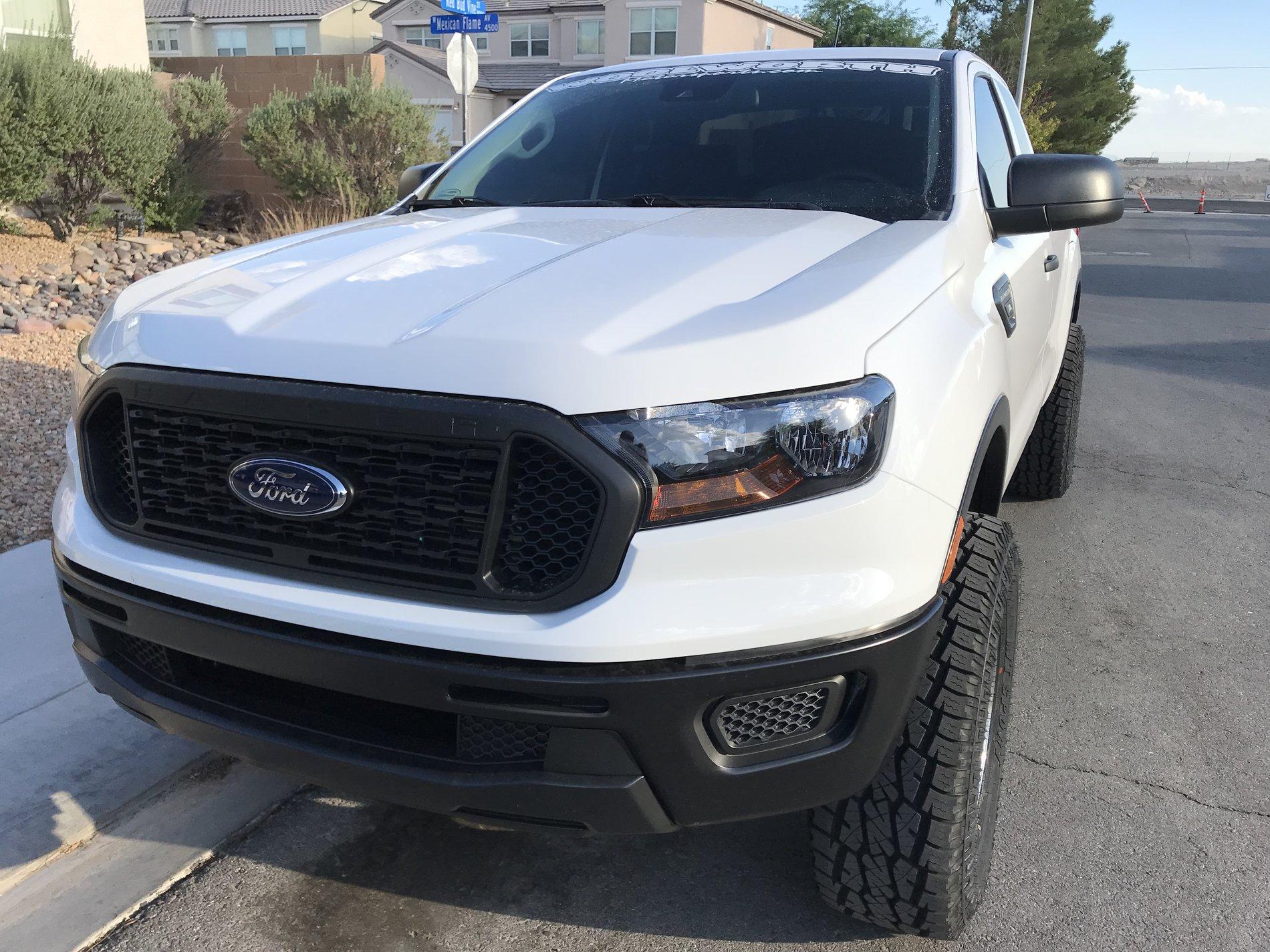

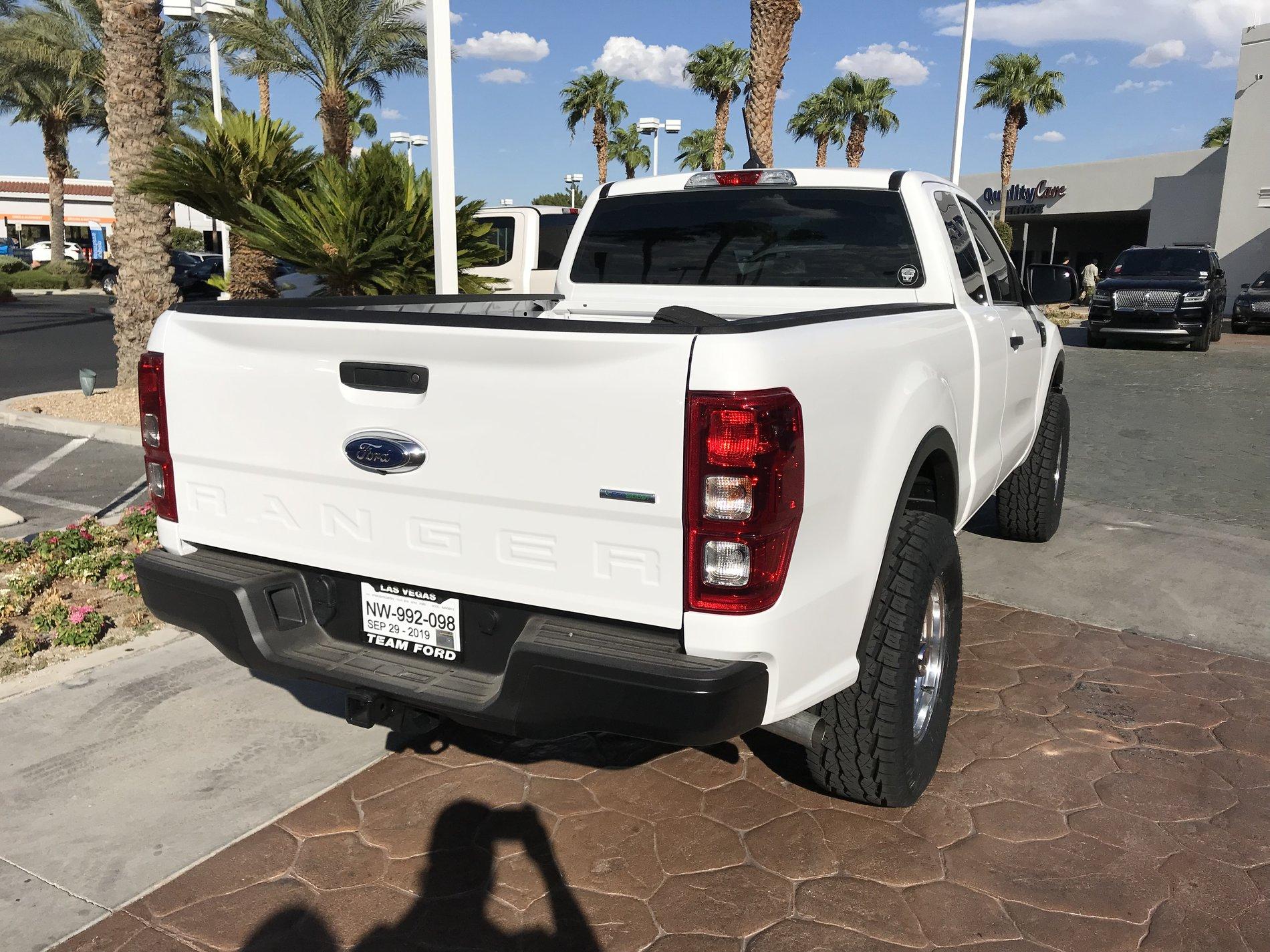

Looks great.

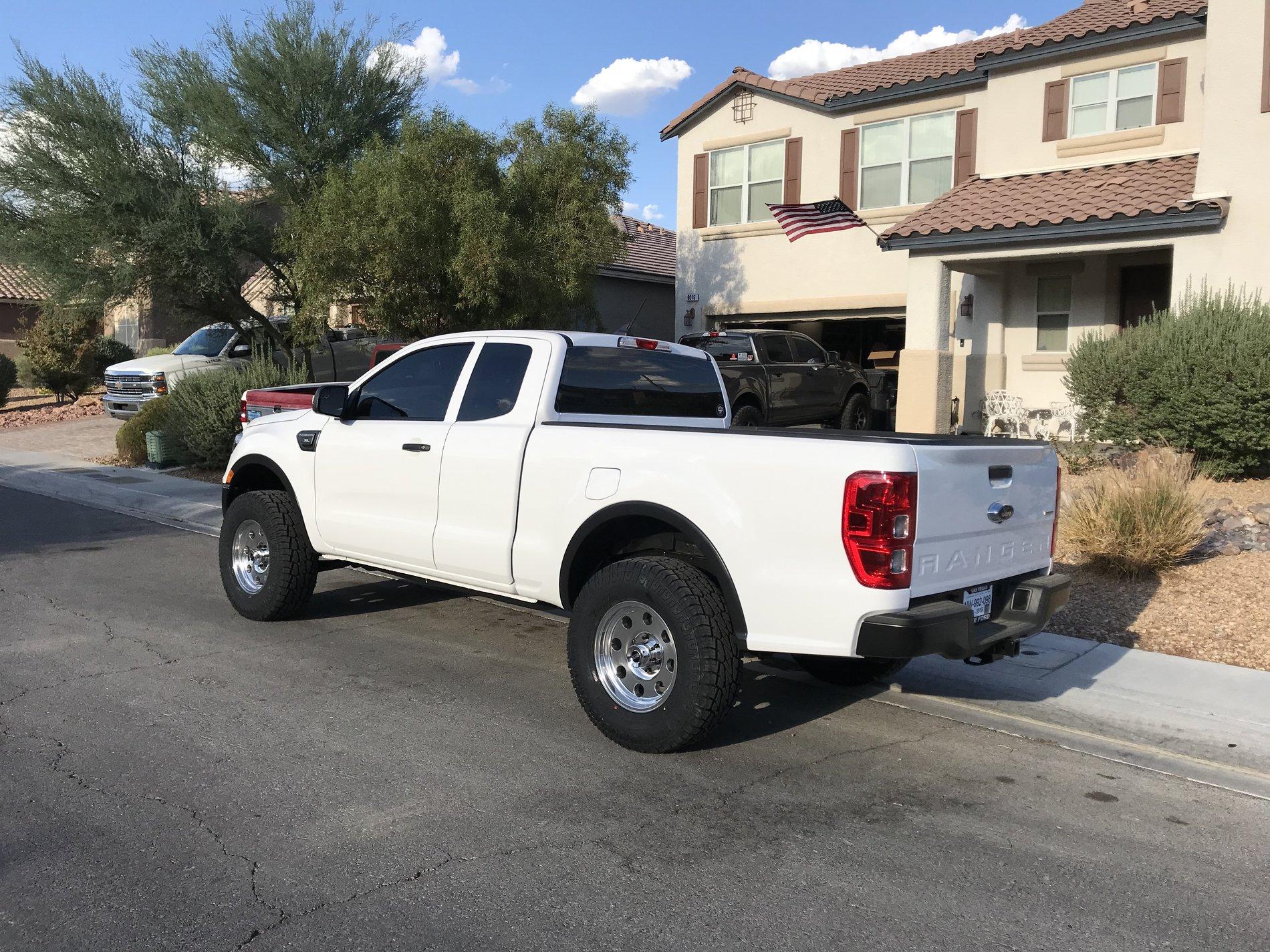

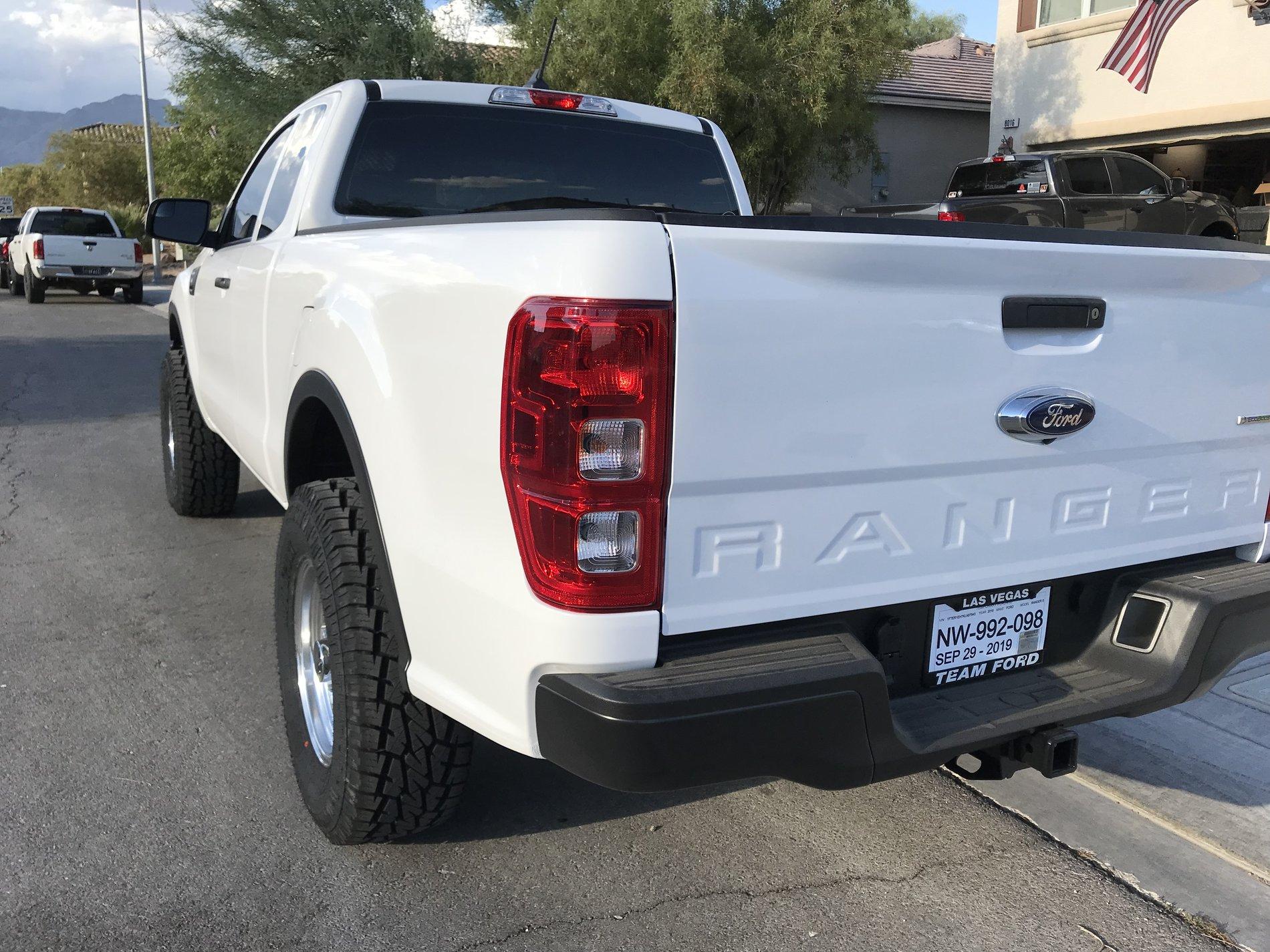

Just bought another ranger. This one is a 2wd XL supercab with our 3” level kit. 285/70/17 pro comp on 17x8 American racing Baja wheels with 0 zero offset and 4:75 back spacing.

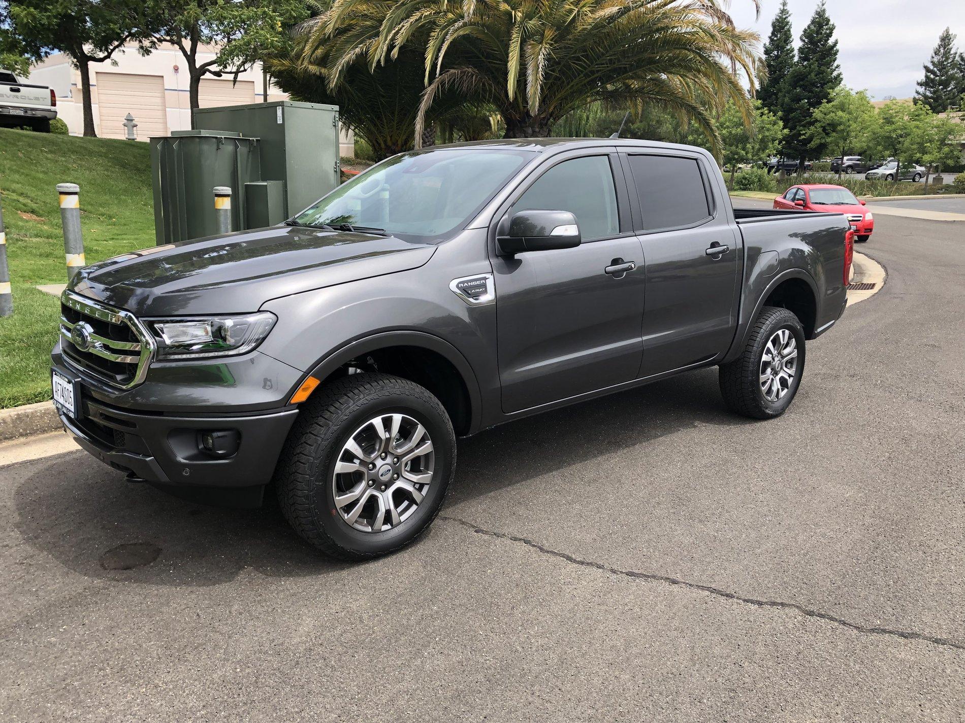

Just had mine done a couple of days ago. Icon with tubular UCA's. Got tired of waiting for Icon wheels so went with Fuel Grey Shok 17x9 +1mm offset. I'll have to do a little more trimming on my crash bars and remove those plastic blocks at the rear of the wheel well.

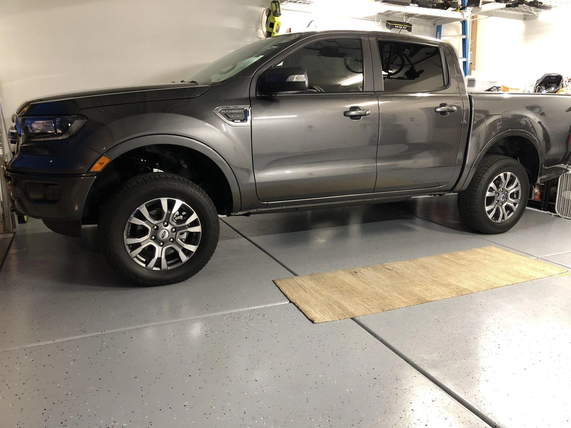

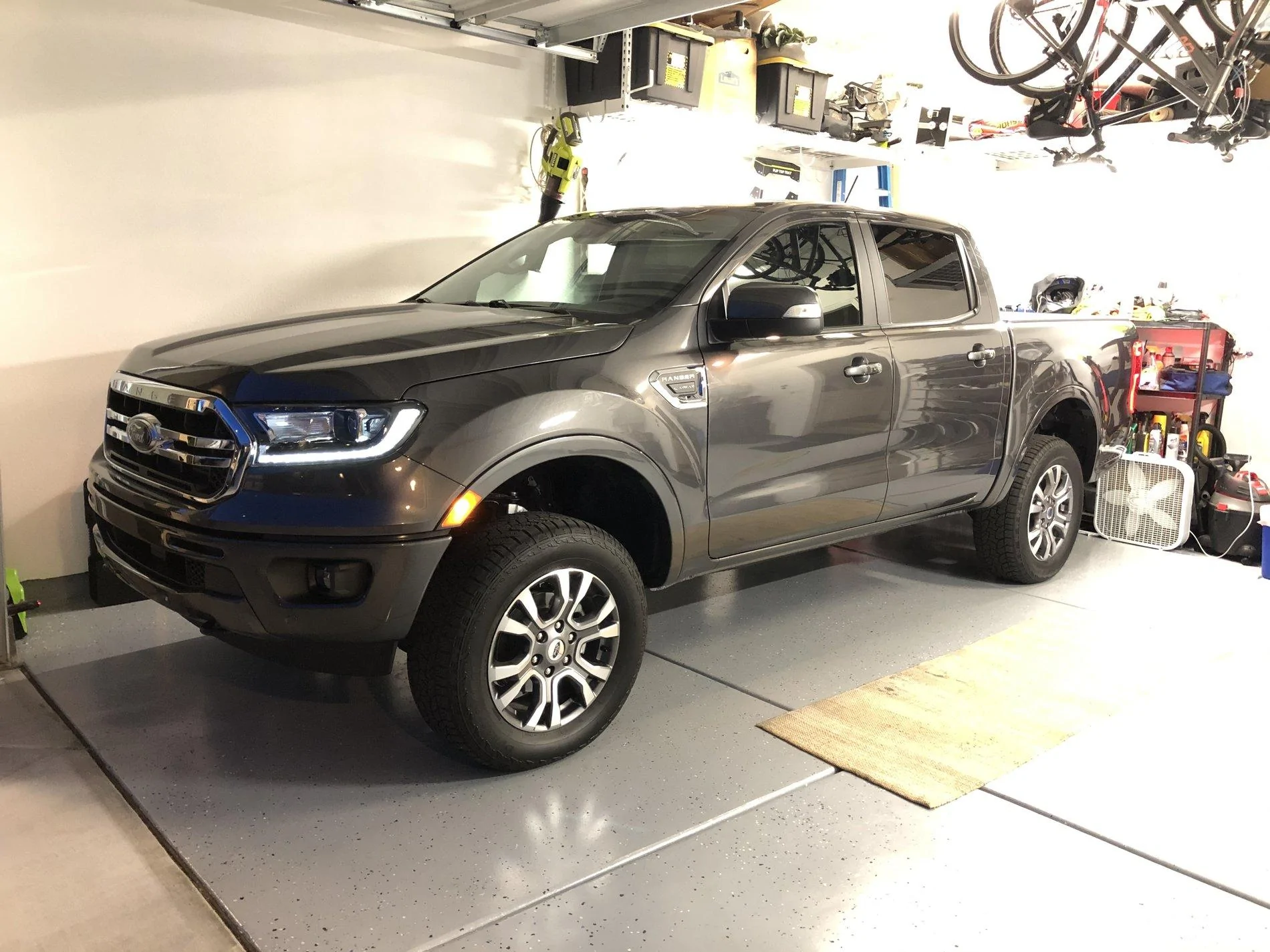

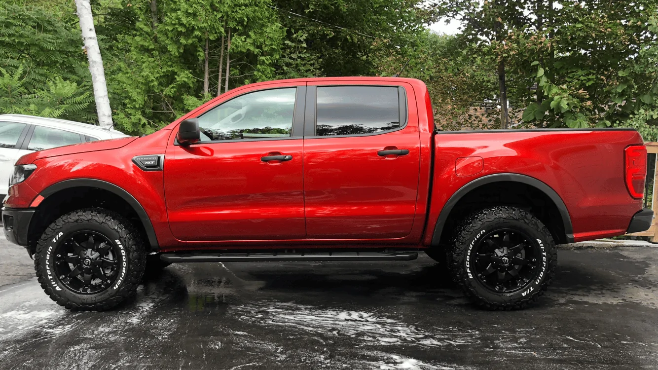

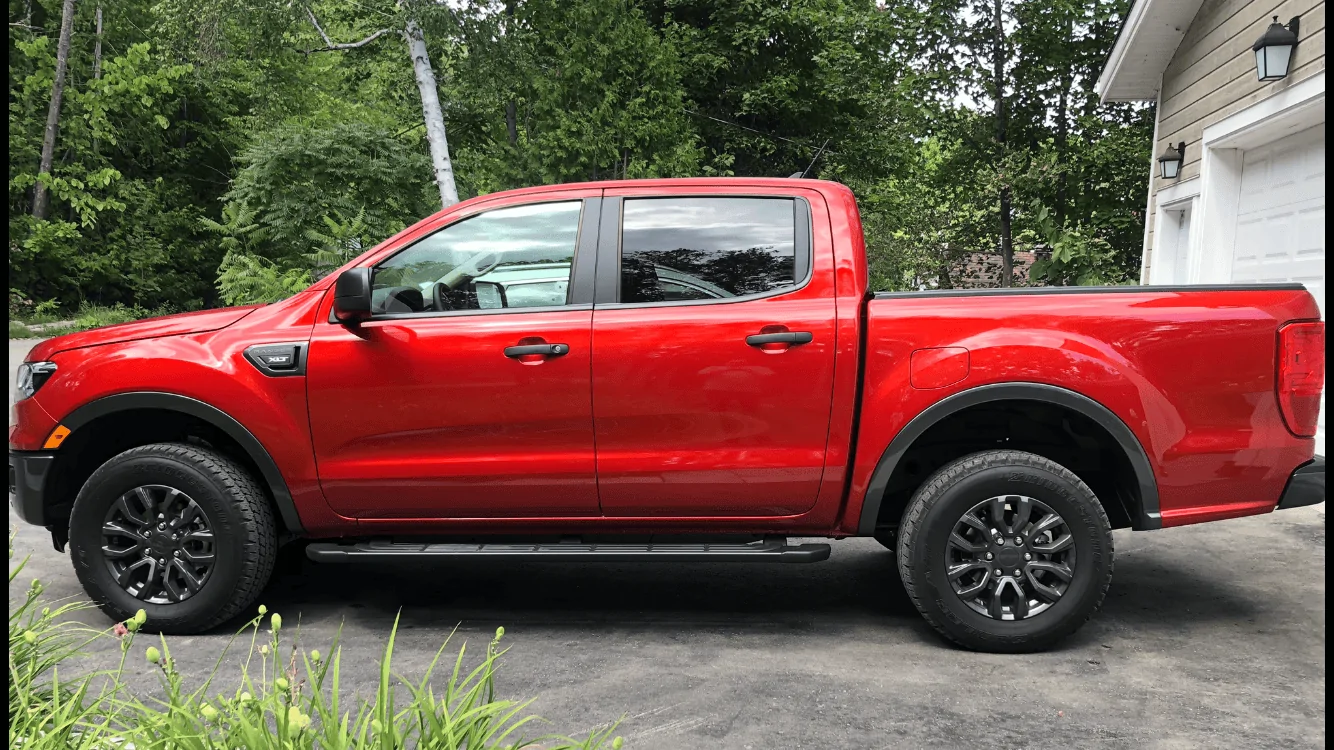

Here is a quick before and after shot with a 2.5 ” level, 275/65/18 tires and fuel rims. These are the biggest tires I could run with out moding or removing the bars in front of the tires ( crash bars I think their called).
What offset did you use on your FUEL rims?
And which direction of the driver's side wheel gets closest to the front crash bars during steering lock? Hard Left? or Hard Right?
