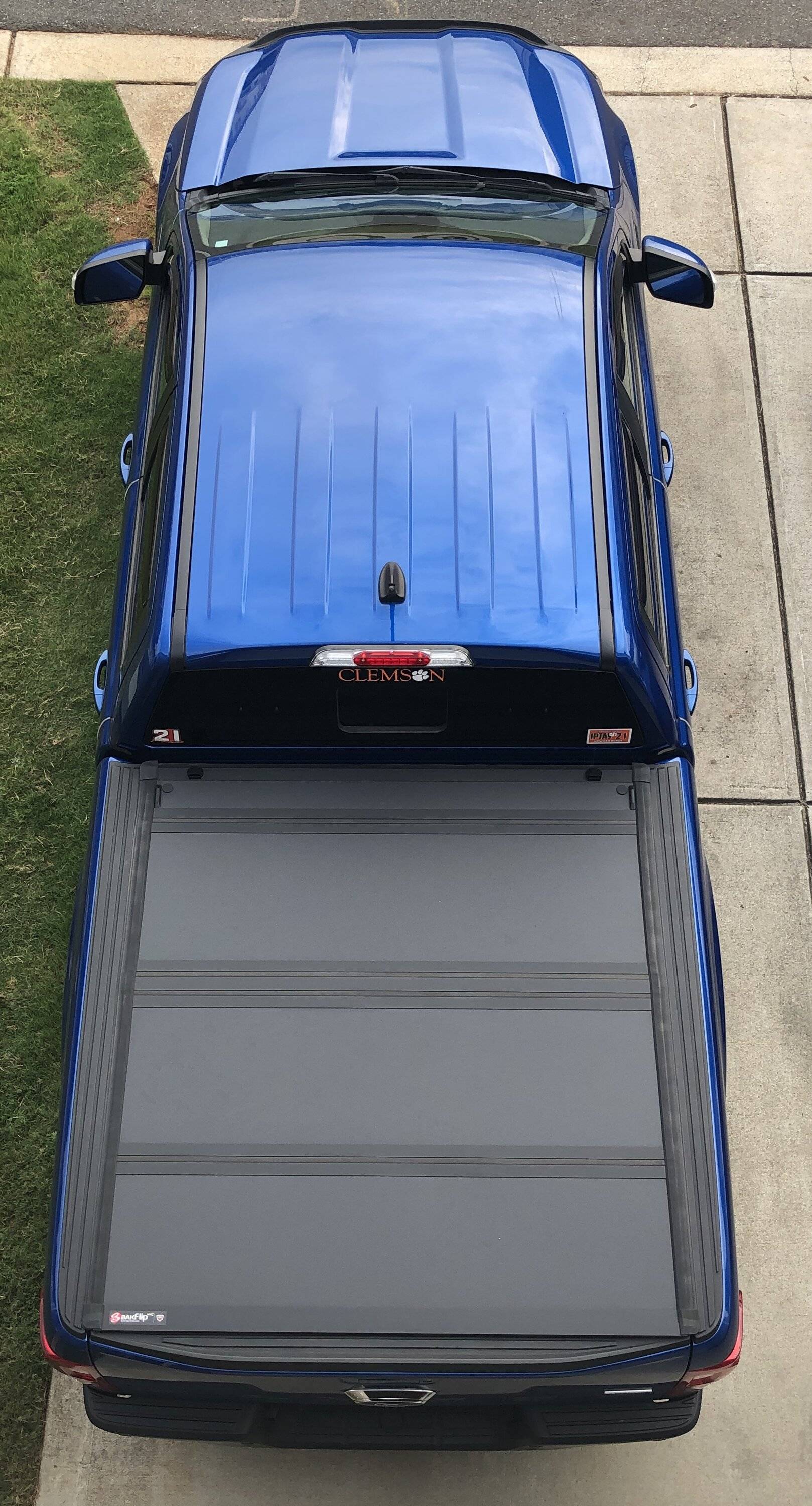

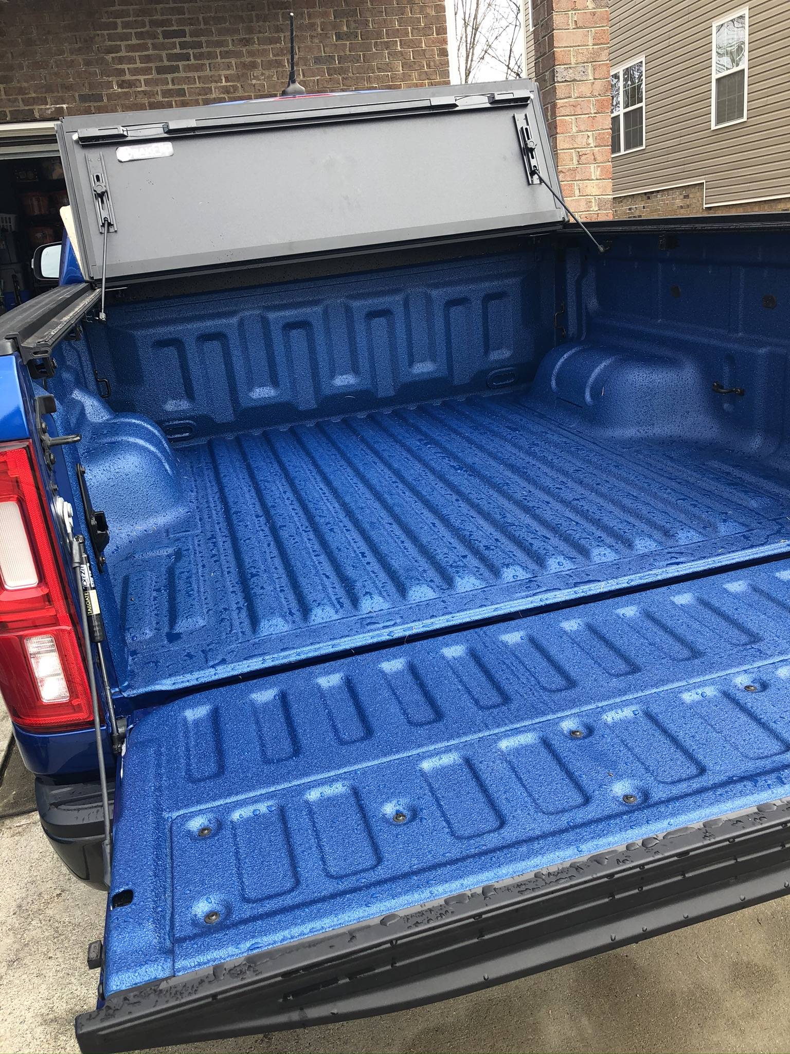

I have both the MX4 & Line-X. The local Line-X dealer for me was also a Backflip distributor and they would have installed both if I wanted. There is no “drilling” required, but if the Line-X came first you may need to clear some holes for the mounting brackets.
