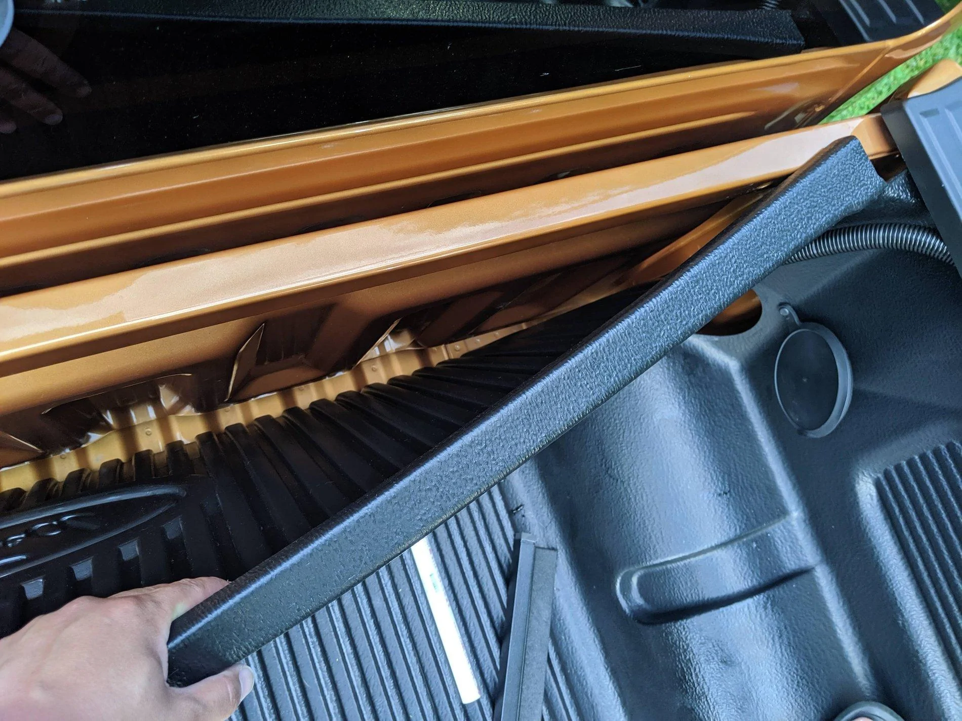

i couldn't find clear instructions or pics for locating the drain hole locations with the drop in bedliner installed. i was worried about drilling blind and hitting the bed, so here's how i installed the drain tubes.

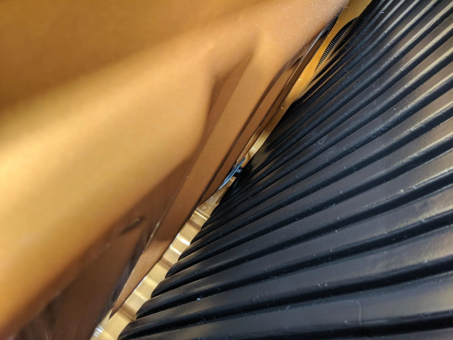

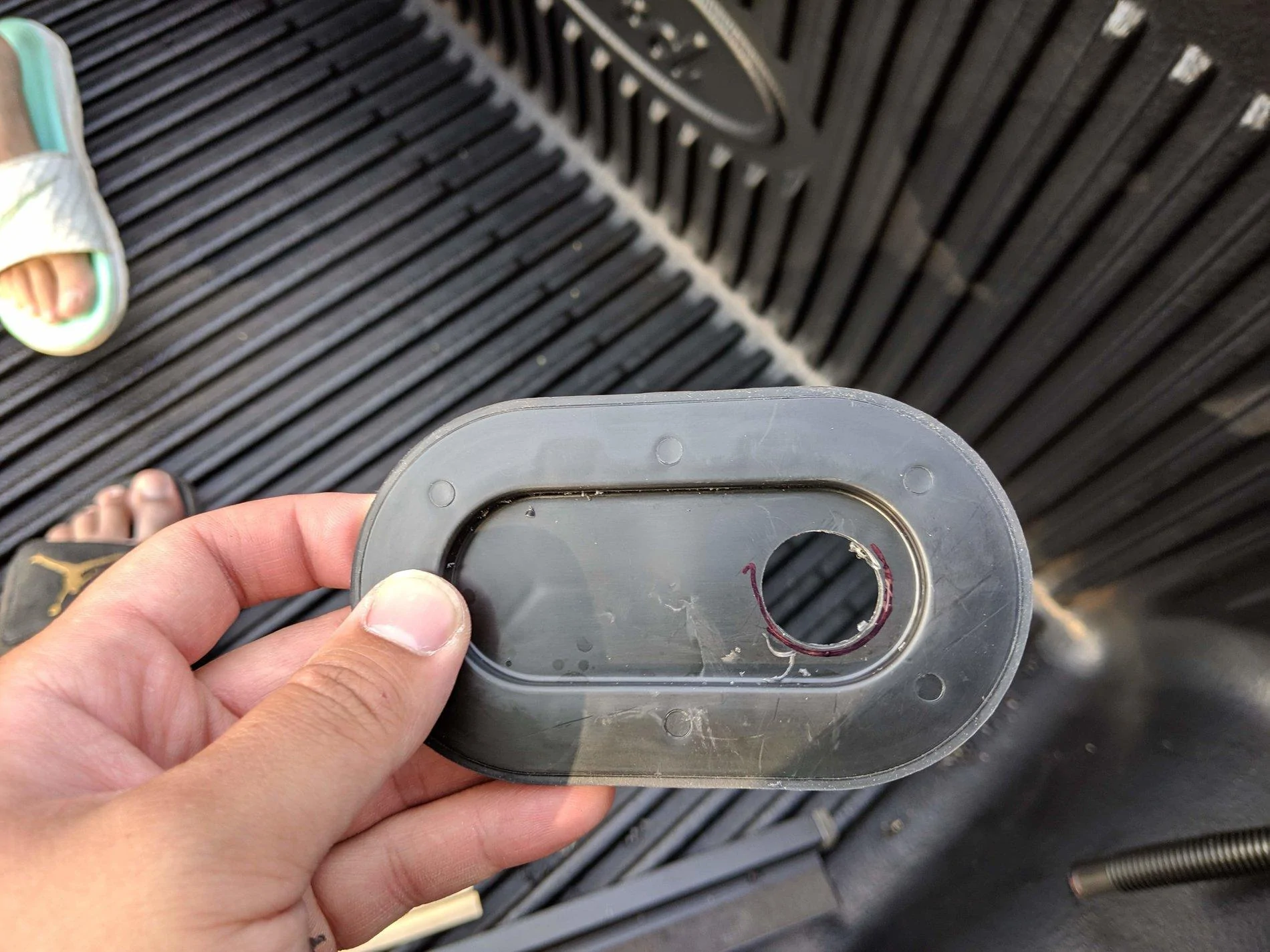

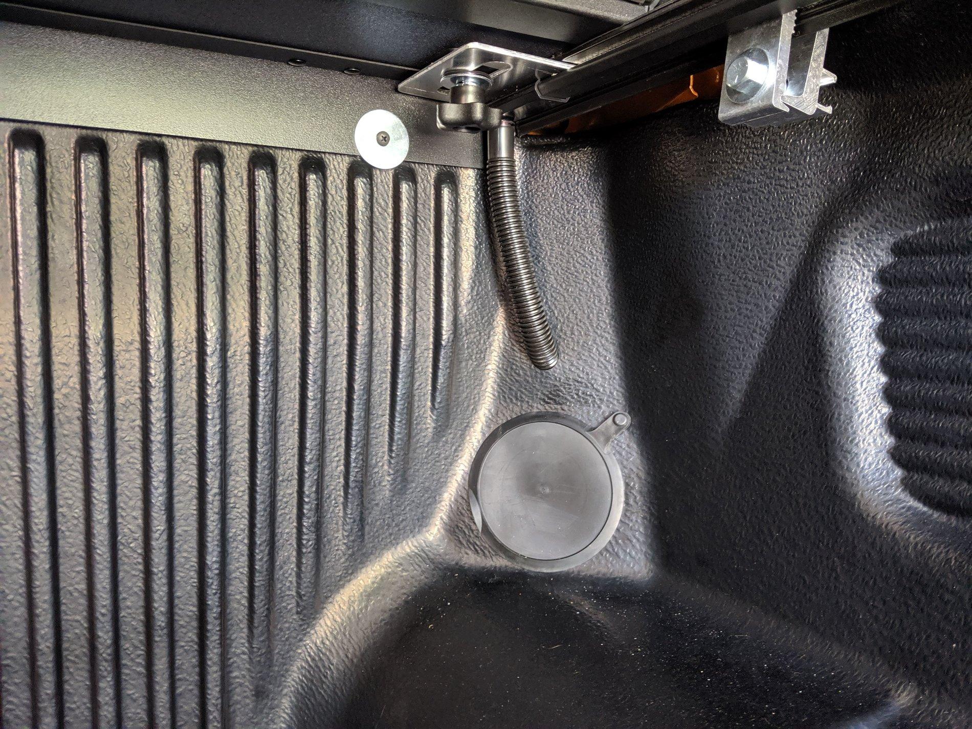

i pulled back the liner from the front of the bed and removed the drain hole caps. then i drilled holes in the drain caps and holes in the liner about 2" above the tie down openings. drain tubes went through the liner and through the drain caps. then fishing the drain caps through the tie down openings, i put the caps back into the bed and re-seated the liner.
you definitely need smaller hands to reach between the liner/bed and into the tie down openings. this is where the fiance came in. i know most ppl here have the spray in liners, but hopefully this helps anyone else with the drop in.
