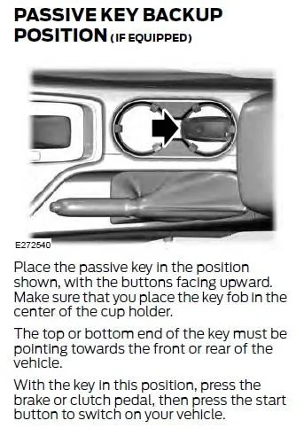

I have a 2022 Ford ranger lariat with tremmor package does anybody know where the backup key slot is? Apparently every Ford vehicle has a back up key slot Where youmInsert the key when the engine won’t start. Also there is a process where you place both keys in the backup slot and the factory code Will appear on the dashboard. I bought my ranger used and no factory code was provided and without the factory code I can not program the door panel with a code that can be used when keys are lost. Thank you.

From other posts on here about the keypad entry - it is completely separate from the fob codes.
It is supposed to be on a card - it may be with the owners manual - witch also points out the backup key location - yes it is in the rear of the cup holder

I don’t have a link handy but the online version of the Ranger Owner’s Manual has a picture of the location: It’s in one of the cup holders, there’s a logo embossed in the plastic. Shape just perfectly fits the fob when aligned front to back.

Ref: This recent thread for same situation.
I posted some PDF's in this thread, but it still boils down to, if you do not have the card that the master code is on, either replace the keypad or see if dealer can retrieve it with the Vin# lookup.
I do not have the keypad, so I am not sure if Forscan would display that information.
The keypad entry is not in the service manuals and like another post, even though it is installed at factory level, it is considered aftermarket, accessary.
Success recovering keypad code with both keys? | 2019+ Ford Ranger and Raptor Forum (5th Generation) - Ranger5G.com
But if it helps
