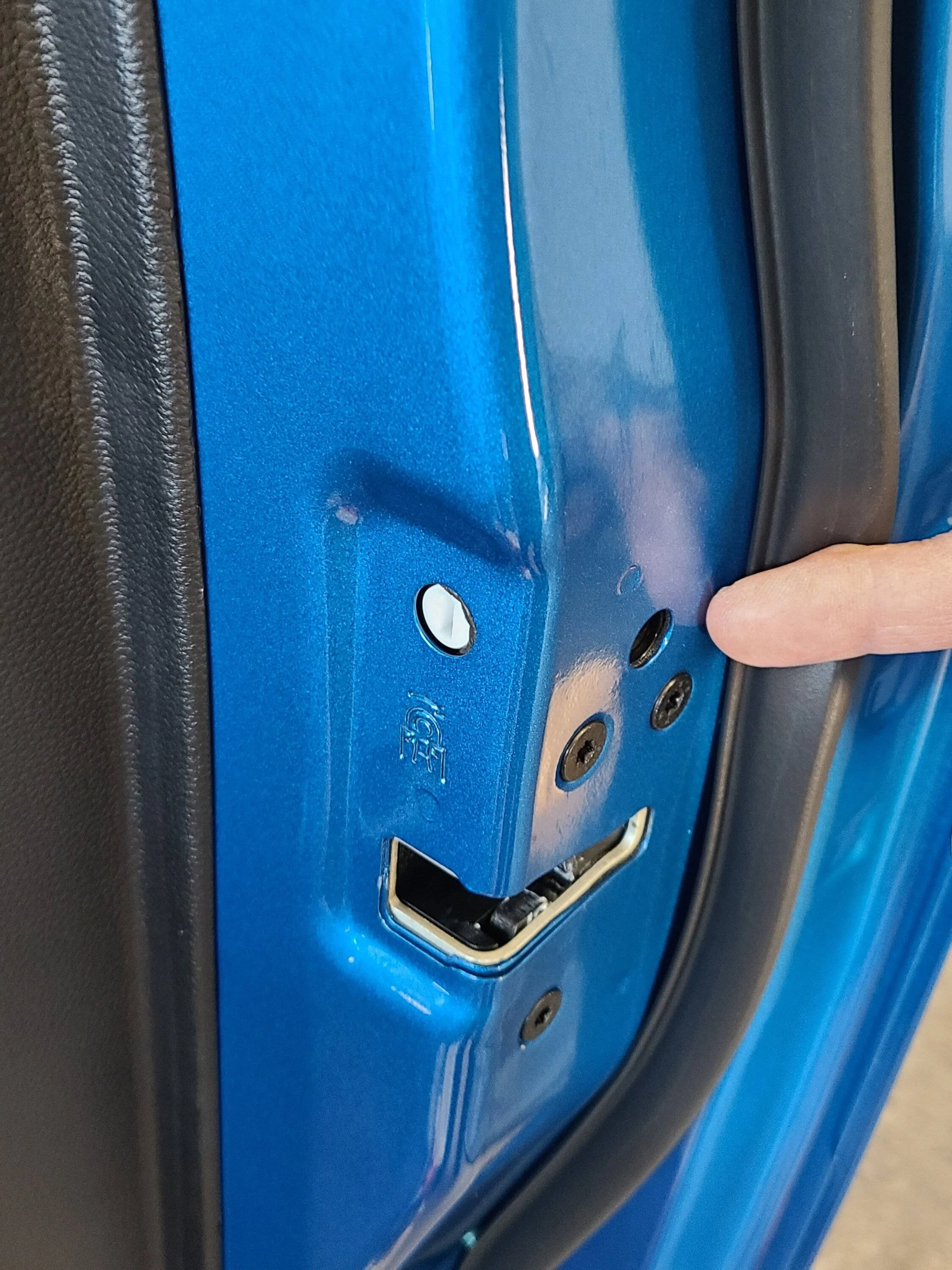

No, it's a different slot. Why would you need a child safety lock on the driver's door? As Phil said, it's for manually locking the doors if the door actuator fails. We are talking about the solenoid/motor that locks/unlocks the doors. Not the fob or door switches.
Rear Door:
Front Door
How would you unlock it then? Lariat w push start doesn’t have a key for that.
Rear Door:
Front Door
Oh my bad, I just watched some vids and they were talking about the child safety lock in it so that's what I thought was pictured.

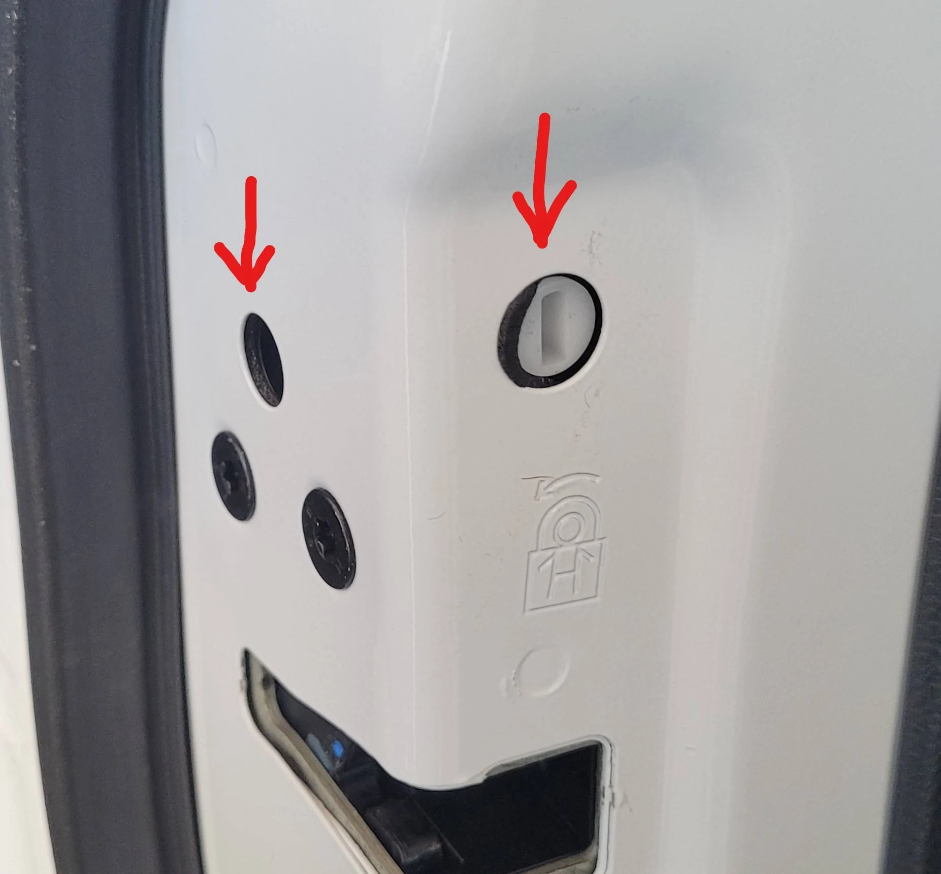

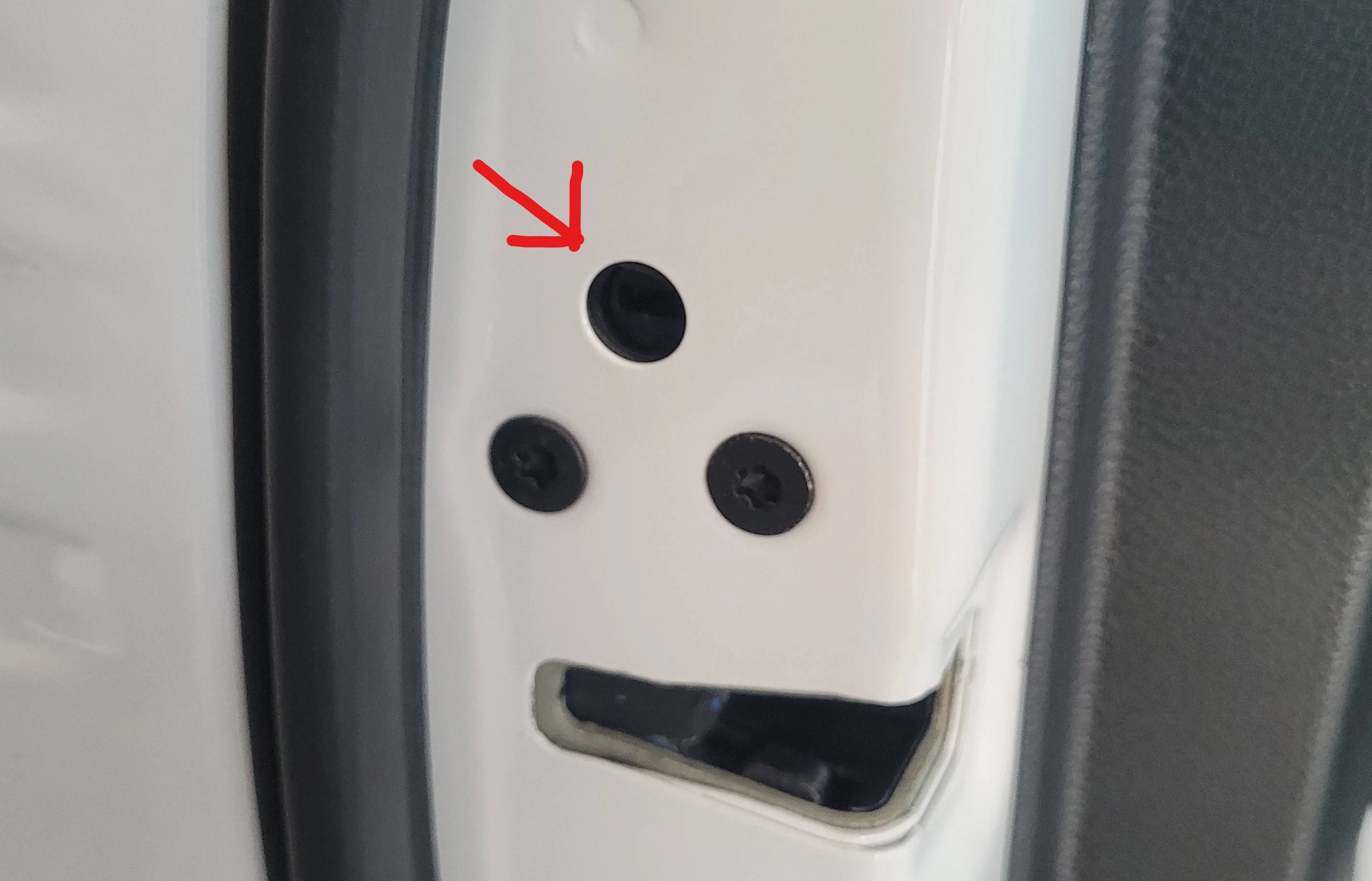

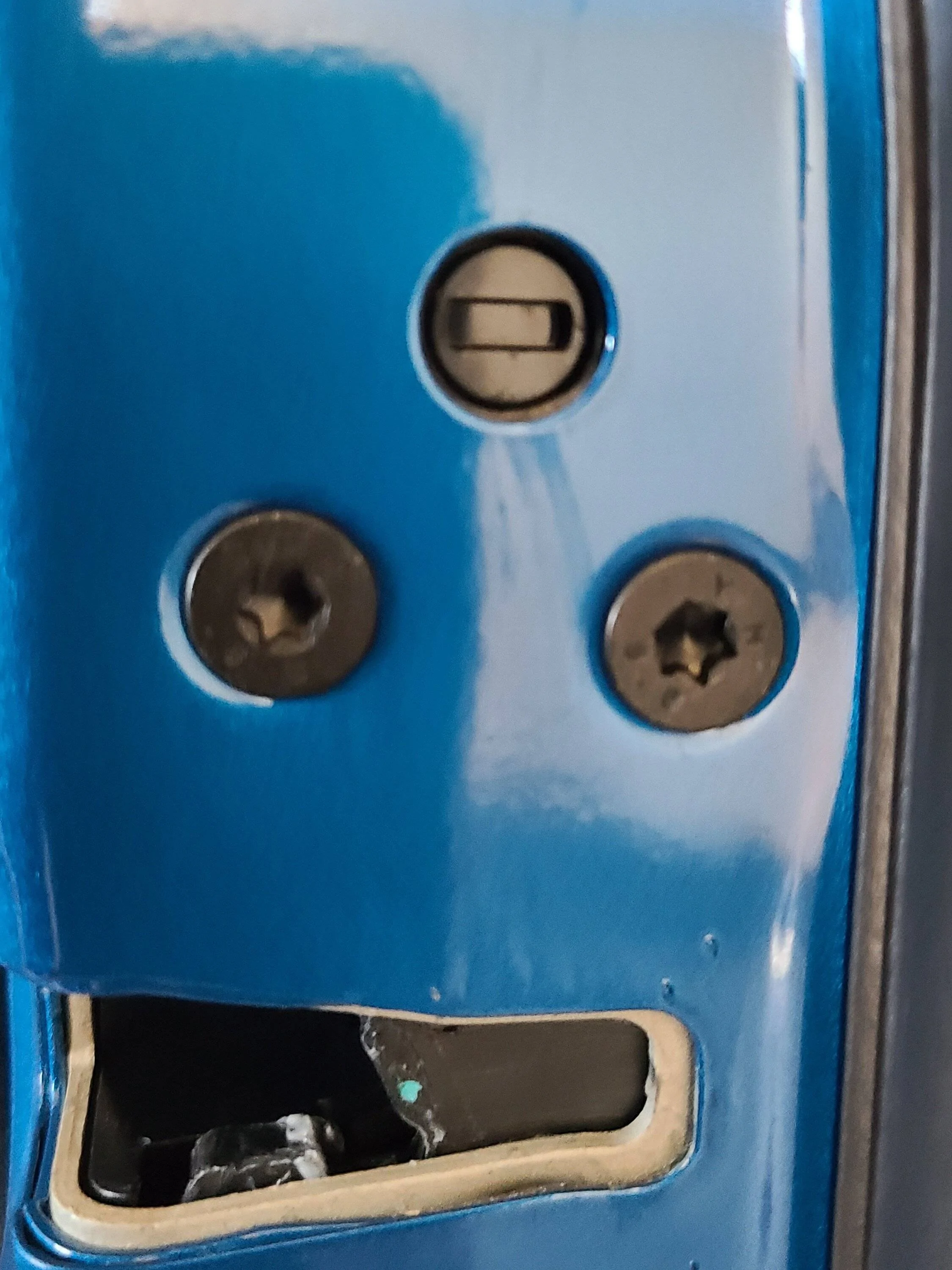

Okay All,
The mechanic in me had to do it: and find an answer
I have Lariat - Screw
All 4 doors have this (Manual Lock with Key Blade) (Black)
Rear Doors have (Child Lock) and its (White)
I tried it, rotated CCW, shut door - Took FOB farther away from truck, Door is locked
It's a way to Manually Lock Truck if: Power Door Lock Fails or Dead Battery, or Possibly if it will work Leave FOB in Truck for a day at Water Park and only take key blade with you. I did not test this though. But I seem to remember a post or video saying it could be done while I was researching trucks to buy
I found this online but it's for a Ford Escape - Better Explained with Pic :like:

Update: It's not an actual keyed tumbler slot, like the spare tire access point, it's just a slot wide enough the key blade will fit into. Flat blade screwdriver will do the same function
