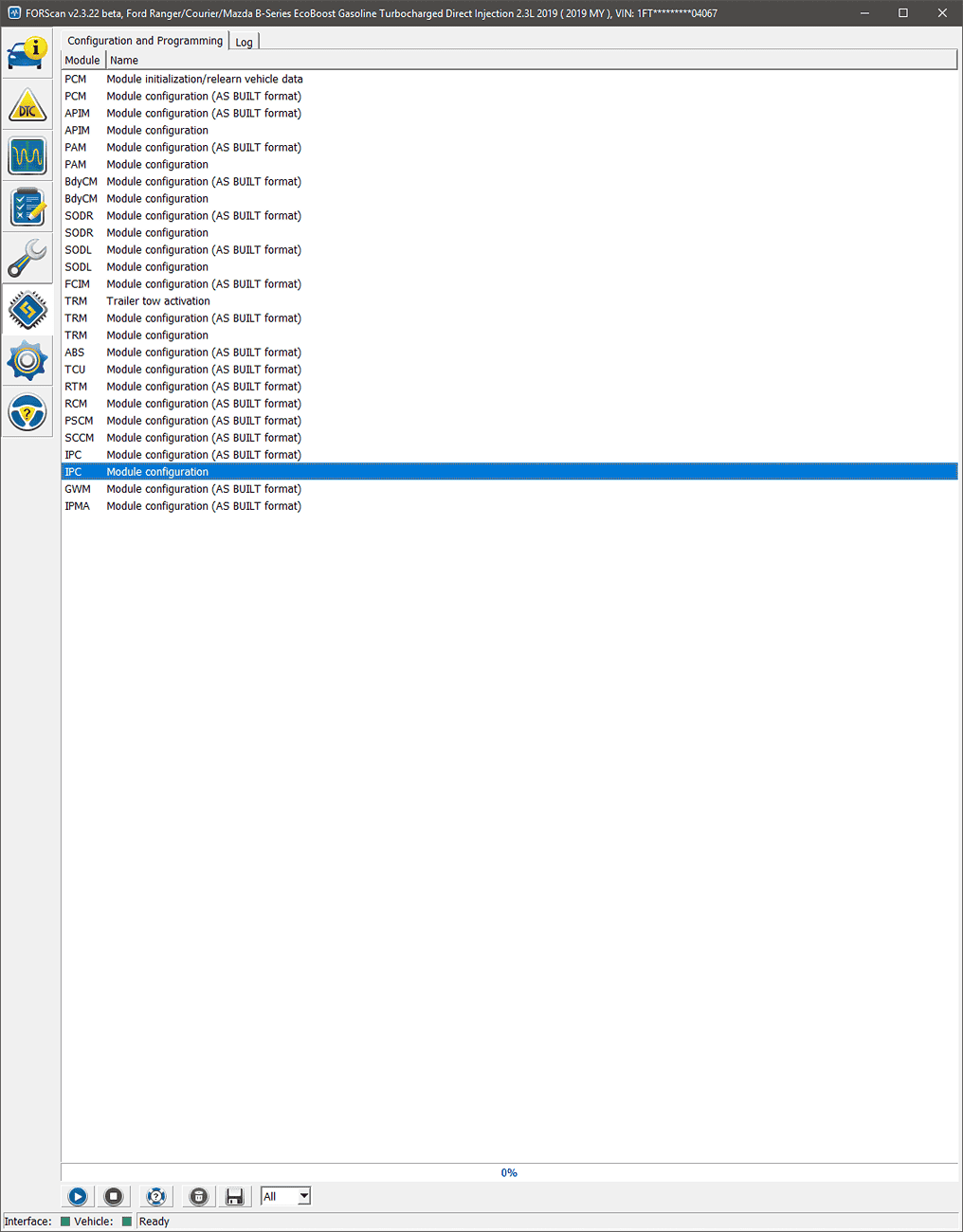

@airline tech , if your still running version 2.3.22, you need to update your version of Forscan. The current version is 2.3.62, there are probably new configuration menus and possibly modules your not seeing.

This was a pic - from Forum (Image Search) for a reference to the module list - to show what to look for (as it is known as BCM but listed in the modules as (Bdycm)
OK, just wondering because alot more modules and configuration files now show up. Alot of updates between .22 and .62 :)
