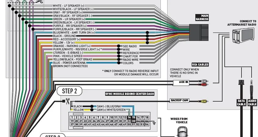

The manuals are not very detailed on what Pin # actually is the Reverse Trigger, to open the Video Feed for display.
So, I am thinking that when the APIM, receives the message over the HS-Can 3 the APIM applies the Ground on Pin #33 which opens the video feed.
Which I believe they are somewhat pointing out here:
Vehicles Equipped With Audio System Display
NOTE:
The tailgate must remain closed for correct operation of the parking aid camera system.
The rear parking aid camera image is displayed by the audio system display when reverse gear is selected. To determine the selector lever position and enable the camera display, the PCM sends the gear position message to the GWM on the HS-CAN1 . The GWM then sends the message to the APIM via the HS-CAN3 .
The camera is on any time it receives voltage (when the ignition is ON), but a video signal is only generated under certain conditions. When reverse gear is selected, the camera continuously generates a video signal. When any gear except reverse is selected, the camera turns the video signal off when the vehicle speed reaches 10 mph (16 km/h) and turns the video signal on when vehicle speed falls below 5 mph (8 km/h). If the camera is not configured properly, some features may be inoperative. The camera sends the video signal on shielded twisted pair wires to the APIM , which displays the image on the audio system display.
It makes it confusing when you do not have a Clear input wire for the SYNC connector as to what is the reverse input signal trigger.
I am THINKING it is pin #33, when HS-CAN 3, comminates to the APIM that it is in Reverse, Internally the APIM applies the Ground on Pin #33 which opens the video feed from Pins 14 & 15.
This is where I am CONFUSED on the Purple & White wire, in the Maestro's wiring diagram, I am assuming it is tying into Pin #33 on the APIM connector.
Sorry, trying to help as best I can, but not fully clear on what wire is the actual trigger without testing it myself and I cannot see a pinout for the Maestro to APIM connector.

Hey airline tech thanks for the wire schematic and printout, i actually had the wiring part but not the C2383A/Pinout i was thinking while waiting for the new interface that if it didn't work then there had to be a bad connection or bent pin at the harness connection.
Well i received the new part and flashed it got all the plugs back in and Wala reverse image is there working properly so no need to trace any further, i can now get this finished up .:whew: .
