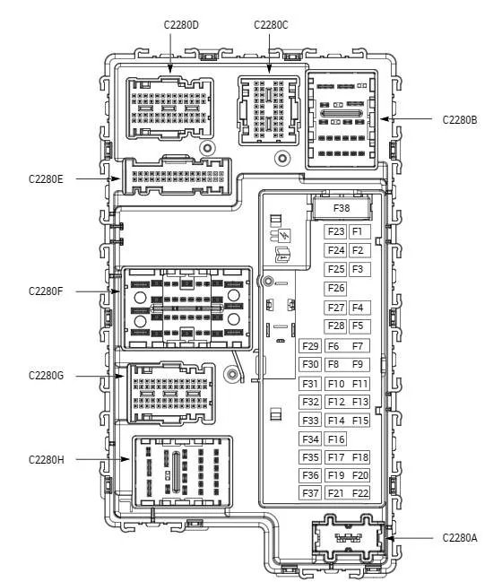

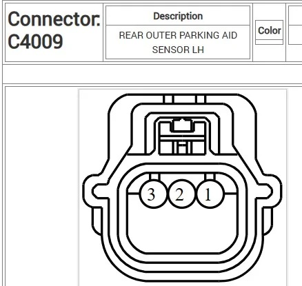

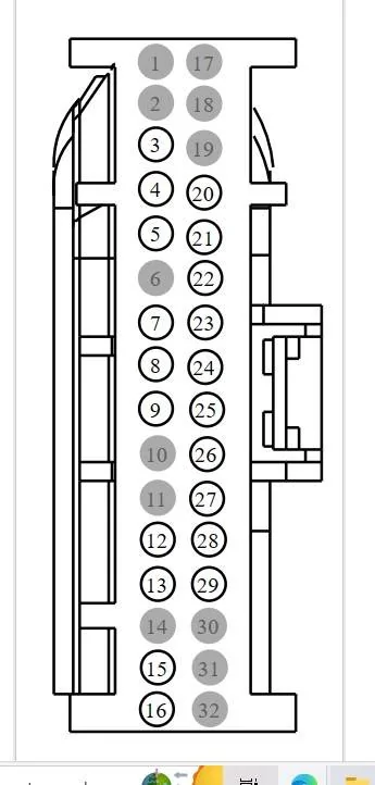

If you disconnect BCM Connector: C2280E and the LR Park Sensor (outer) Connector C4009
You can do a quick wire check for continuity.
C4009 BCM C2280E
Pin 1 -----------Pin 26
Pin 2 -----------Pin 23
Pin 3 -----------Pin 27
Results should around be 3.0 Ohms or less.
