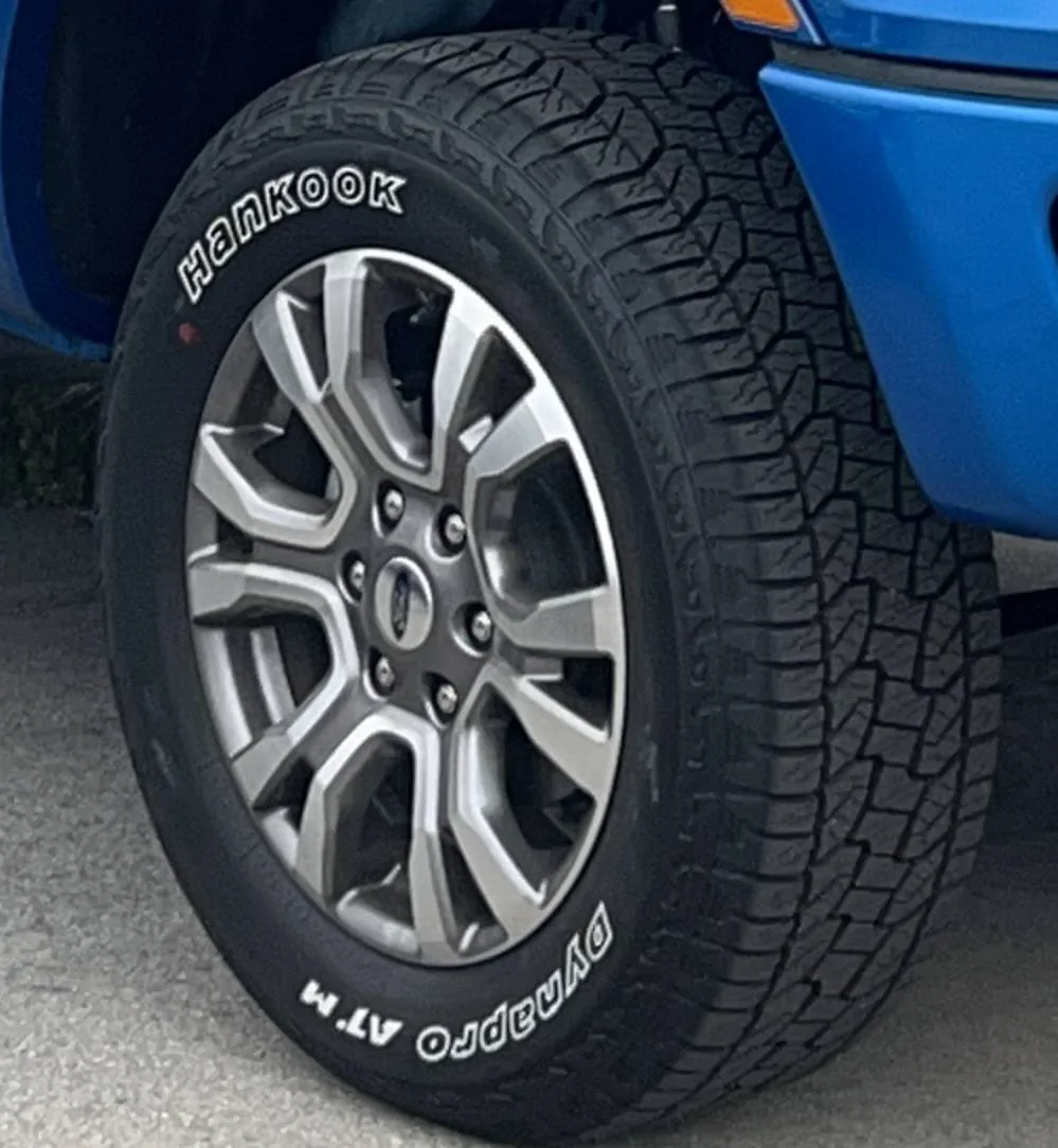

Does anyone know what the back space is on this stock wheel? Thank you.

Offset is more frequently used on our trucks. +55
You can figure the backspacing from there but there's really no need to.

I understand that, but the instructions on my lift say do not use anything more than 5 inch backspace so I was trying to reference with the factory wheel is in “”back space”” while I am here at work being unable to measure it till late tonight. Thanks again.

What lift?
I haven't seen a lift for our trucks that isn't compatible with stock wheels/tires.
Backspacing is axle pad to inside edge. Offset is axle pad to centerline. You know the wheel deminsions and the offset. You can math the backspacing.

I simply would just like to know what the Backspace measurement is on that wheel in the picture “pretty please with sugar on it :) “
What ever happened to teaching a man to fish?
I'm a milkman. But if you need somebody to math it for you.
8" wheel width which is 203.2 millimeters hub face is 55 milimetes from centerline which is 101.6 millimeters from the inside edge. Which means the hub face is 156.6 millimeters from the inside edge. Or 6 ÂĽ".

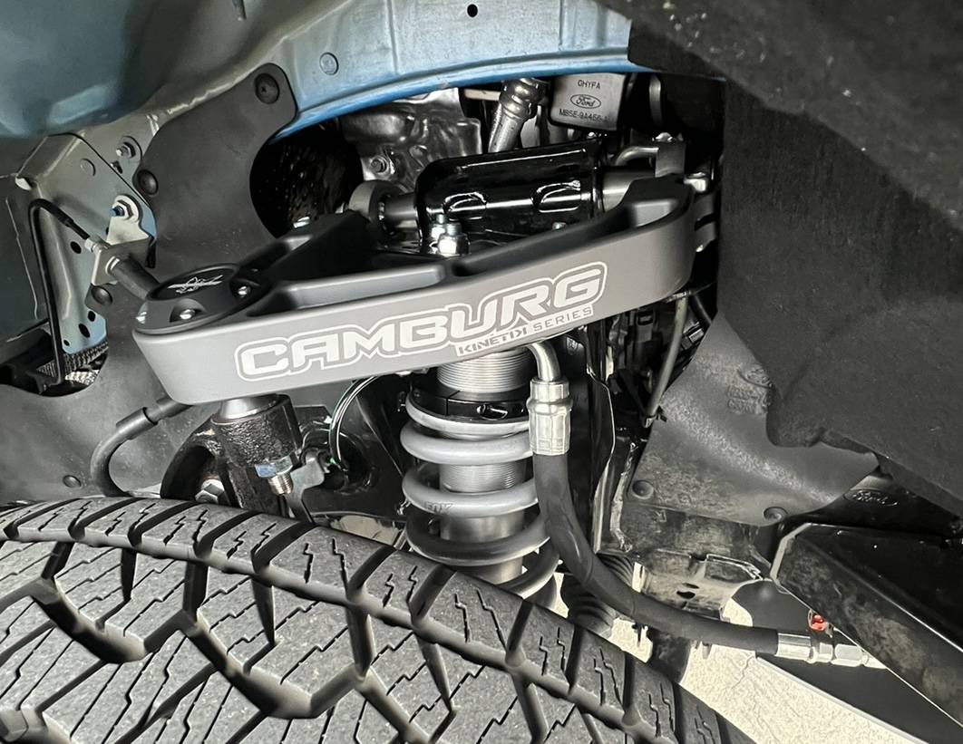

I’m still trying to figure out what lift kit this is and why there’s a backspace limit.

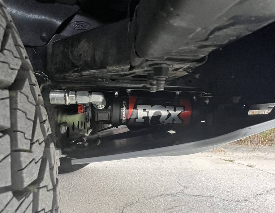

Actually it is my camburg kinetik upper control arms that have some specs in the instructions which are at house right now…. Lift is a Fox 2.5. 3”
