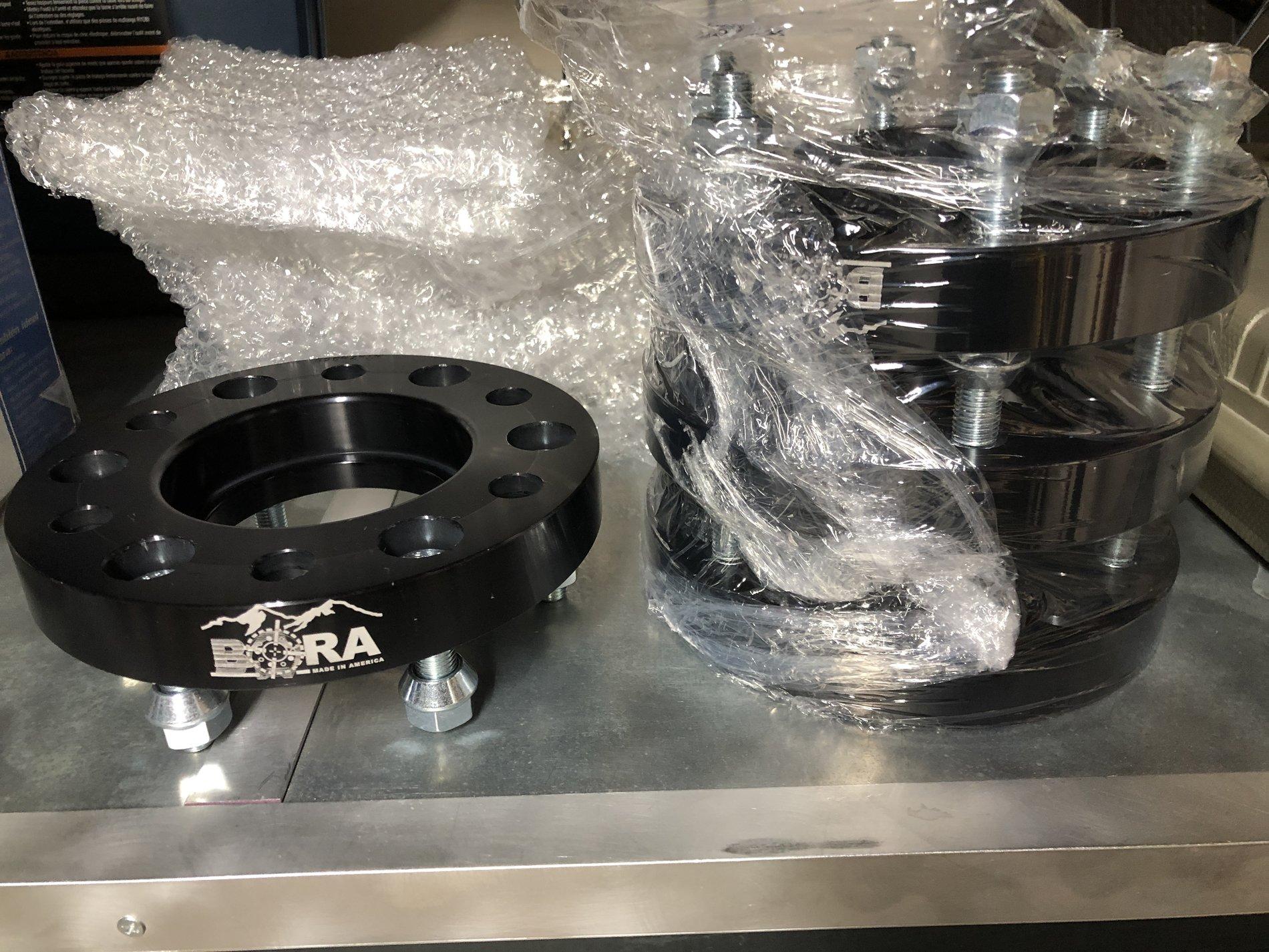

I'm no engineer either.... but I am curious (and hopeful!) as I just received my 1" BORA spacers.
I'm running BFG K02 LT 275/70R17 on the stock sport wheels. I have the 3" ReadyLift Level in the front and have had no rubbing/clearance issues to date.
I wanted the 1" spacers to move the tires out for a more "aggressive-looking" stance.
I hope after the install there are no rubbing/clearance issues? I should get the install done in the next week or two and will report back.

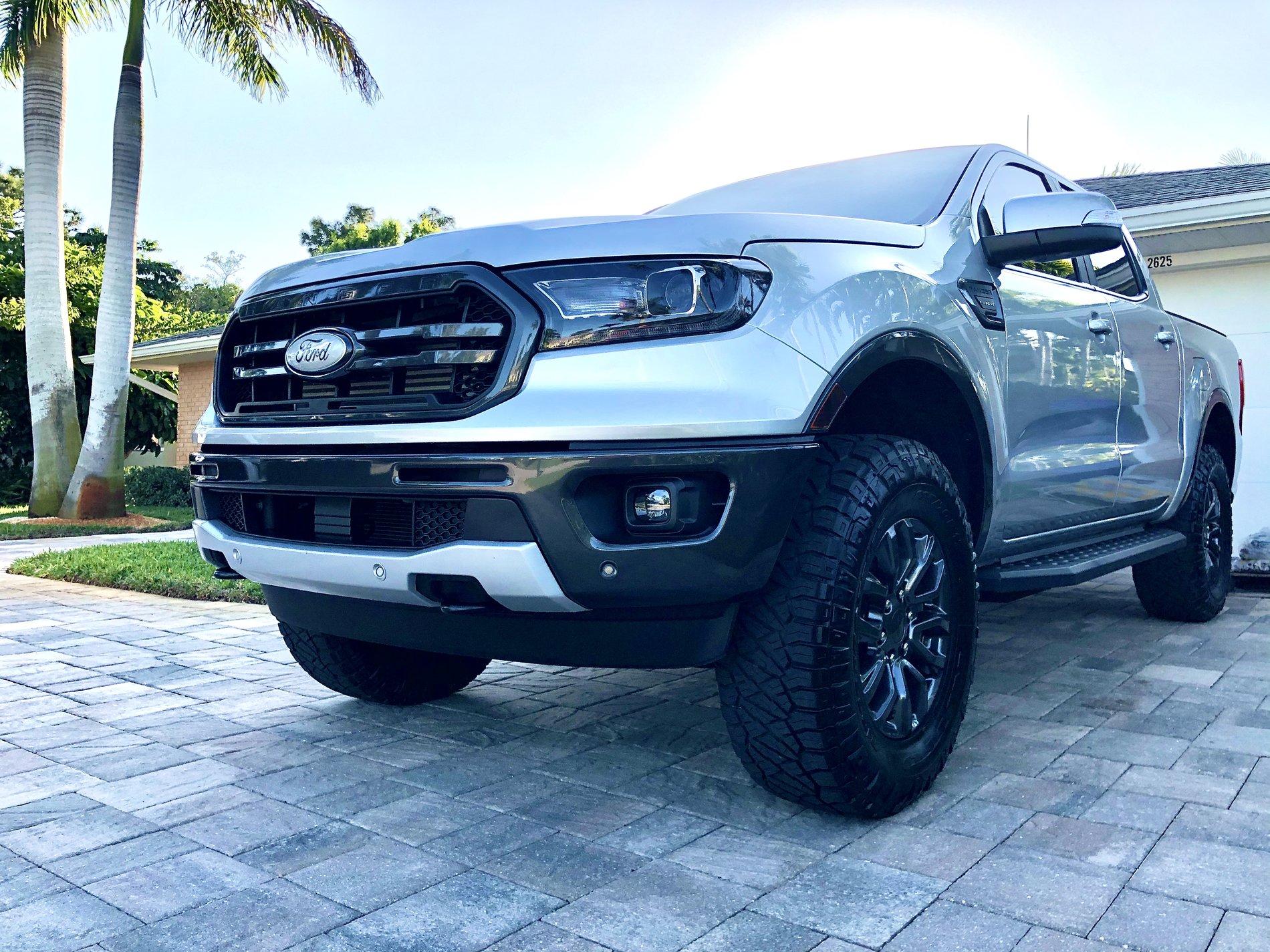

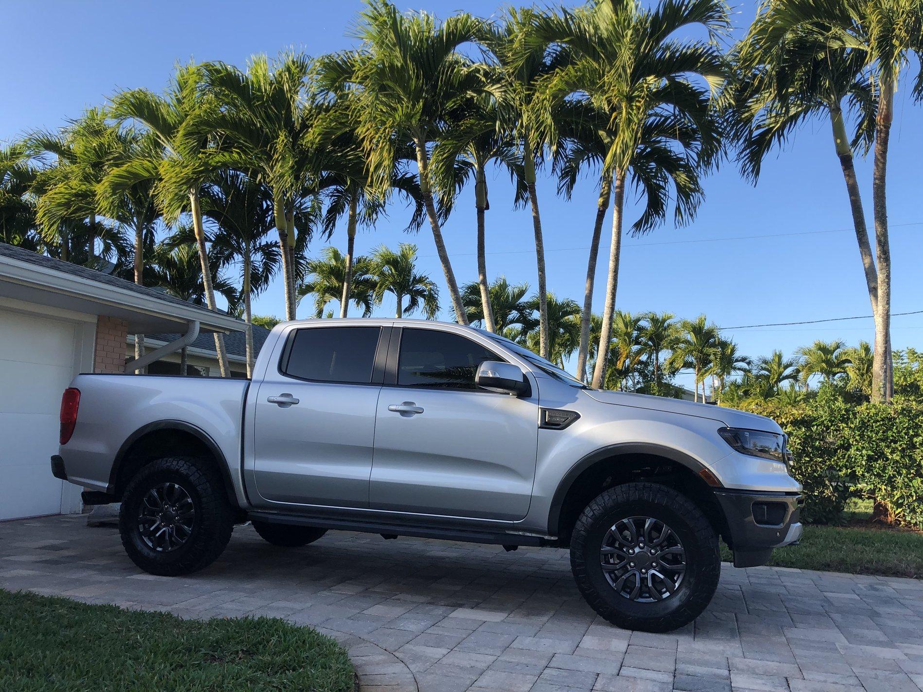

I’m running 1/4” spacers to fit 285/70/17 with zero rub even at full crank.
Perfect setup.
So my first question, which 1/4" spacers did you order?
Second question, what tire pressure are you running and if you've aired down for offroading has your tires rubbed at that point with the steering knuckle?
Third question, are the factory wheel studs long enough that you feel confident that you wont have any issues with your lug nuts coming loose or wheel studs snapping off?
