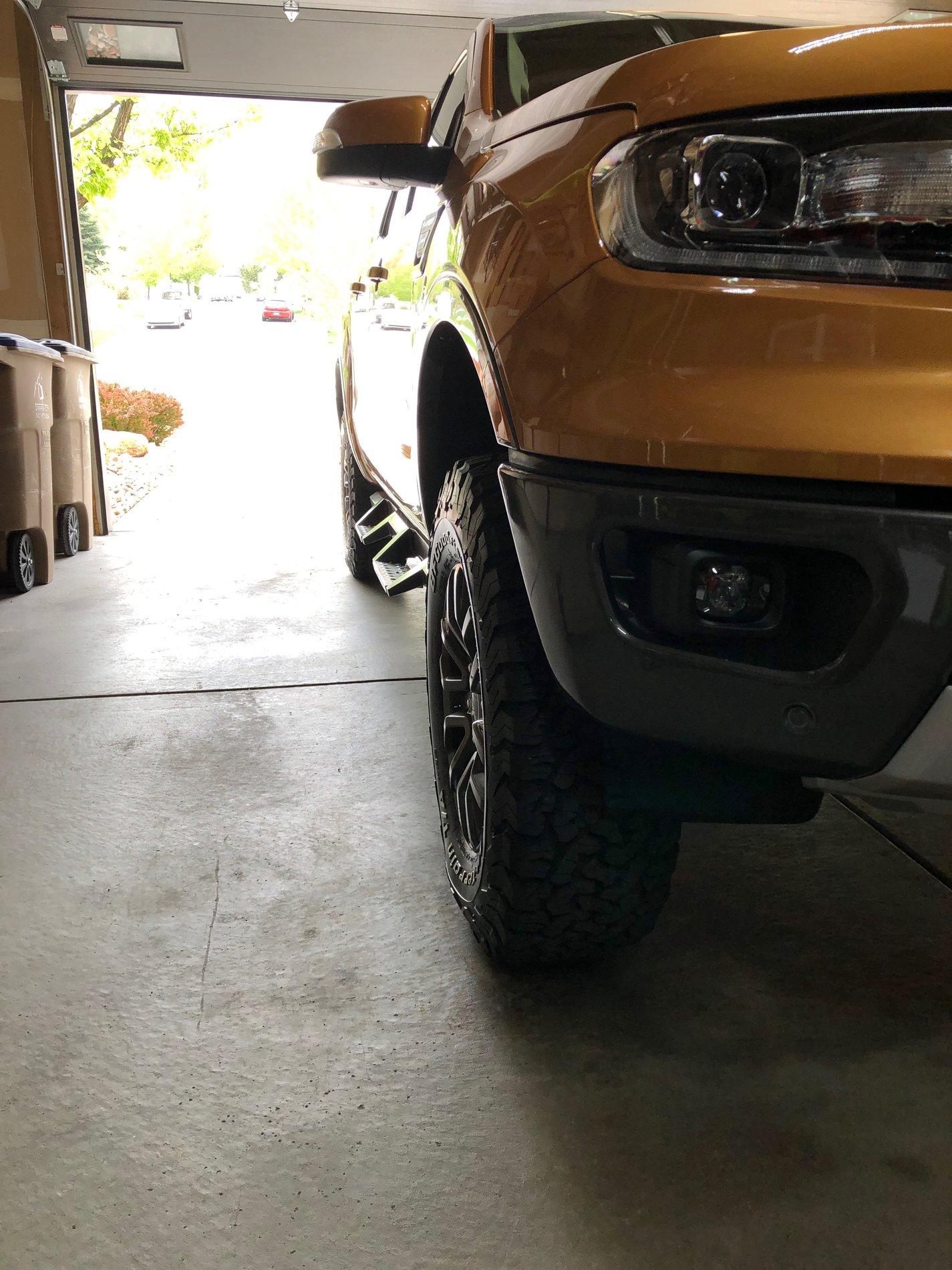

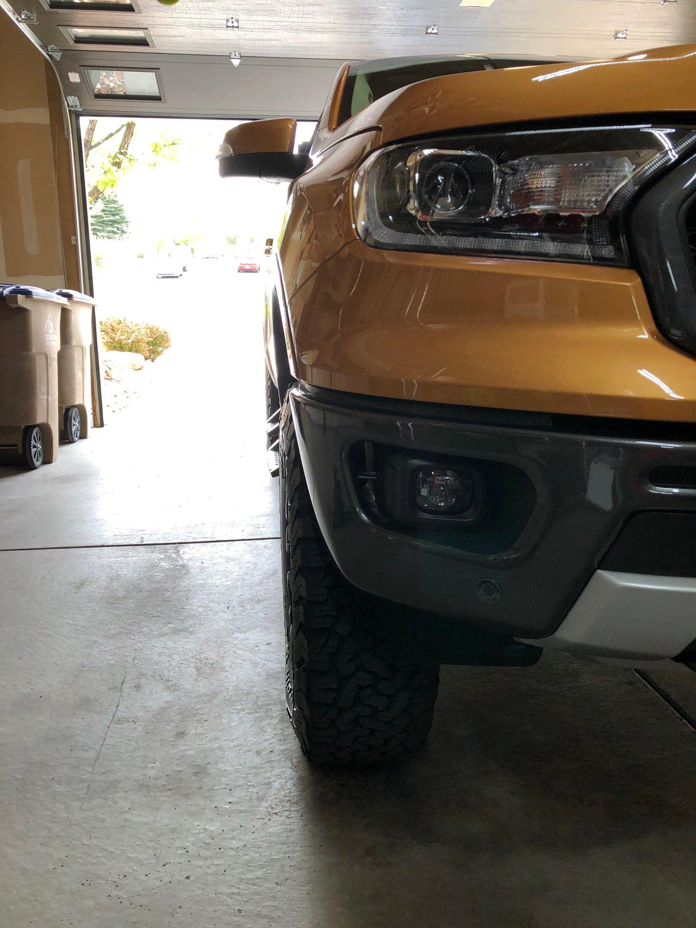

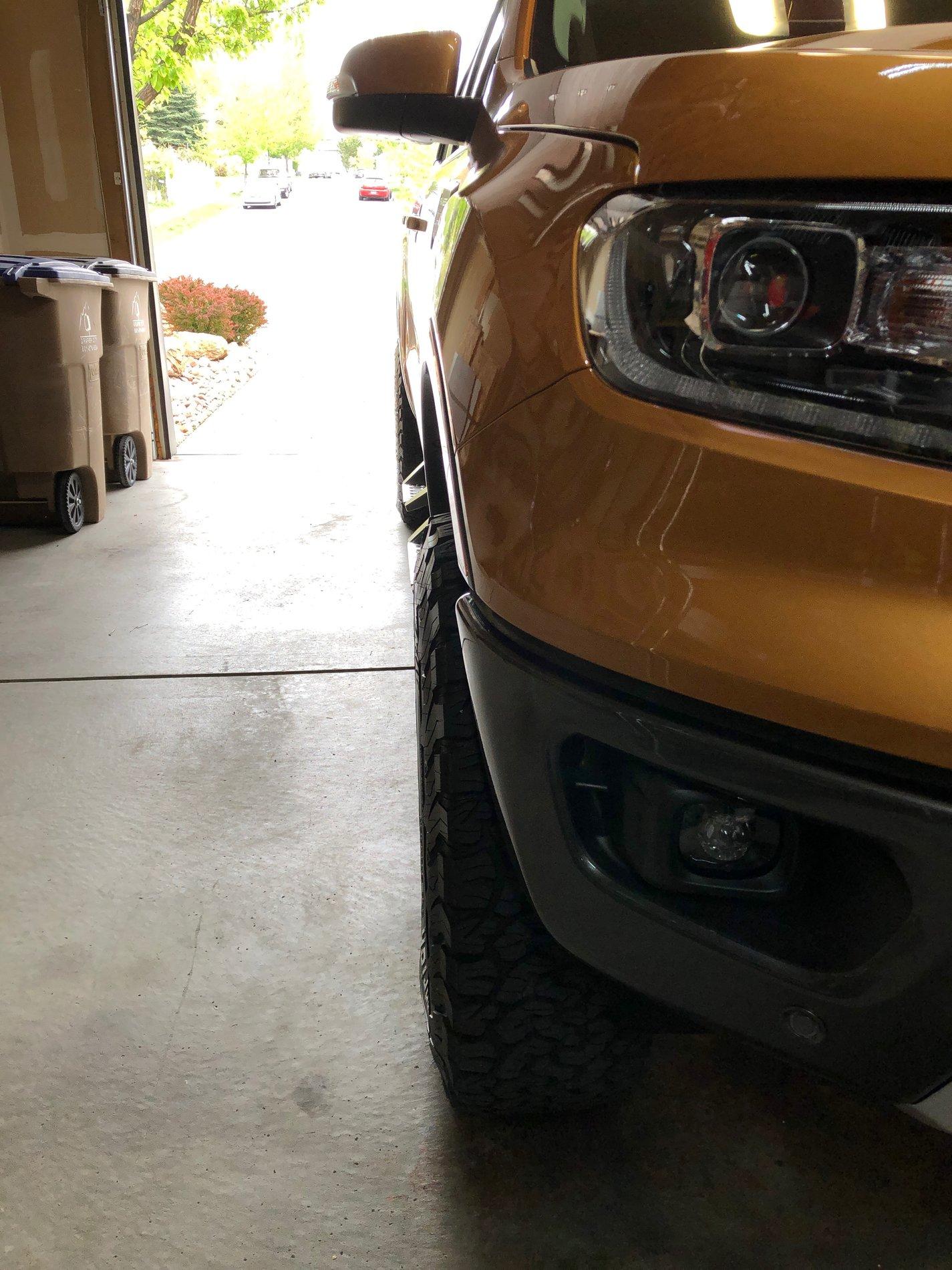

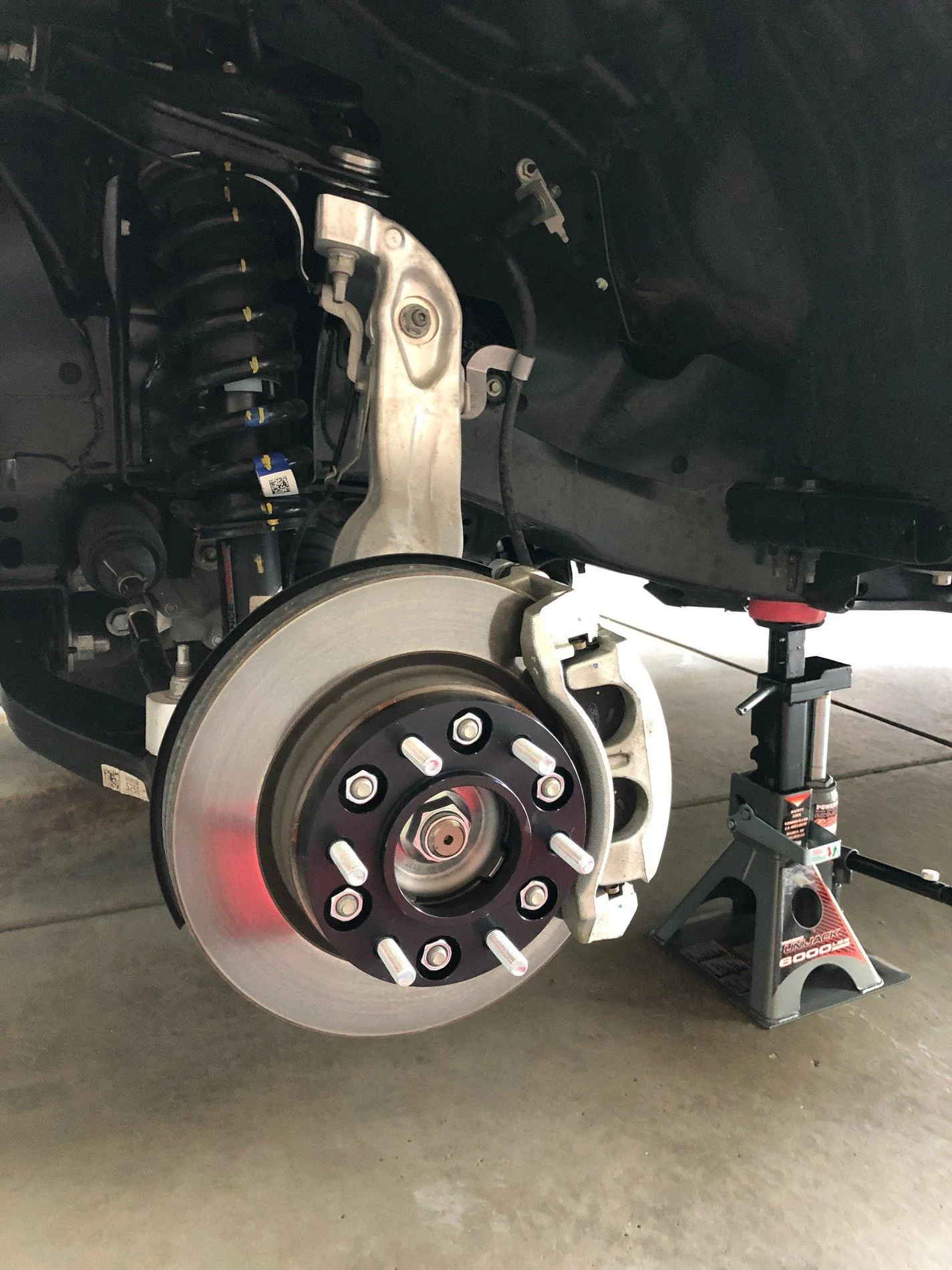

I Finally got around to installing my BORA 1” spacers on my stock sport wheels.
A little backstory….
I installed a 3” Ready Lift Level kit and BFG KO2 LT275/70R17 tires on my stock wheels right after getting the truck.
With this set-up, I had no rubbing issues so there were no modifications at all to anything, crash-bars, etc. I did the full-lock, left-right and forward-reverse on pavement…. no rubbing. Truth be told, it was REAL CLOSE at full lock, especially front crash-bar drivers side, full-lock turned to the right.
Over the Winter, I did a little off-road and a lot of snow driving but no rock-crawling or anything too crazy…. again, no rubbing issues at all.
I wanted a bit “more aggressive” stance, so I purchased the 1” BORA spacers directly from the manufacturer MotorSport Technology.
It took a few weeks to get the spacers (I think they make them to order?), but they are top-shelf quality. The fit & finish is perfect!
I installed the spacers and rotated my tires at the same time.
Here are a few pics:
Install was easy, as you can see, the spacer lugs are tucked into the spacer so the mounting surface for wheel is flush, no trimming of the studs:

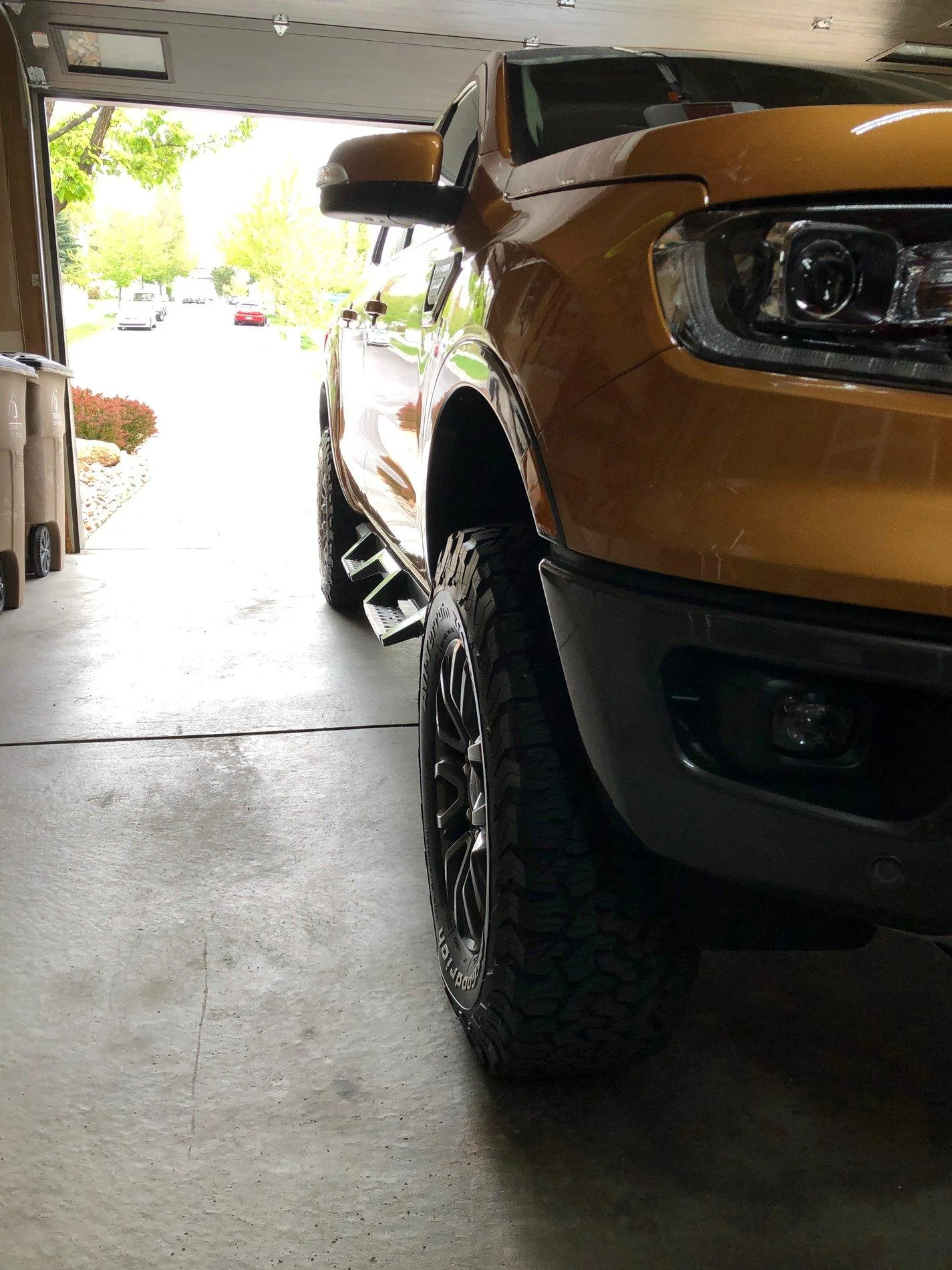

Before Spacers:
After Spacers:
Another angle before spacers:
And after spacers:
After the install, I took my truck back up to my local parking lot for the full-lock testing. With the new spacers, I had just a little rubbing at full-lock, wheels turned to the right on the drivers side only. (not sure why pushing the tire/wheel out 1” created a rubbing situation?)
Upon closer inspection, on my truck, it appears the passenger-side front crash-bar was positioned about 3/8” forward. This gave more clearance compared to the drivers-side front crash-bar, thus the rubbing. (you'd think they'd be the same from the factory?)
So back home to remove the drivers-side tire/wheel. I loosened the crash-bar and pushed it forward, as far as it would go, about 3/8”. Tightened it up and went back to the parking lot AND ALL IS GREAT.... NO RUBBING!
The spacers do give much more clearance inside (knuckle, etc.). I don’t know if the 3/8” clearance at the front crash-bar is going to be enough in some hard core off-road settings? There is a lot of room at the rear crash-bars, so no issues there.
I am very happy overall with the stance of the truck with this set-up.
Cheers! ?

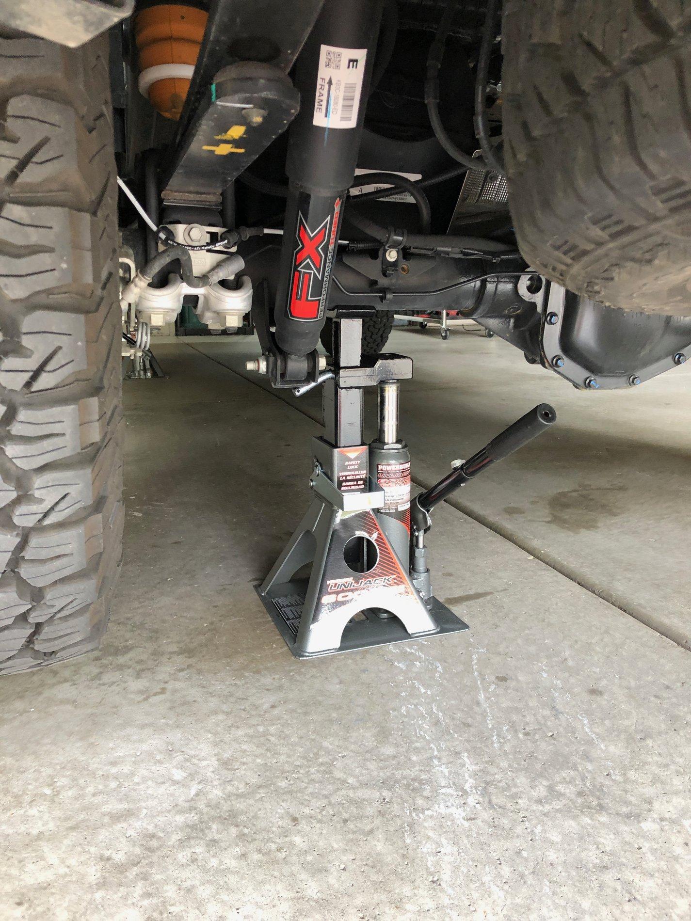

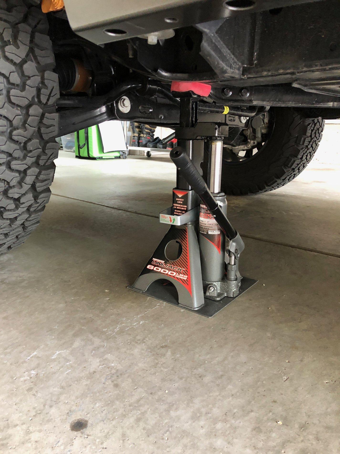

how high does that pump jack/ stand raise? Been looking for a combo like that
Hey Matt,
It's the UniJack 6000.... 6000 lbs capacity and lifts from 11-21".
I bought 2 of these and they are great.
I use a hockey puck (it's red in the picture) on the front jack point (to flatten the cradle) and use the cradle (fit perfectly) on the rear axle jack point.
When I use the jack, I raise it far enough to get the tire off the ground, then set it down on the jack stand lock so the truck is not supported by the hydraulics. (not sure if this is better/necessary, but it's rock-solid)
I store one of these in my storage box in the bed to use as my jack if I ever need it for a flat tire and/or emergency.... WAY better than the factory jack!
Here's where I got mine, bought them online and got 25% off instantly and picked up in the store:
https://www.pepboys.com/powerbuilt-6000-lb-unijack/product/633527?tab=tab4

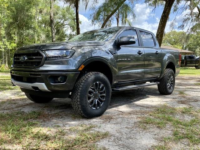

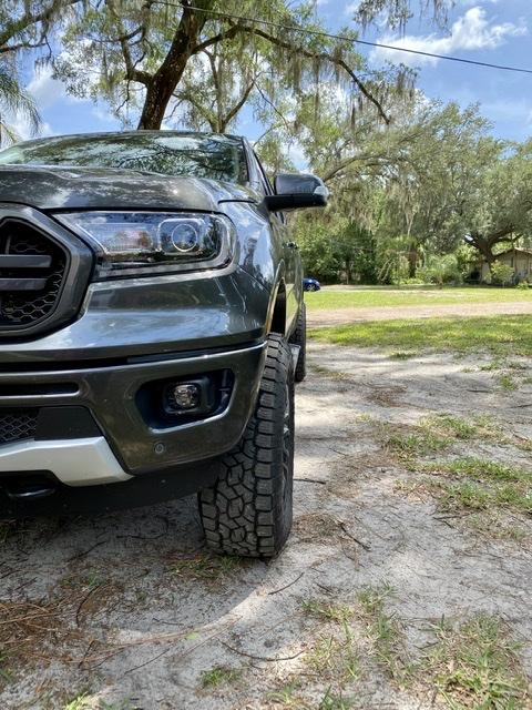

Side view? I am trying to pick a tire size and 275/70/17 is my first choice. I am interested to see how they fill up the wheel well on your truck.
mobilemike01
Sep 14, 2019
Tampa, FL
Ranger Lariat

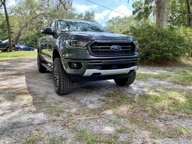

1.5” spacers on 265/70/17 tires and stock wheels. Rubs slightly on reverse and when pinned. Ordered the smaller crash bars but pretty sure they are on back order right now.

Thanks! I completely forgot I saw someone mention that here! I’ll give it a shot! Is it just the bolts on the bar themselves or do I need to loosen the bumper too?
thanks again!!
