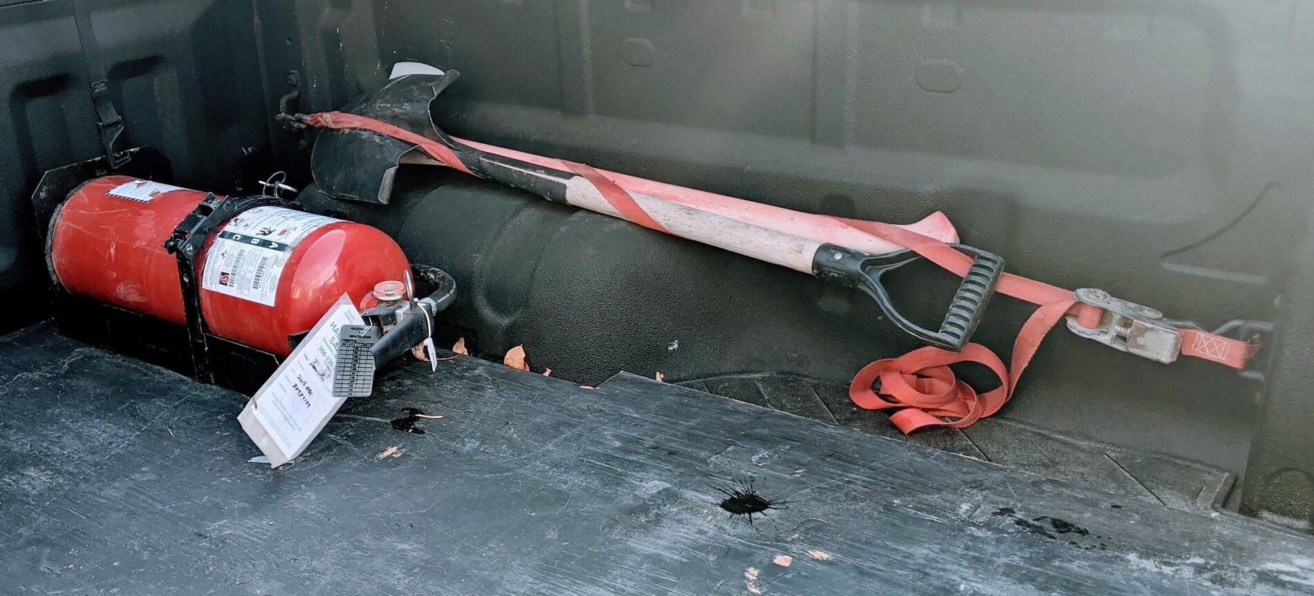

I know it's not sexy at all, but I just use a rachet strap. I wrap a couple or three winds around my shovel and axe handles, with the strap hooks in the front and rear tie down loops. I do like KnightRanger's system, though!
(The fire extinguisher carrier is bolted to a sheet of 5/8 ply painted black that I migrated from my Titan. Axe, shovel, and 20 pound extinguisher are required by work, extinguisher too tall to sit upright under a tonneau cover...)
