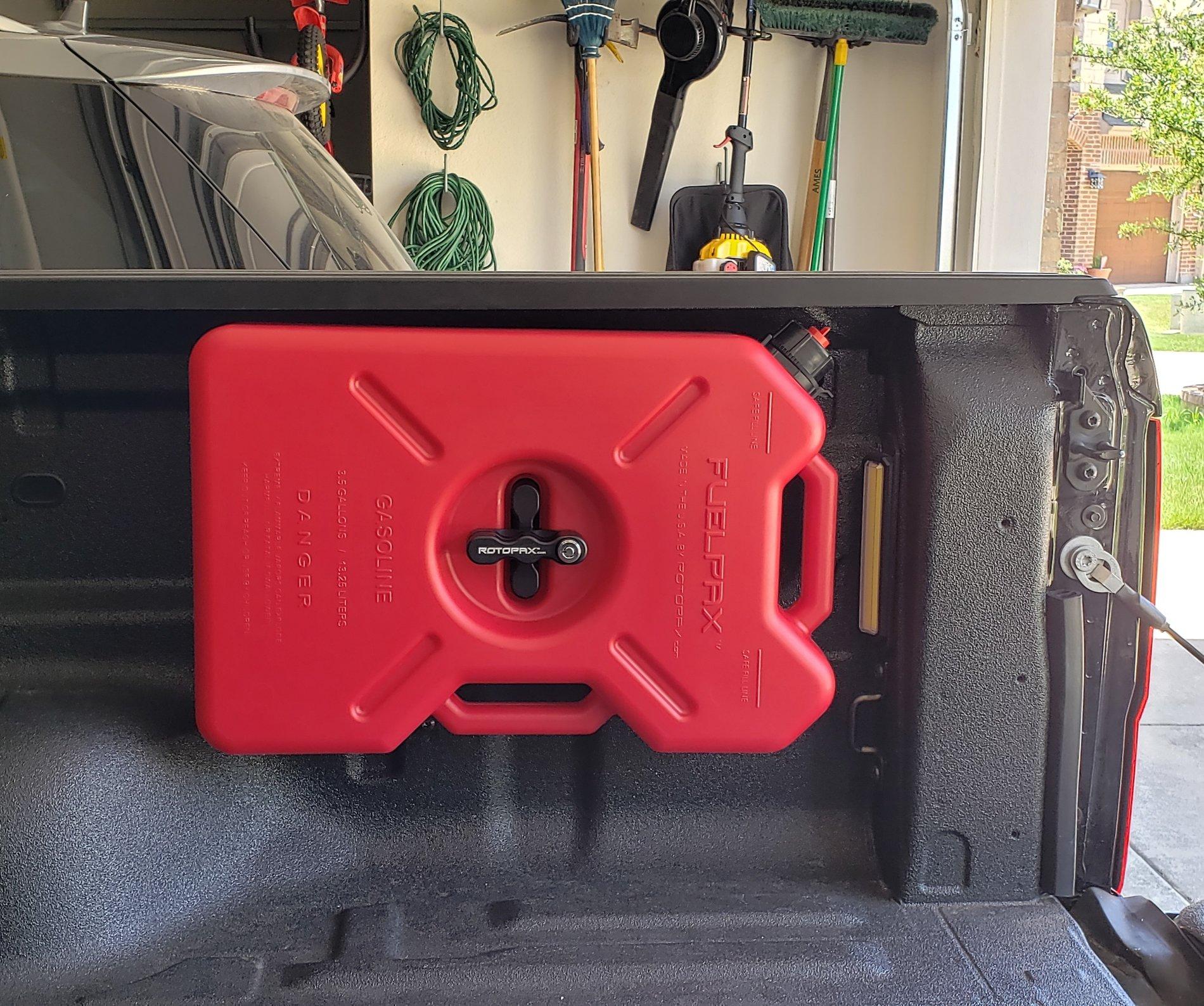

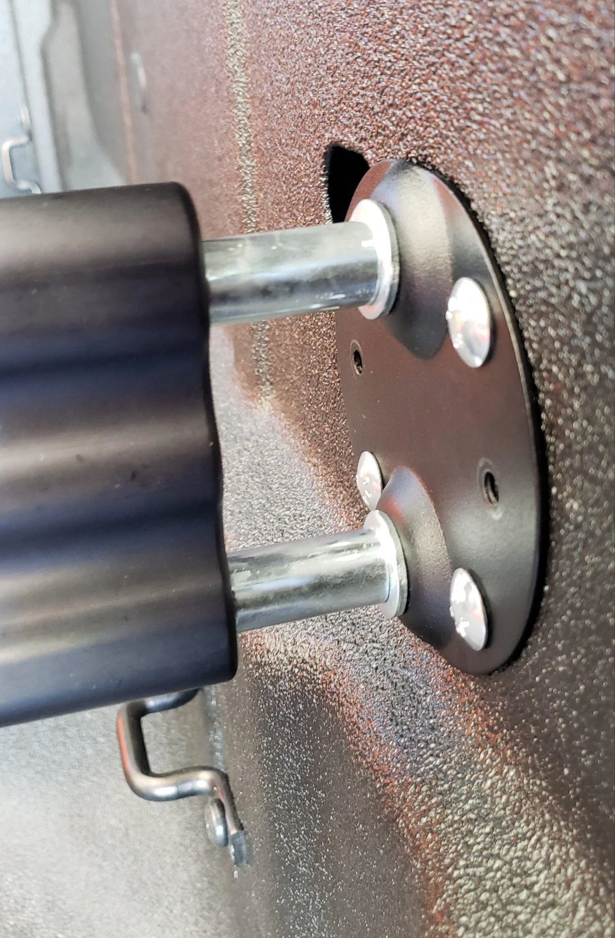

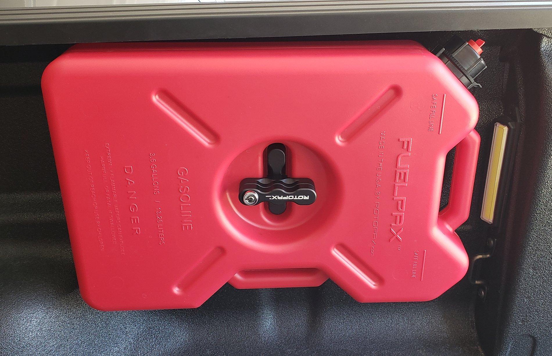

Installed a Rotopax spare fuel tank today in the bed. Hardest part was tightening the nuts from the backside of the sheet metal. It's a reach but doable. I had to install some 3/4" spacers to make it work for the recess.

I might just end up removing the bed anchor..

Is there a backing plate on the outside of the box inner sidewall. If not you might need to inspect from time to time as others have experienced sheetmetal cracking in this area.

A rivnut does not solve the stress concentration issue...In fact it may aggravate it. It is purely an access device where you do not need a loose nut to secure the bracket but it still lacks a backing plate. So rivnutting the Rotopax bracket leaves you with the same possible sheetmetal cracking. The stress of the full of fuel Rotopax needs to be distributed over a large surface area of the sheetmetal.

Yes....2020 deleted the middle tiedowns as a cost reduction. Much to the dismay of many Ranger buyers. Stupid decision JMO! There were a few forum members that mounted gear on this side wall only to find out there was a flexing and cracking around the mounting holes. If you sandwich a plate behind the bracket, thus trapping the box side sheetmetal, you help distribute the loading of the Rotopax or other devices you may choose to mount. Even if you use fender washers behind the bolts before the nuts are threaded on, you have made a large difference in stress distribution.

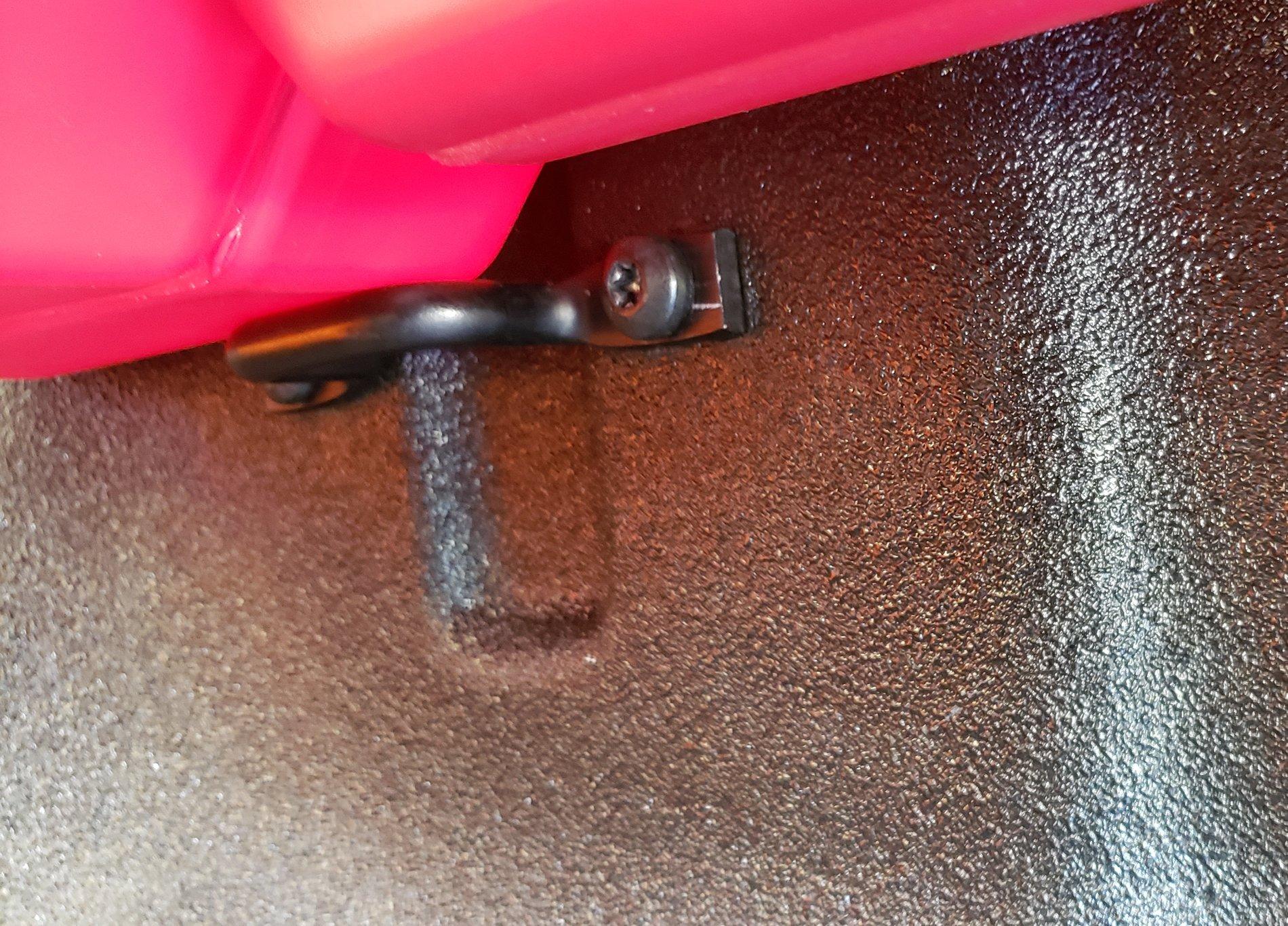

I used large washers behind the sheet metal on the bolts. Plus it just happens that the bottom of the tank rests on the other hard mount. Hopefully this is enough to avoid any problems.

I had to buy longer bolts and also used some spacers between the base plate and the handle. I got everything from Tractor Supply to make it work.
Make sure to use washers on the back side before you put the nuts on like Phil said above. It's a bitch getting your hand up there. But with a buddy holding the bolts from spinning its doable.
