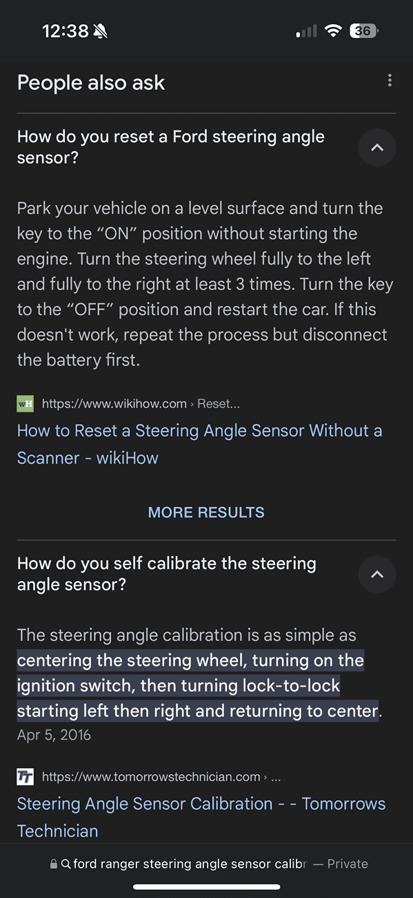

After replacing the battery, some systems may require some drive time to relearn the positions of some sensors like steering, likely using something like Forscan you may be able to force learn it quickly, but if driving it will work it's worth a try. The alternative would be in the future when you replace the battery, find an alternate way to provide +12V to the system while the battery is removed so that no module gets reset, just be very careful with that +12V terminal while it's loose. With all the computers in modern cars, avoiding disconnecting the battery unless you need to do to the work you are performing requires no power to the rest of the truck is the best plan.
I haven't had a chance to take it for a drive since replacing the battery, Ive been in my work van ever since. I'm hoping to get time to take it for a drive today.
I did watch some videos before replacing the battery and I seen someone had placed a 12v trickle charger onto the terminals to keep everything alive, I was more afraid I would hit the clips off something while pulling the battery out. I wish I had done this now!
Yesterday I disconnected the battery again for 30 seconds incase something didn't start up correctly, after doing this I opened forscan trying to find if there was any angle sensor reading option to be found but I found I had a DTC which I didn't have before or after replacing the battery, it was U3003 for 'circuit voltage below threshold' for the power steering control module which I found fishy. I reset the DTC's and it's not come back the few times I've checked. I'm assuming I brought this on by disconnecting the new battery for 30 seconds.
However today I had a thought to check if the reversing camera guide lines would still turn when the steering turns and it does not! The lines stay completely in the centre nomatter what angle I turn the steering wheel to!
Is this something that hopefully self calibrates as driving and taking corners?
I never had this fault before until replacing the battery where the leads were disconnected for maybe 10 minutes?
I see a section for rebooting modules and the Power steering control module is listed, would that be worth doing?

When your ASS was working (?? I have a low threshold for humor and entertainment?)
Did you notice if the wheel had firm tension on it or did it feel kinda loose?
I think there are two steering related notifications angle and maneuvering..
Which makes me think angle sensor (obviously for angle) and steering torque sensor (steering maneuvering) it doesn’t read the input correctly from the driver and thinks it’s a yielding turning situation disabling the ASS function. (the individual I read this from was actually in a ford fusion so that may be different.. also their problem was multi faceted as the power steering system was having issues as well the torque sensor issue.)

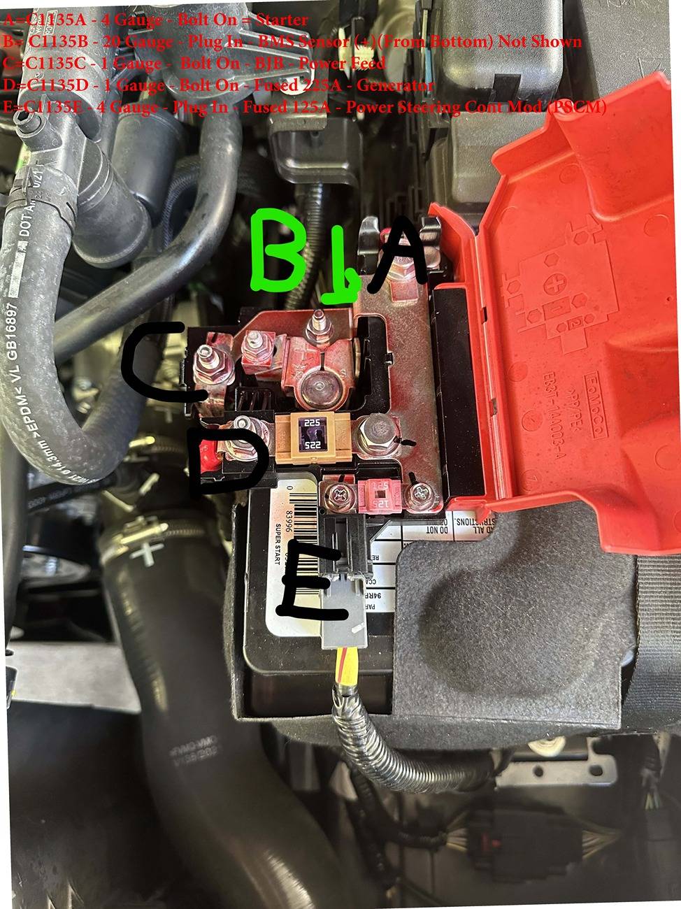

You are on the right track, clear the code and perform a PSCM Self-Test, the code should clear.
But you may want to check the Fuse to ensure it is secure and not blown.
Ref Item (E) - Fuse 125 Amp and the Connector - this feeds the PSCM, ensure connector is properly secured.
I should add that with these (Fuse Link) fuses sometimes it's hard to visually see that they are blown, so a meter helps or remove it and ensure you cannot pull it apart
Ref Pic Below:
