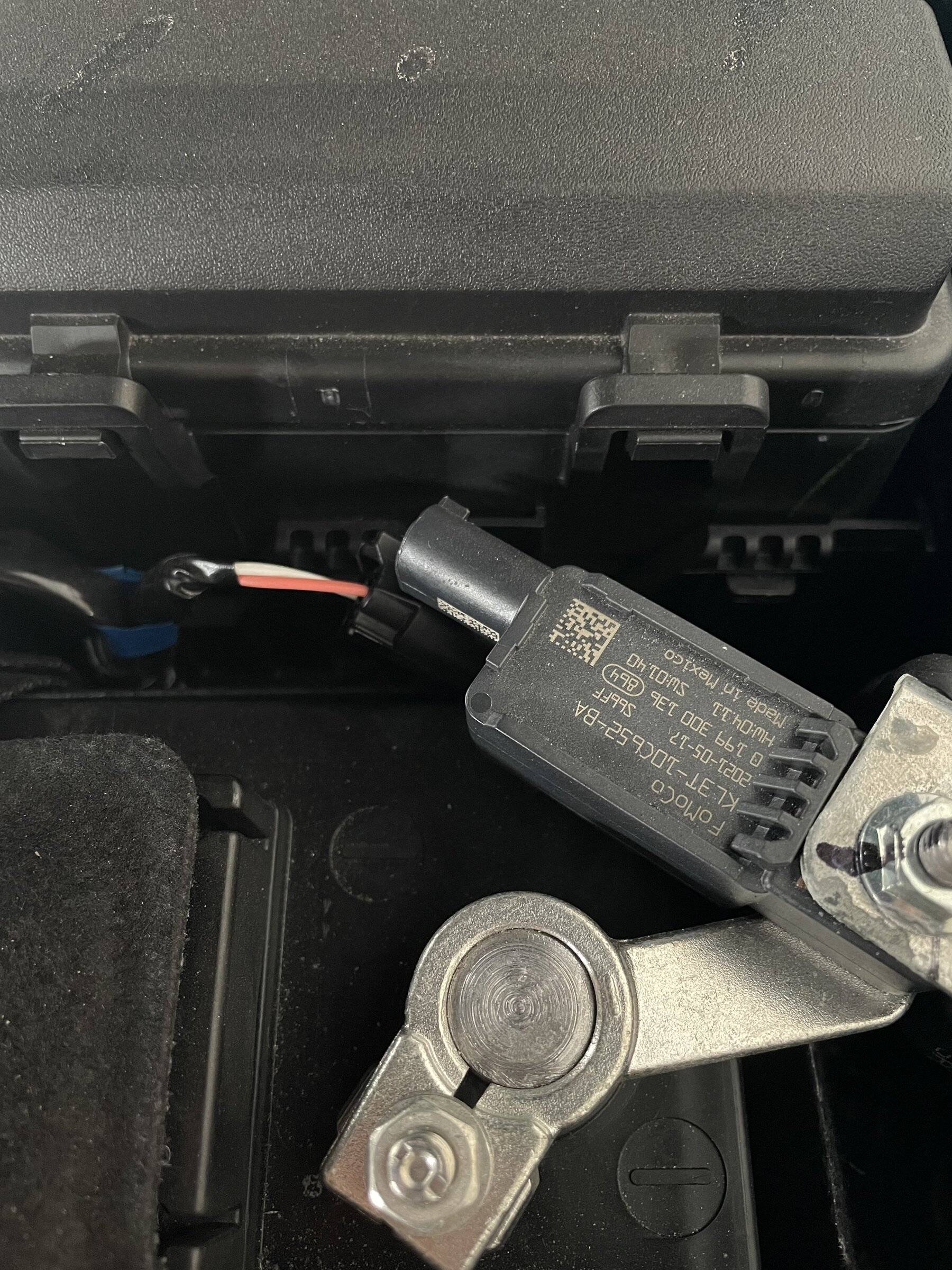

disconnect plug from battery… no more stop start. Also no warning messages. Start stop feature can’t tell if the battery is charged so it just doesn’t work.
