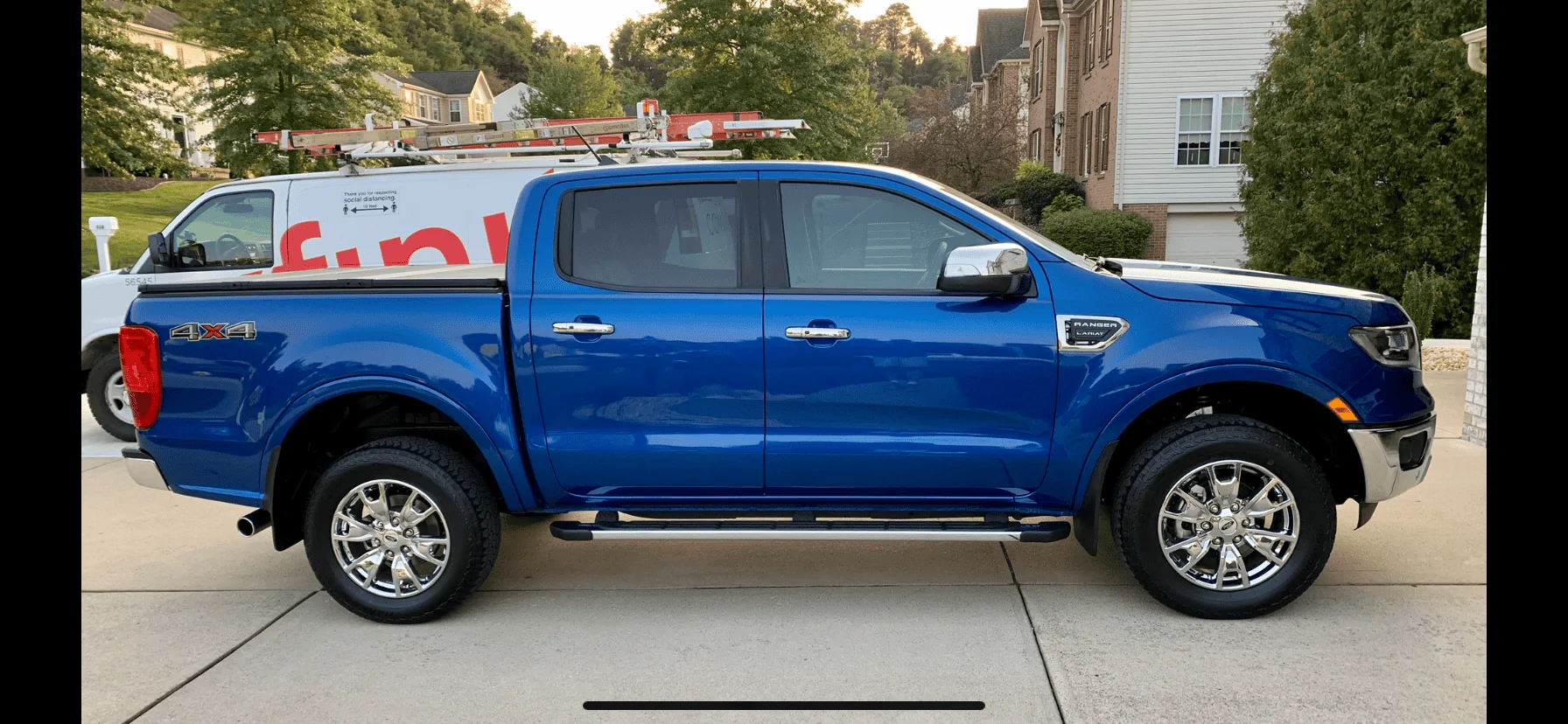

Hello, my name is Rich and I’m new to Ranger 5G. This is my official first post. I have been spending some time looking around the site, and I’m looking forward to sharing topics on the forum. I just bought a 2019 Ranger Lariat off lease in September and started to do a few upgrades. I was reading about the auto folding mirror module and would really like to install this on my truck. Do you know if these mirror modules are still available and where I can order one from? Has anyone installed one recently and know if they work with technology package and remote start trucks? I would love to get my hands on one to install.
