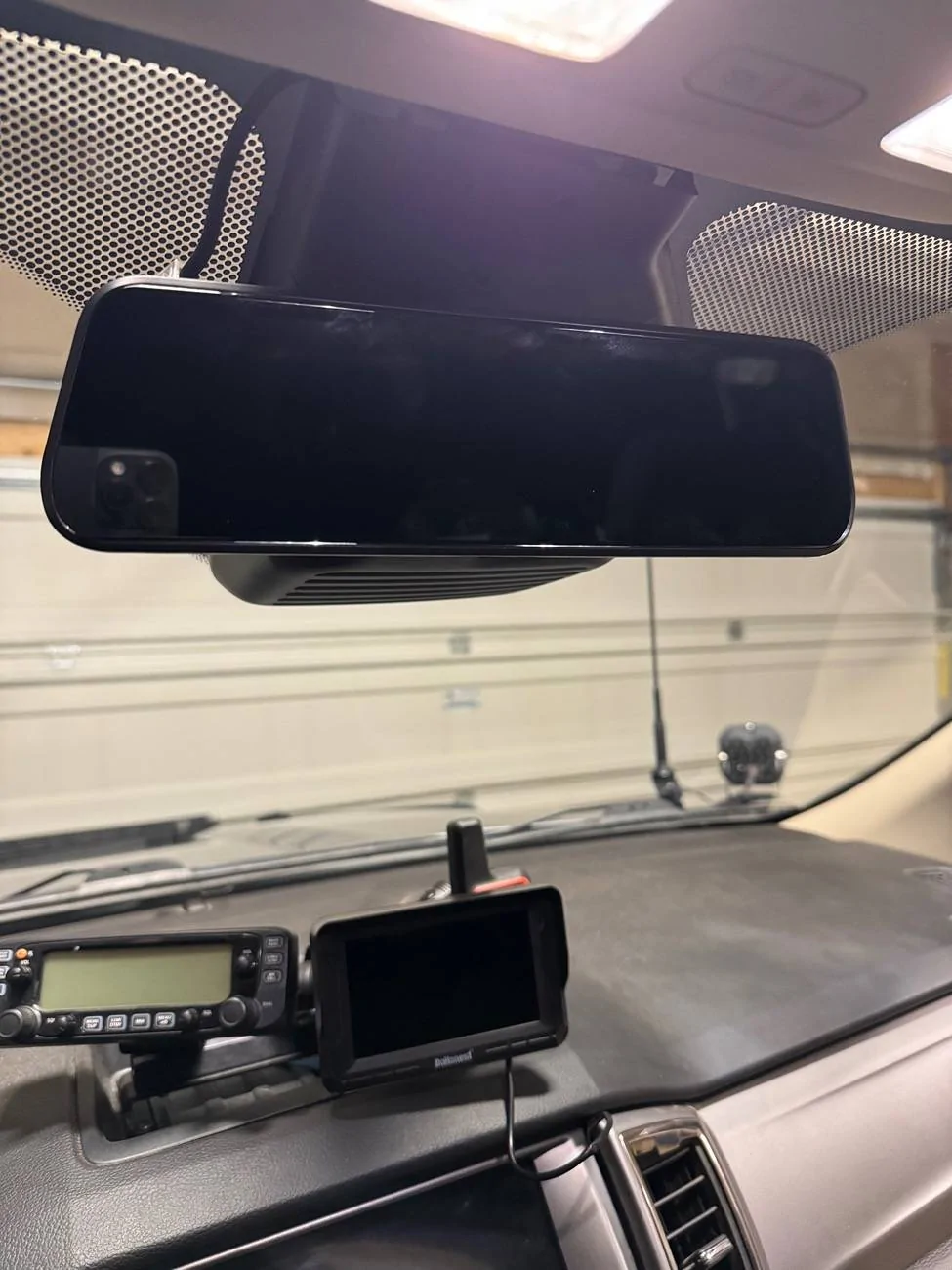

Does this plug into the mirror and the Wolfbox?
Yes. The 'male' connector of the Dongar adapter plugs into the OEM mirror power connector and the female USBa supplies power to the Wolfbox via a short male USBa to male USBc cable - Wolfbox has a USBc socket.

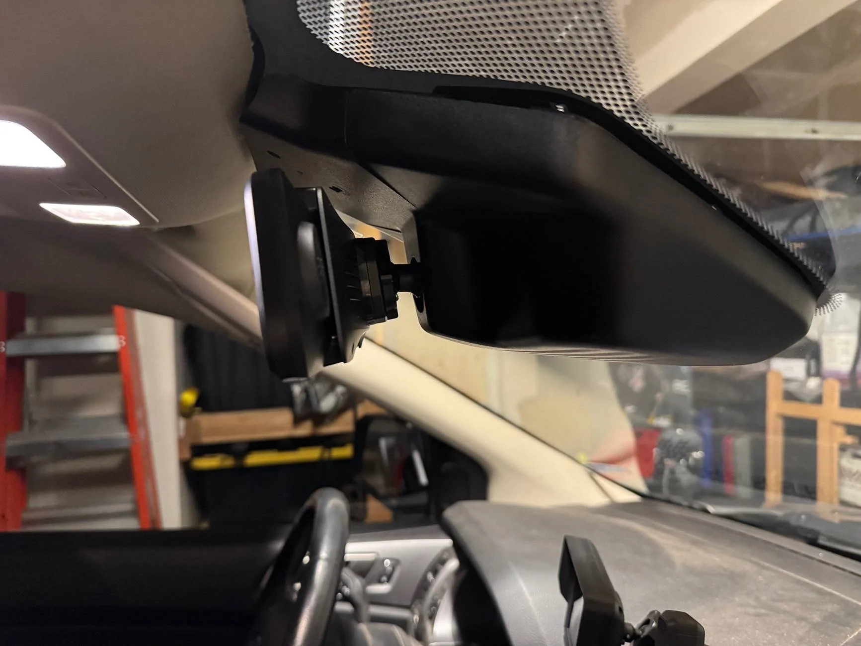

I used the OE mirror mount today to mount my Wolfbox G930. I had to buy the Wolfbox OEM mount. The ball on the mirror is about 2mm smaller than the ball on the mount from Wolfbox, so I used a rubber 3M piece to use as a spacer. I am working to wire it up, but that's going to have to wait for the Donger adapter. The camera probably wont mount until I buy the wire extension, since I have the topper and it has to go to the back. not sure if I am going to mount it to the topper or the license plate.

You have to absolutely mangle the OE mirror, which will not be able to be reused. There are two metal hoops that give the OE mirror tension and I had to cut them off.
Yep. I bought salvaged mirror from an Escape on eBay and tore it apart to get the mount out of it.

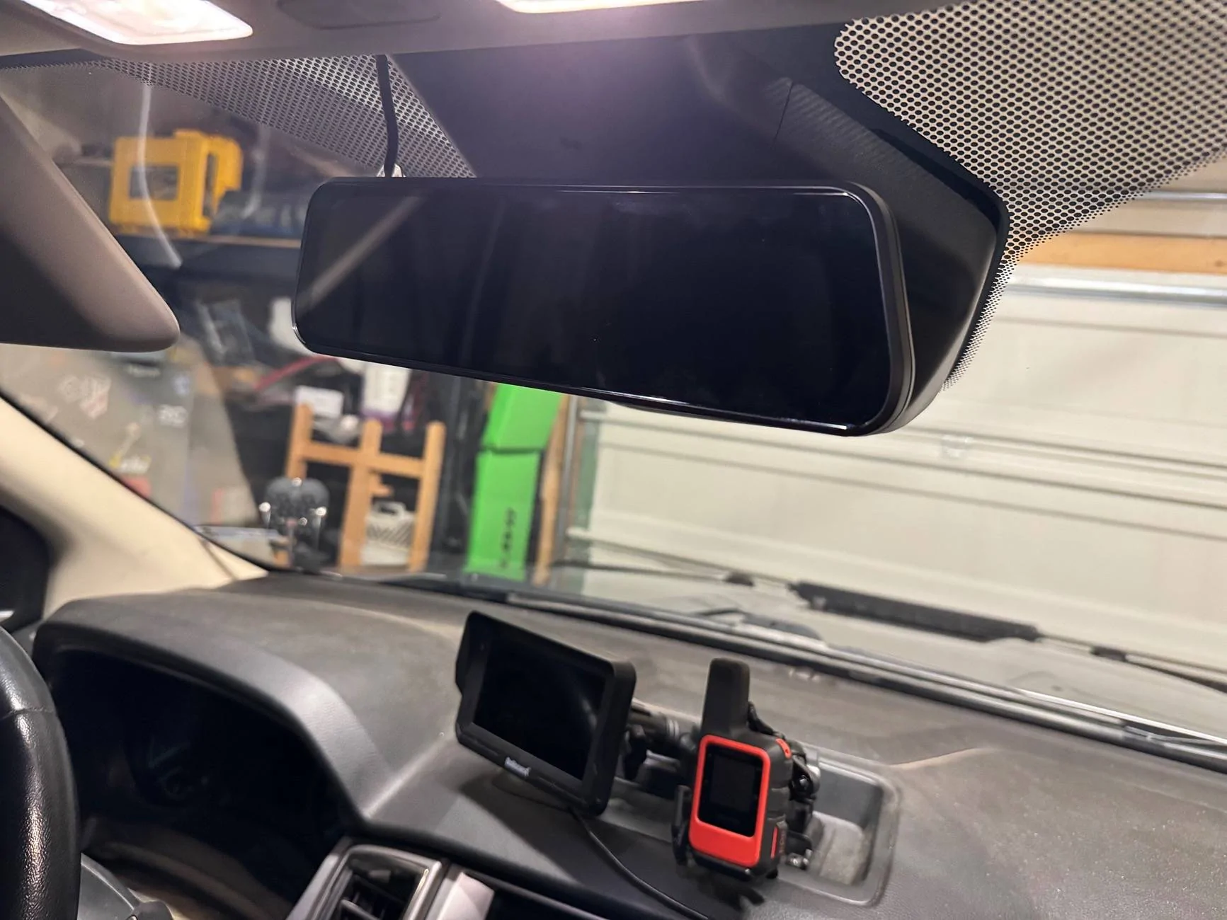

if you want to use the parking feature (not sure they have it, Cobra does) you will need a constant power source from the fuse box, if not, as Colo_Ranger said, an adaptor behind your rear view mirror works great, I have been using one since 2 years and it works as long as the truck is on.
