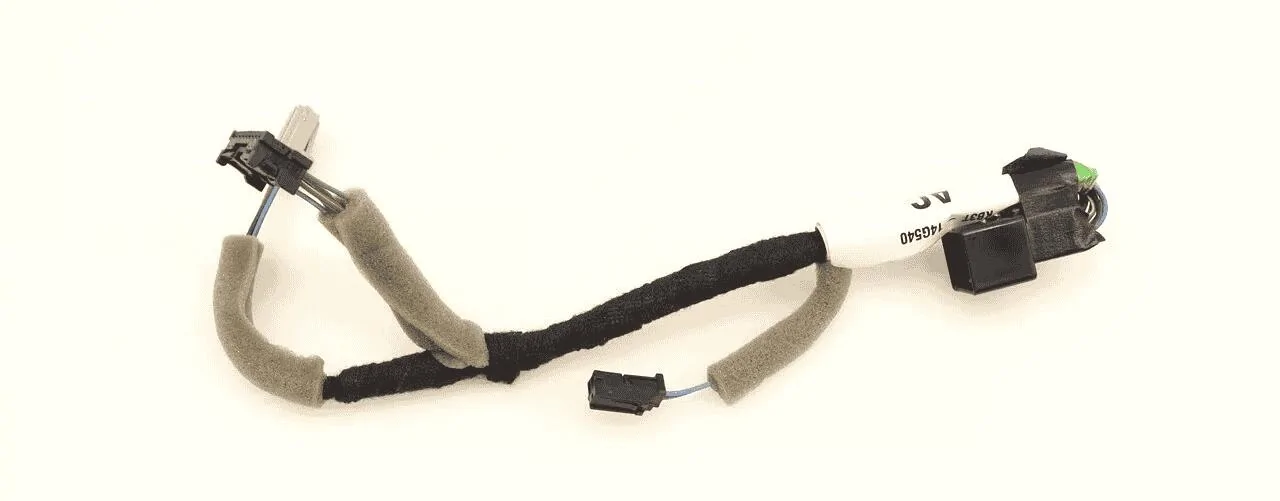

Harness:
PN: KB3Z-14A411-D (With - Rain Sensing Wipers)
PN: KB3Z-14A411-C (W/O Rain Sensing Wipers)
If you do not have rain sensing wipers either one will work, just an extra connector for the harness.

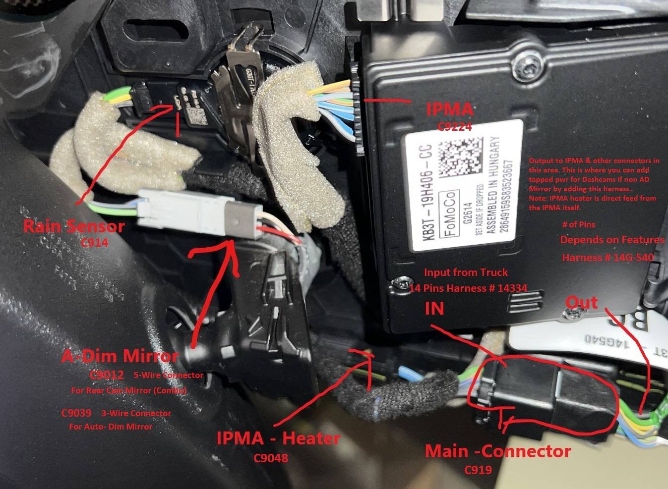

KB3Z-14A411-C
4-Total Connectors
Main
Auto-Dim Mirror
IPMA
IPMA Heater
This Part Number (If Rain Sense is Installed) KB3Z-14A411-D
5-Total Connectors
Main
Rain Sense
Auto-Dim Mirror
IPMA
IPMA Heater
So, there are other part numbers for this harness - The (-) number will change.
and it depends on what options are available.
Your Harness will not have anything for the mirror.
Then if you have the (Rear Cam / Mirror) combo where the Rear Cam is displayed (within) the mirror vs the center screen then the harness will have a (5-Wire) mirror connector vs the (3-Wire) to add the video feed (+ / -)
The (Key) important factor is to verify that the (INPUT) of C919 has the Power Feed for (Auto-Dim)
So far lower trim levels have shown that the wires are there and just (Terminates) at that junction of the (Harness-Split) - This is where you can just add the proper (Harness) to extend that terminated connection over to the mirror.

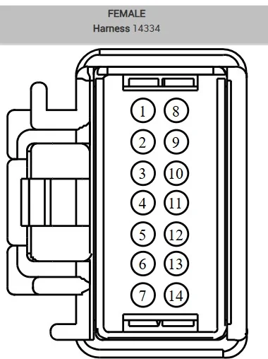

C919 - Input
Cavities - Need to have the wires:
Cavity #2. - Power - (Fuse-36)
Cavity #13 - Ground
Cavity #3 - Reverse Signal (Input)

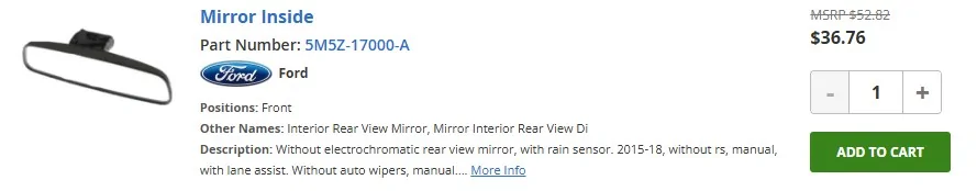

Mirror PN:
You Manual Mirror

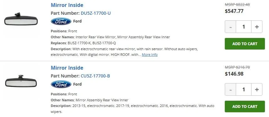

Auto Dimming: Mirrors
The higher priced mirror is the (Rear View Camera / Mirror) Combo - Hence the Price for it.
This is where the Rear Cam Displays withing the mirror instead of (Sync) screen so the (non-sync) version:
You want the ($146.98) mirror
You can pick these up on Ebay fairly cheap, just ensure it is the (3-Wire) connector and not the (5-Wire) connector - the 5-Wire is for the expensive mirror.
Do not get caught up in the (nomenclature) of the description as Rain Sensing appears to be included in most of those, Rain Sensing has no effect on the mirror itself, the only factor is the harness (includes) that connector or it comes without it.
I need to dig to be sure, but it appears that there is no (As-Built) settings for this, so as long as you have the wiring going into the C919 connector then all you need is the harness and the mirror.
The mirror assembly (itself) has the sensors (light intensity) to perform its features. The reason for the (Reverse) Signal on these is to let the mirror (Disable) the dimming feature when in reverse.
