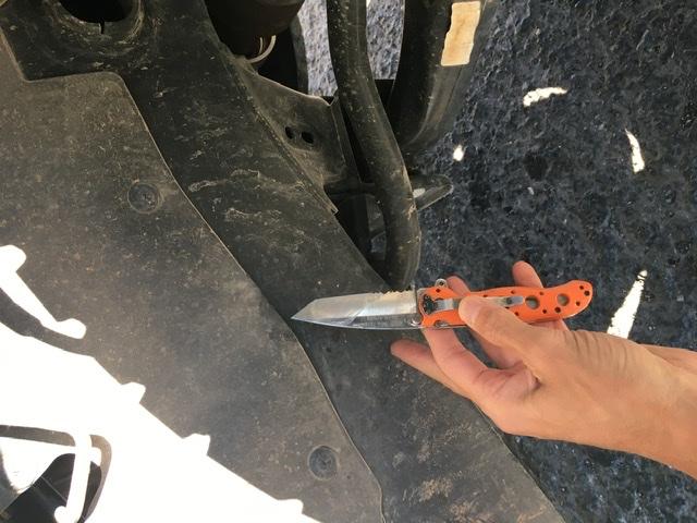

minor update: after a thousand miles and some off-roading we noticed a brief light rub in full right lock passenger front tire.
this was caused by the edge of the tire lightly catching one of the plastic panels inside the wheel well. notching it stopped it with no functional change to the panel.
(knife points out the spot before i notched it. photo is rotates 90deg ccw for some reason)
we’re still very happy.
just updating bc a lot of people want to be sure you can run these in a stock vehicle.
