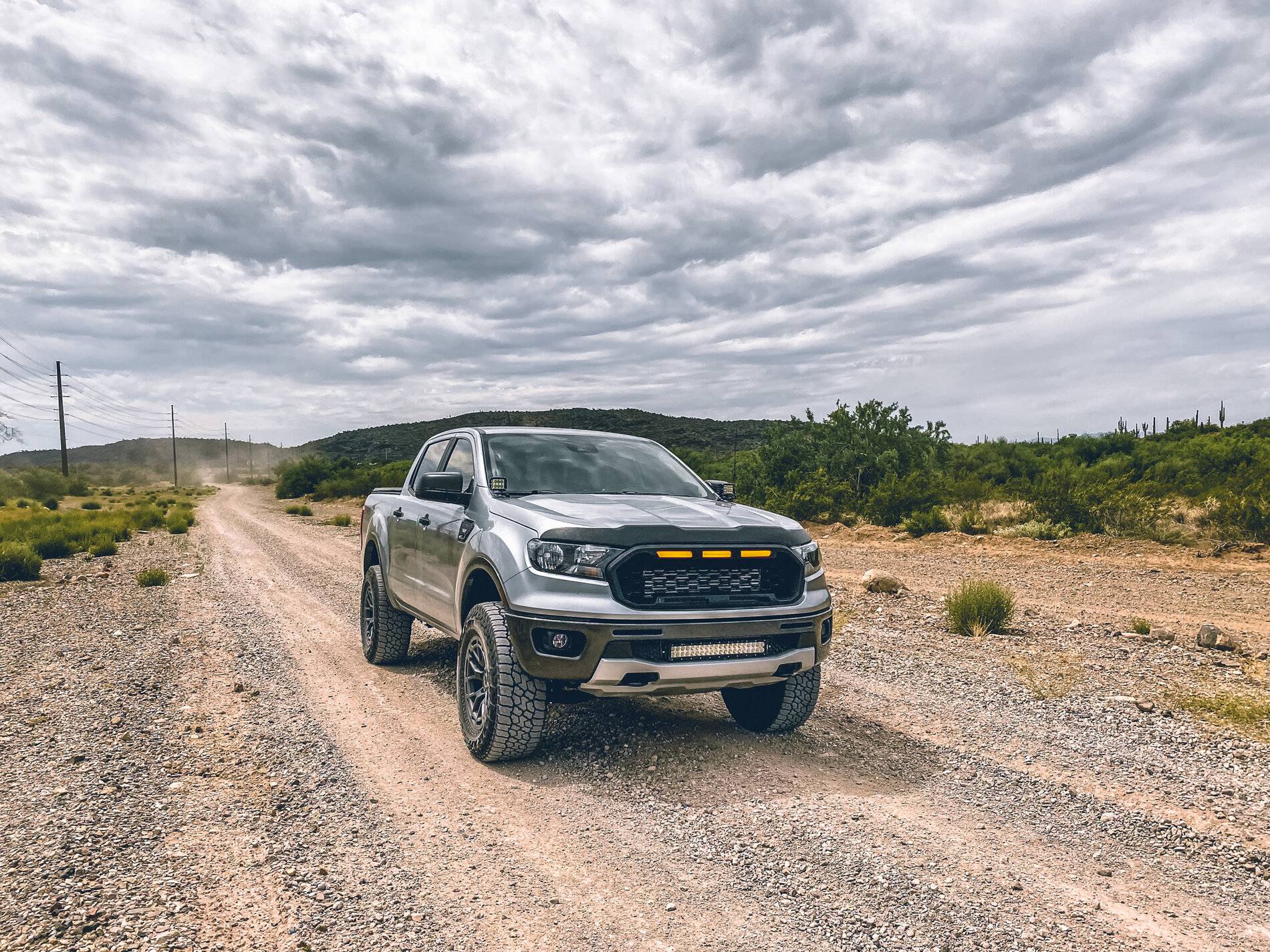

Curious about your lighting upgrades.
How is the light bar performing?
What is you use to upgrade the fogs to amber?
The lightbar is actually pretty decent for the price point, although I may upgrade to a CaliRaised or something more reputable later on. I just stuck some amber leds in the oem fog housings for now. Nothing fancy.

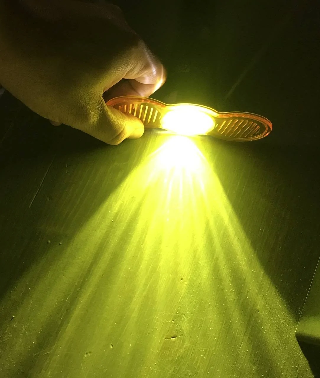

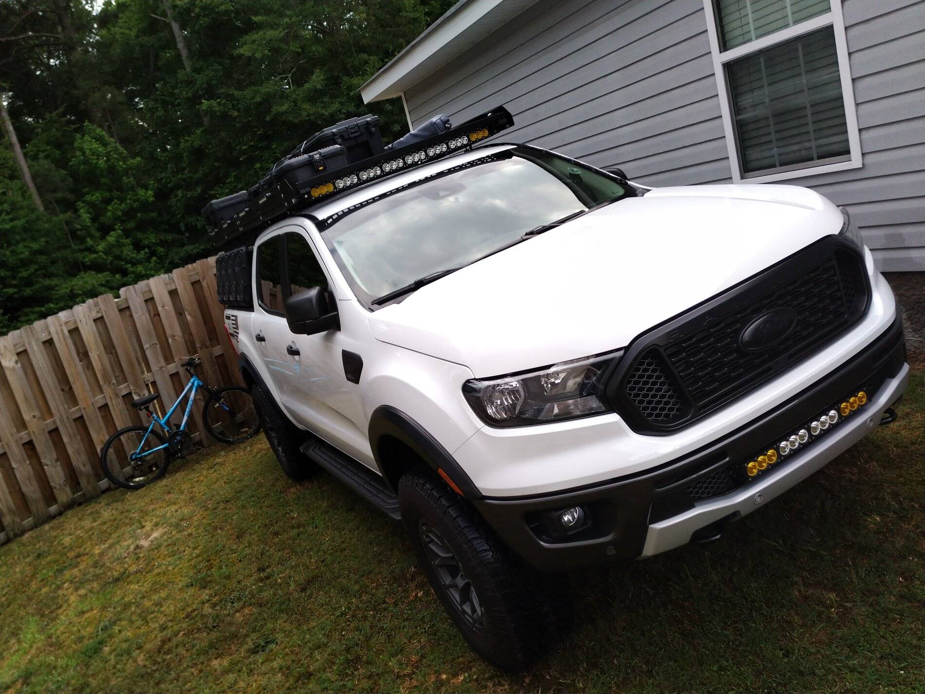

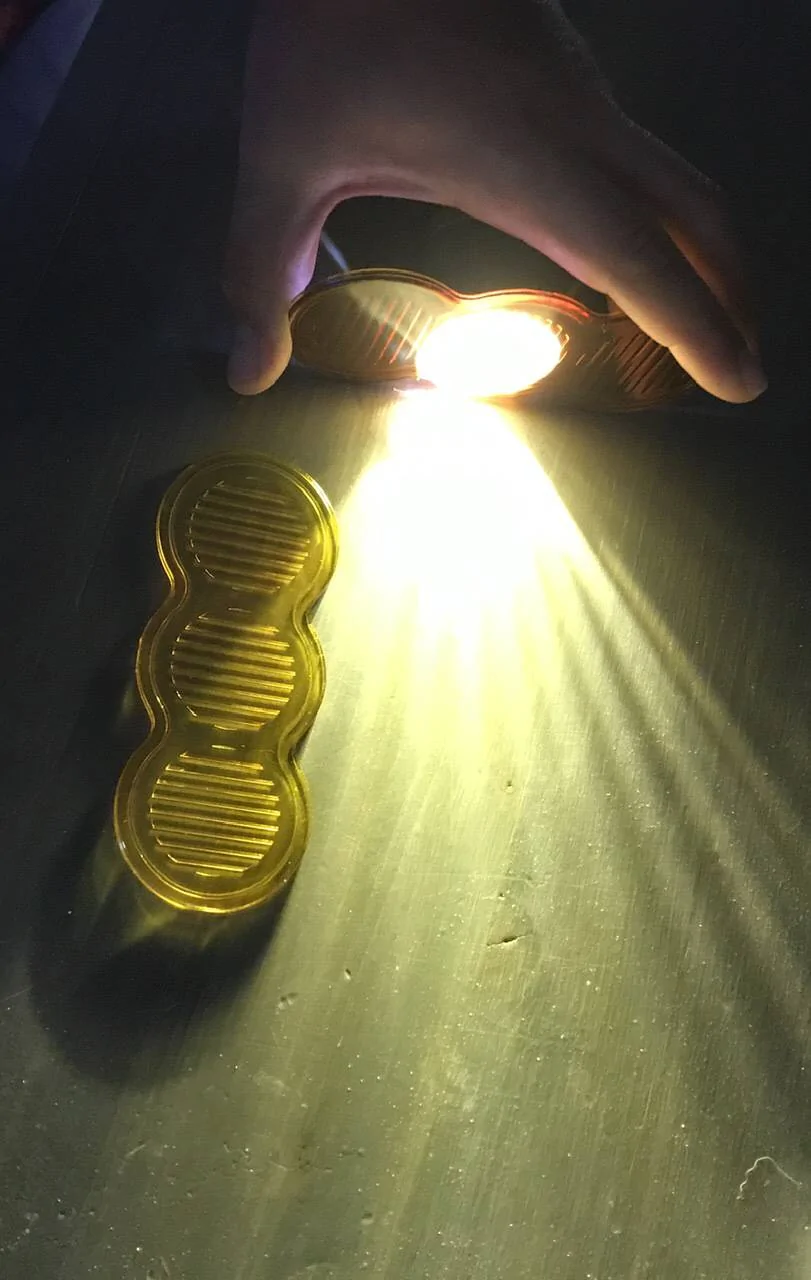

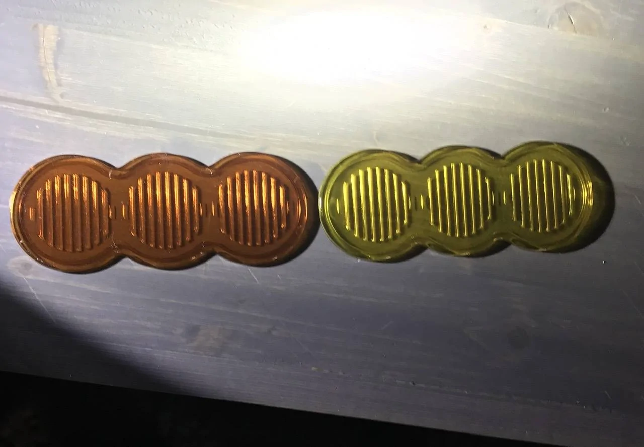

CaliRaised just sells repackaged Chicom lights at a higher pricer tag. You can find the same lights on Amazon for about $100-$80 less than their markup. Or get the same lights on Alibaba for about 50% less than Amazon if you are willing to wait a month for arrival.
How do I know this? Because I did my research and bought some;
The only modifications I did was redo the orange tinted lenses to a more yellow hue using Krylon yellow glass paint with a non-yelling UV clearcoat on top. That and I re-did all the seams using gasket maker to seal them. I do this with any light I buy though.
From my brief research it seems only Baja and Diode Dynamics manufacturer in-house. Even Rigid labels their light as "assembled in the USA" not made in the USA.
Nothing wrong with chicom lights as long as you reseal them and dont expect high technology focusing cups.

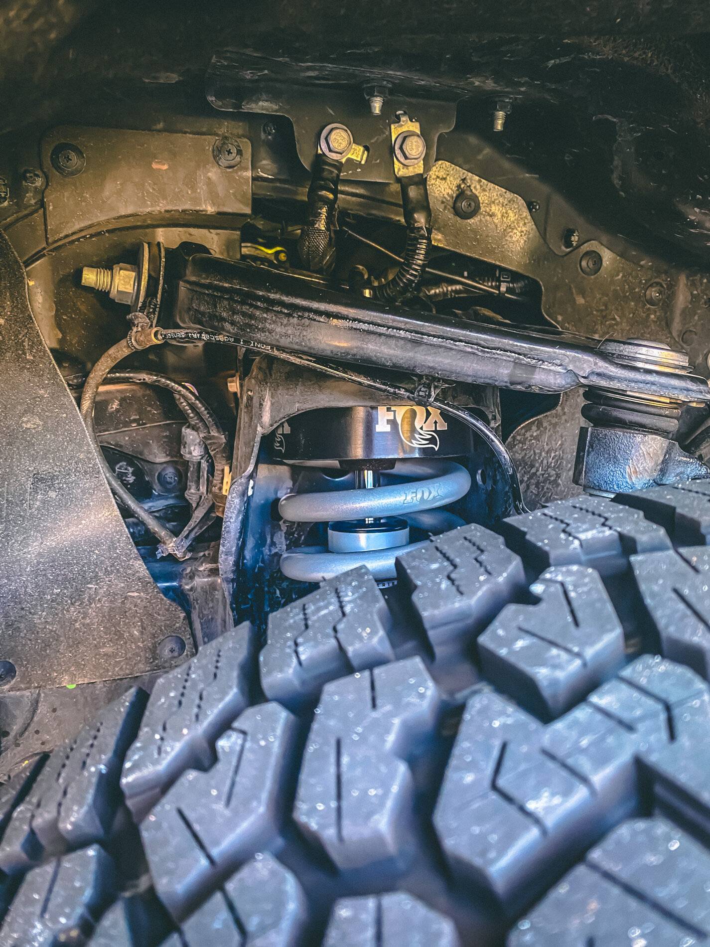

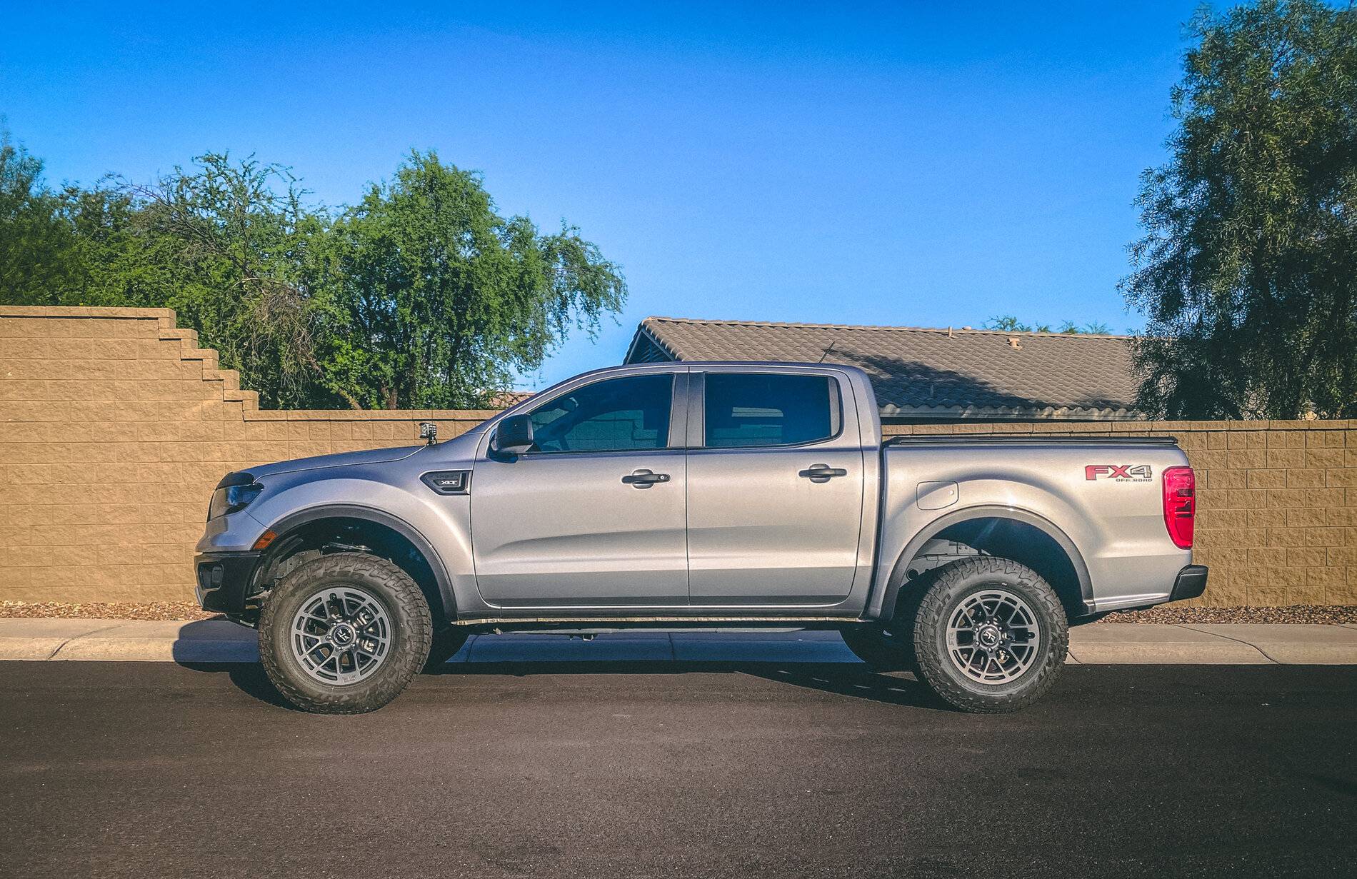

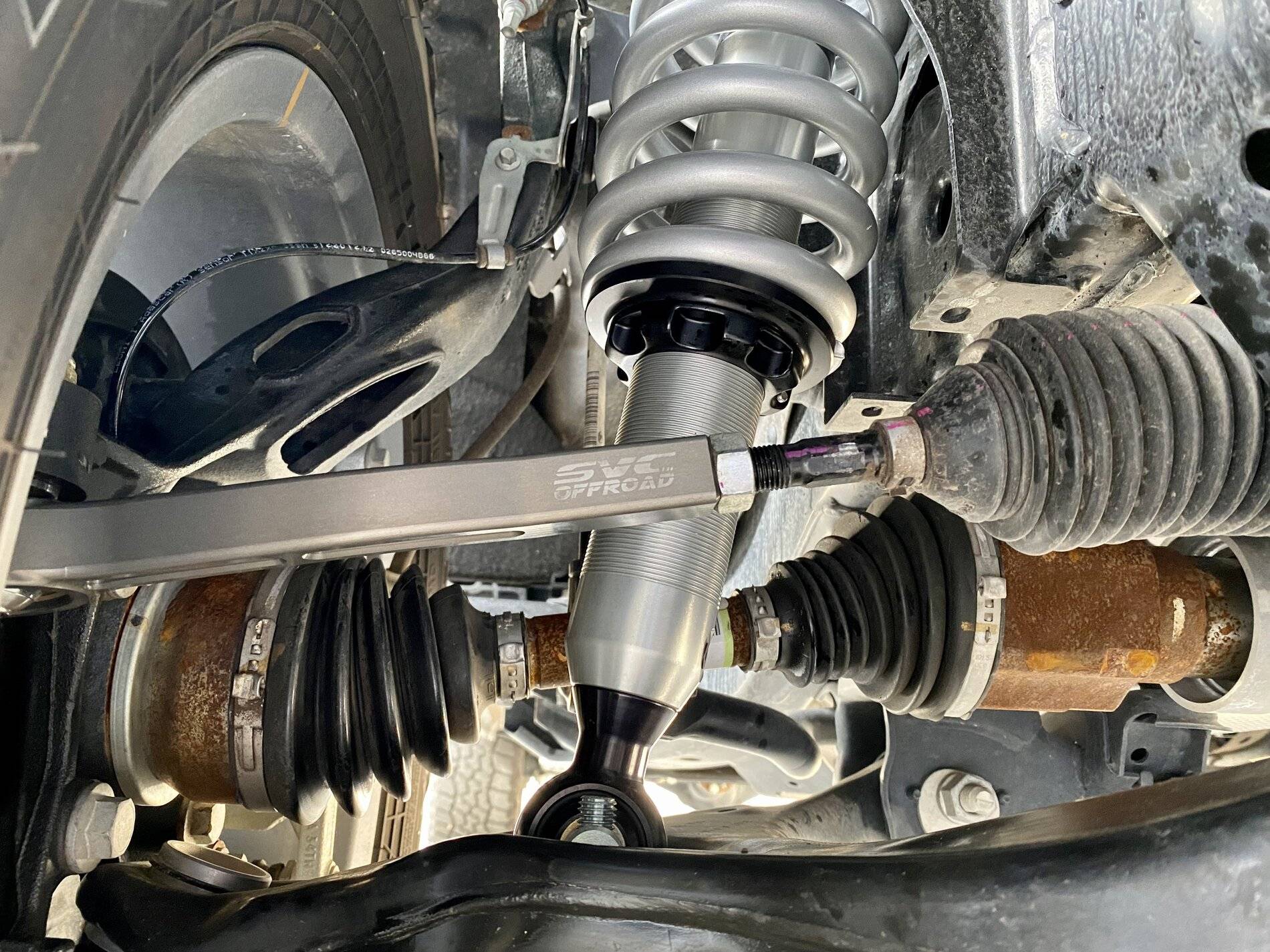

Update: I swapped out my BDS 2" Leveling Kit for a Roush Performance - Fox 2.0 kit. I still need to go for an alignment before I take this thing out for real, but I already feel a big improvement on the street. Just going for spin through the neighborhood afterword felt better.. Can't wait to hit the trails!
Also, for what it's worth I left the front coils as is and didnt't adjust the preload and the amount of level seems pretty comparable to what I had with the BDS kit.

Was the BDS that bad? It looked like an inexpensive way to level it out. I wasn’t too sure about pulling the trigger on the Fox 2.0 package.

Not at all. In fact, as far as spacer leveling kits go, I’d say it’s one of the better ones out there, considering the price point and how they balance changes to the frontend geometry with both a preload/top hat spacer + they include rear shocks. On street it was definitely an improvement over the oem FX4 setup and it served its purpose for me, but I got to the point where I was wanting more offroad performance. The ride was still borderline uncontrollable on trails with whoops and washboard areas. This Fox kit should refine some of that.
If you’re just trying to fit a bigger tire and get a slightly better ride over stock, I’d definitely recommend BDS.
