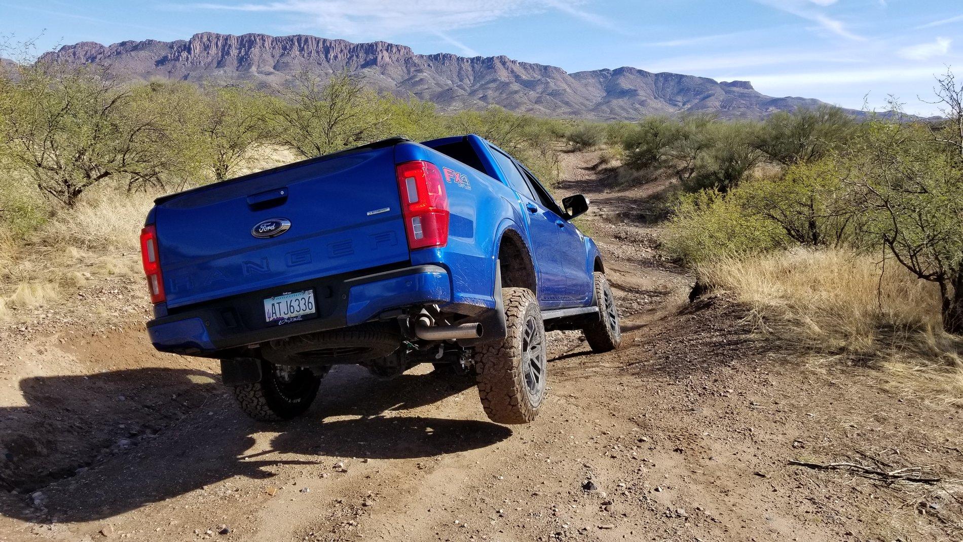

Put these wheel spacers to the test. Definitely gives me more piece of mind after what I put them through today.
Looks like a blast! What brand of spacers are you using?

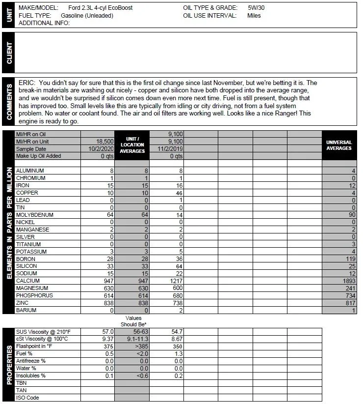

My 2nd oil analysis has come back. First 9k miles was on the factory oil. Followed by M1 Full Syn to 18k. Ran the oil life meter to 5%. And since these results were still showing good results I always run NAPA's gold or platinum oil filters (w/e their top of the line filter they offer). Since it's the build quality on them are A1. No catch can and I probably won't even install one. Since it will likely be sold/trade in next year.
