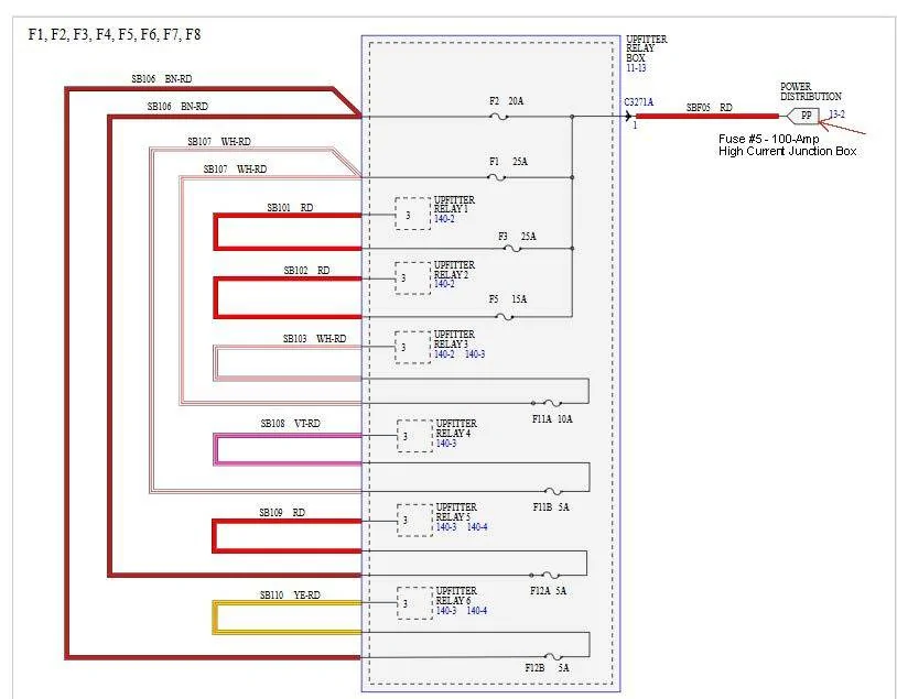

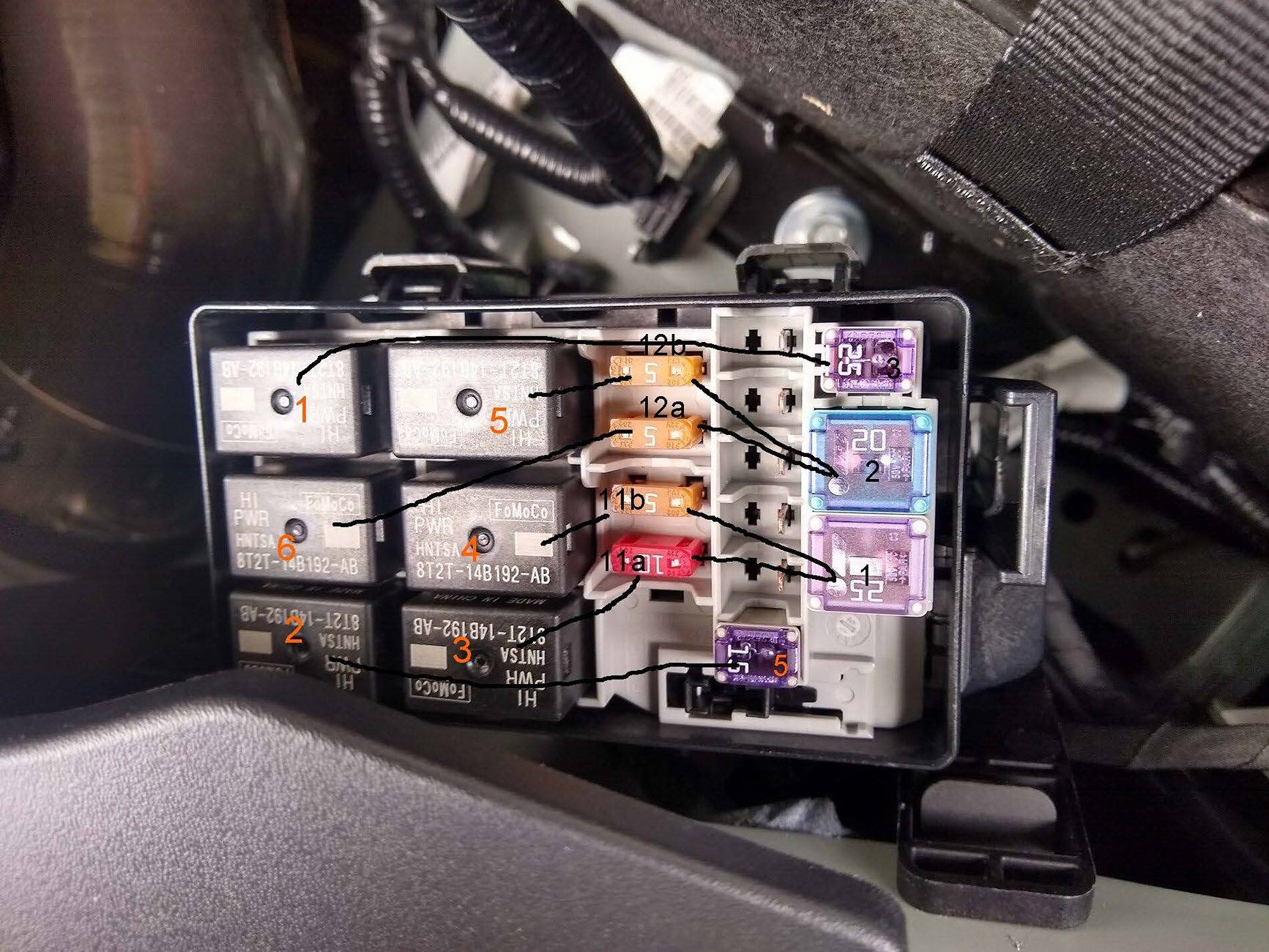

It should also be noted that inside the (Relay Box)
Fuse #3 - 25-Amp - Direct Feed to Relay #1 (Switch #1)
Fuse #5 - 15-Amp - Direct Feed to Relay #2 (Switch #2)
Fuse #1 - 25-Amp - Feeds
Fuse 11a - 10-amp fuse for Relay #3 (Switch #3)
Fuse 11b - 5-amp fuse for Relay #4 (Switch #4)
So, fuse # 1 - gives 10-amp cushion for both switch circuits
Fuse 2 - 20-Amp - Feeds
Fuse 12b - 5-amp fuse for Relay #5 (Switch #5)
Fuse 12a - 5-amp fuse for Relay #6 (Switch #6)
So, Fuse #2 - gives a 10-Amp cushion for both switch circuits
So what you are saying is that even if I plug a 5 A light to #6, the fuse in the box is actually 5+cushion? That is comforting.

The 5-Amp will still blow before the feeding 20 Amp

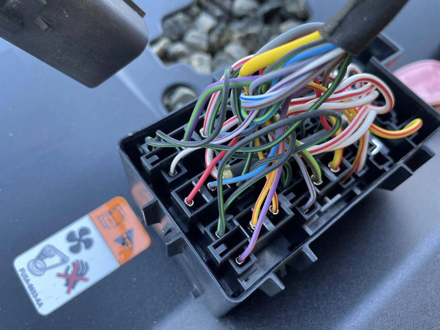

run
The unknown is - what wire size (if this is an old school box with actual wires) is routed between the fuse and pin #3 of the relay and are all the relays the same part number.
And the wire size (short) run for the relay output (Customer Access) connection point to add your wire harness or is it a Busbar connection
I can only see the switch wiring which splits at connector C146 - 20g coming off the relay box and then drops down to 22g at that connector feeding back into the cab.
Basically, in a nutshell, IDK if Ford has the relay set up (fused) circuits for the mere convenience of presets or is all the wiring internal to the box all the same wire gauge.
Is the circuit for Switch #6 - Truly LIMITED to only 5-amps?
If this is not a PCB like the BJB is, you can view the wire feeds and note (are they different gauged wires)
If this is a PCB style relay box - then it is defiantly limited, and you want to adhere to the 5-amp rating.

So, if one really wanted to do it, they could rewire the box anyway they wanted as long as they conform to the amperage total of the Mega 100 Amp Fuse rating
So, 85 Amps Fuse Total (In the Box) with 15-amp buffer (cushion)
Each fuse is spliced off of that main feed - feeding each fuse (appears wire gauge) changes depending on the fuse.
or simply (instead of moving switches) in the switch box, de-pin the fuse locations and relocate and then move the fuse along with it.
Just throwing out - OPTIONS
