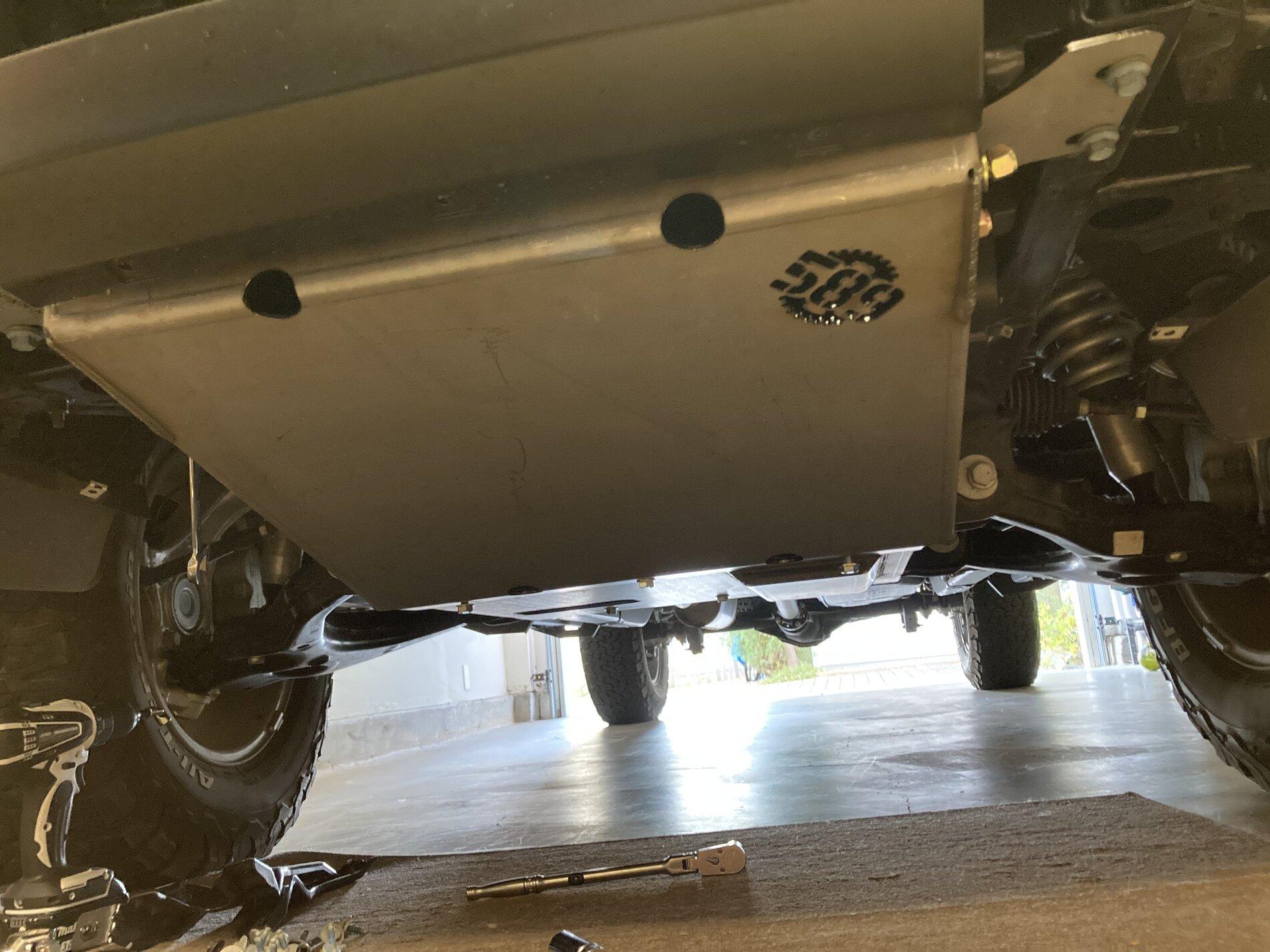

ARB lists them as being 3mm thick. Or approx. 1/8". I installed the front two skids from 589 Fab. They're more money, but they're also thicker at 3/16" (same as Shrockworks). Also, I don't see any openings in the ARB skids for drain plug access.
The ARB's look nice but having already made us of mine in Death Valley, I wouldn't want anything potentially weaker.
