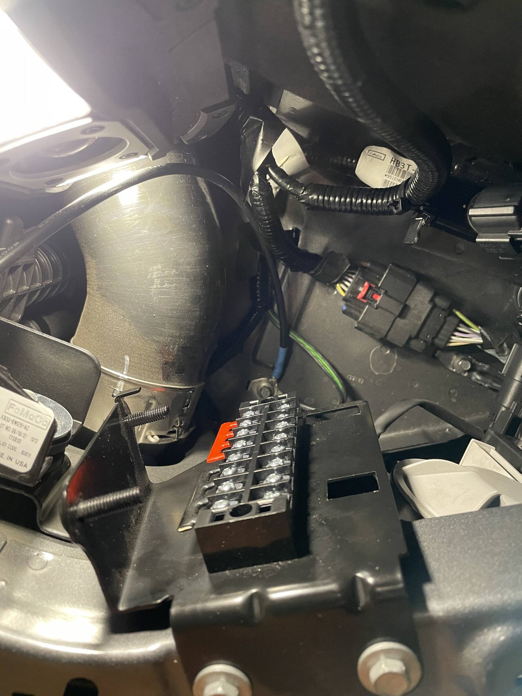

Thanks for the info, did you connect it to the current fog lights or you have a separate switch for it?
They are connected to an Aux Switch.
Current Aux Switch Use:
AUX 1: Unused
AUX 2: Rear Backup Lights / DD SSC1 ( Will soon add 4 Rigid to a rack for side lights)
AUX 3: Lower Grill Lights (4 Rigid)
AUX 4: Ditch Lights (2 Rigid)
Aux 5: Running Lights / BackLights (Lower Grill Lights, Upper Grill Lights, Side Vents)
Aux 6: Running Lights / BackLights (Ditch Lights, Running Board Lights, Rear Backup Lights, Rack Lights (Future))

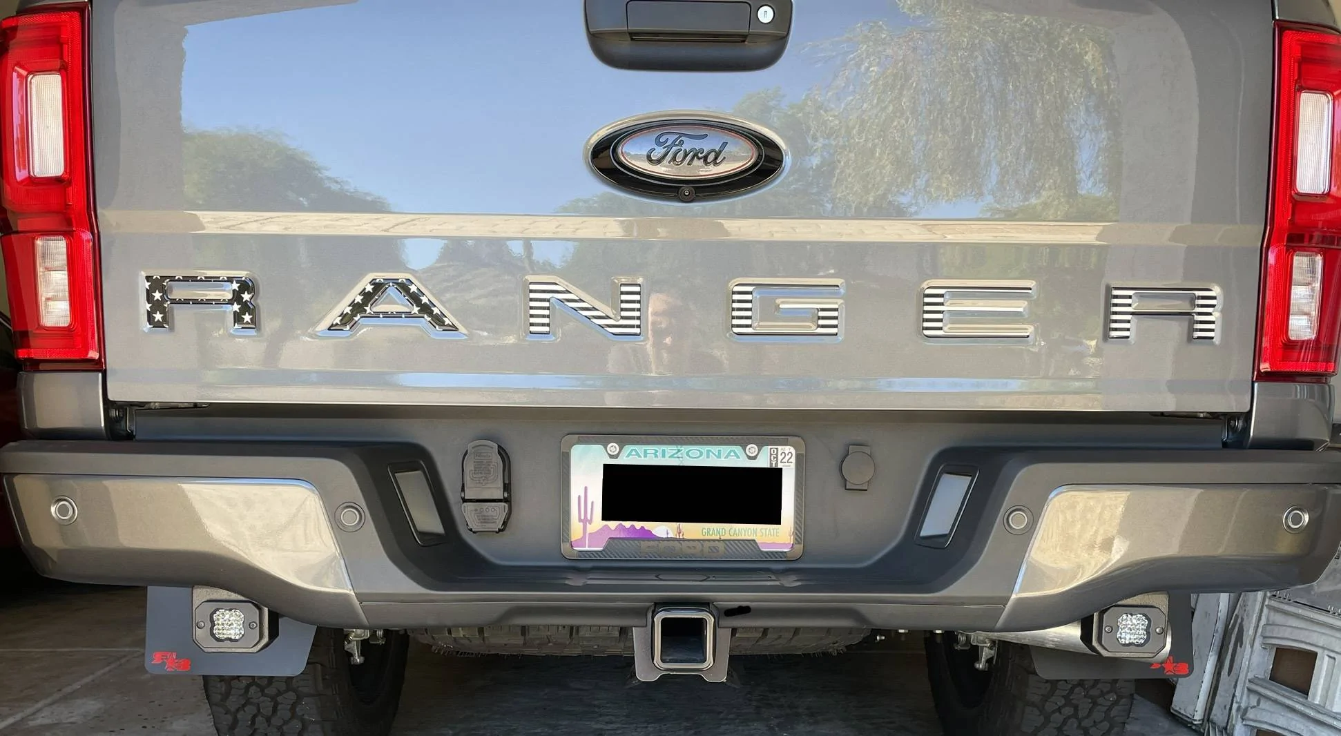

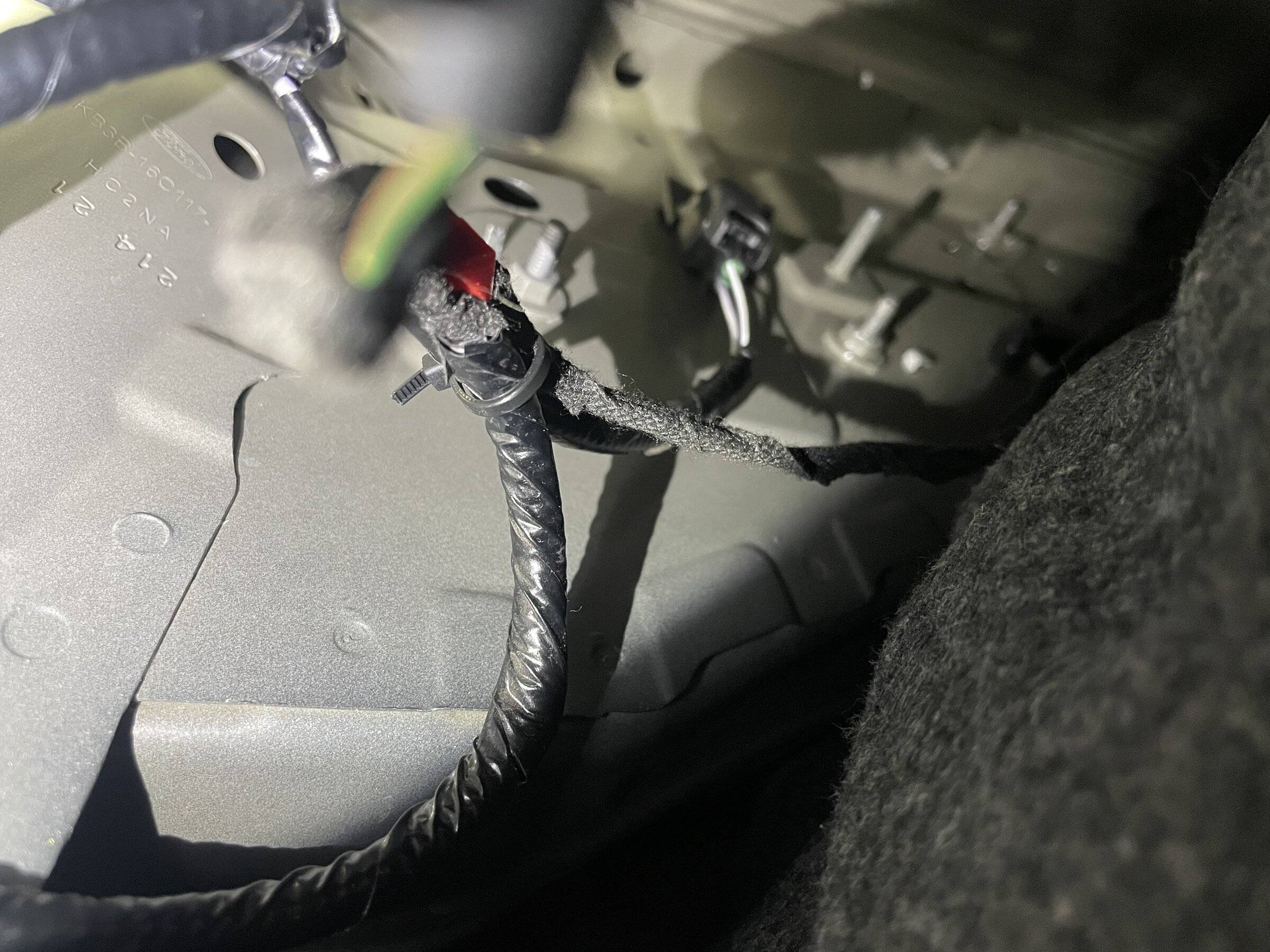

ran a lead from the up fitter to the rear for a pair of Diode Dynamics SSC1 red backlit flush mount reverse lights
That first post (flush mount) inspired me to find this/your build thread. Do you have a pic of your flush mounted reverse lights? I'd love to see how/where you mounted them.

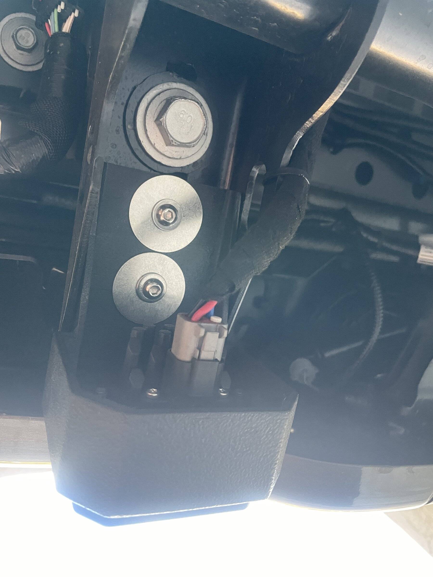

I printed a set of brackets out of polycarbonate that mount in the channels of the trailer hitch. Sits slightly higher then the hitch mount.
dkirby
Feb 3, 2022
134
402
USA
'22 Lariat Tremor, '16 Focus RS, '10 Evo X
Wow @JDowns , that's next level custom. I was expecting to see holes cut into your bumper or tailgate. Nice job!
JDowns
JDowns
Jeff
Dec 3, 2021
448
1,658
Coeur D'Alene
2021 Ranger XLT Tremor
Thanks.
Two bolts to attach were unnecessary. I could have used one since the housing sits in a channel that would stop any side to side movement. The large fender washers were the only size I could find, I wanted a bit smaller but all the hardware store had in stock was chrome, and I wasn't going to spend $15 a washer. I do want to redo the housing slightly in order to bring the surround back to cover the connection. That way if there is any drag the housing takes the hit and not the cabling.

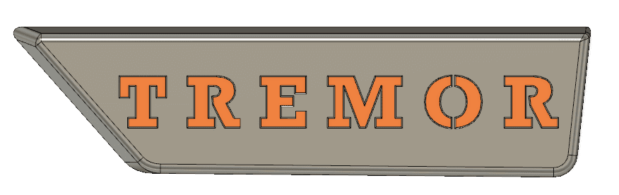

I'd be interested in the Badge Insert if you end up making a bunch to sell. Very cool!!!

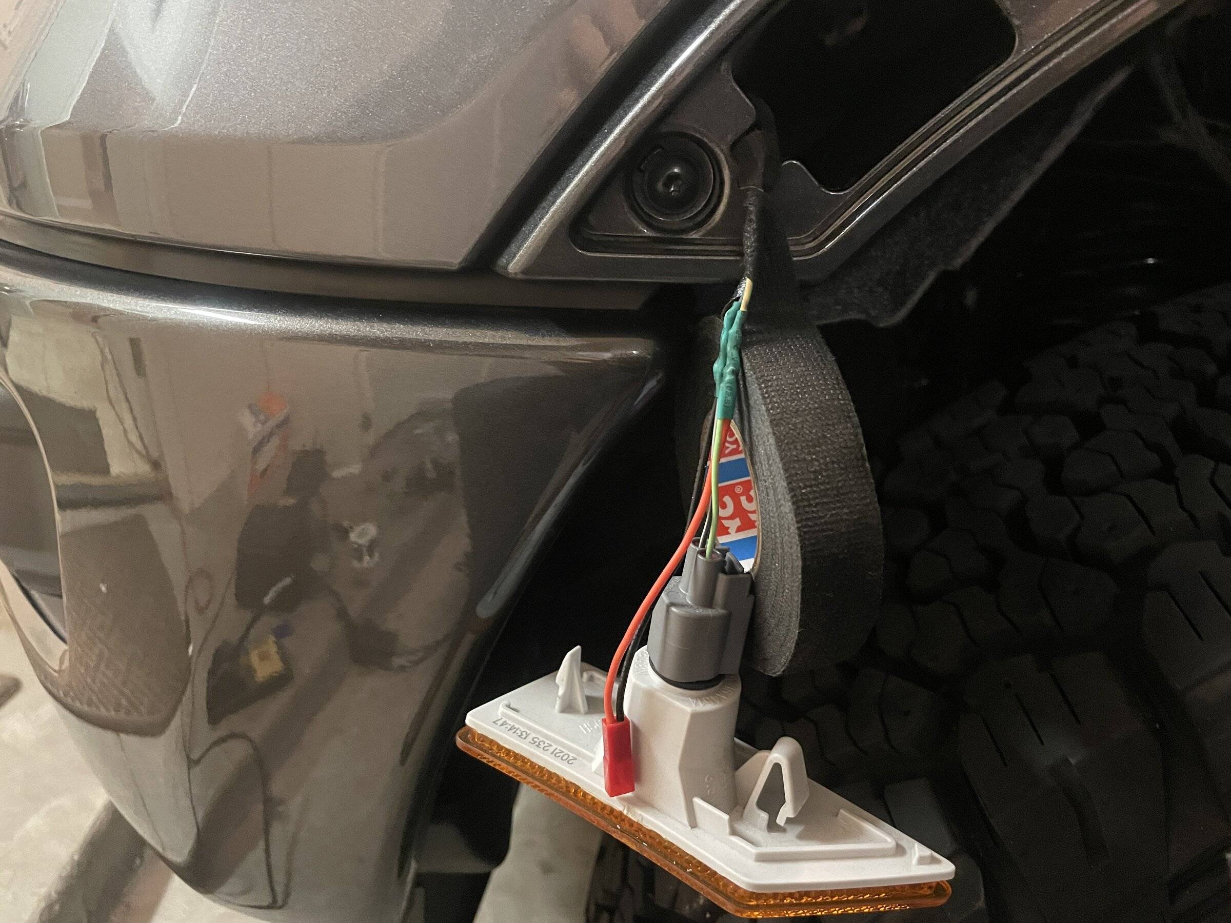

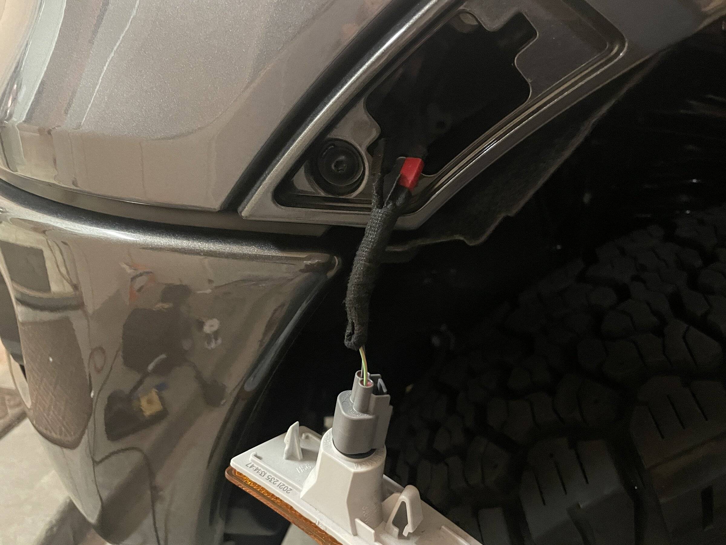

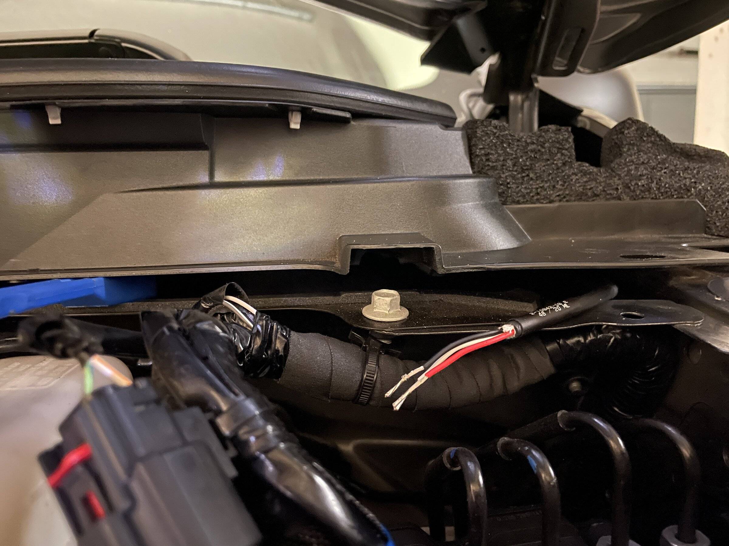

Installed the grill lights this morning. Which I'm officially calling Traptor Grill Lights. I used (4) of these. Made a custom wiring harness to tap into the passenger lower marker light. Printed custom mounts from polycarbonate to get the right offset inside the grill and mounted center in each of the (4) slots with 3M VHB tape.
Front end should look nice once the (4) Rigid Radiance Pod Lights are installed with amber backlighting. Can't wait to get my grill lettering next week. I chose the BW American Flag from TufSkinz.
Would you mind sharing the STL for the light brackets? I like the look and will probably do the same thing with a tremor grill down the road. Thanks!
