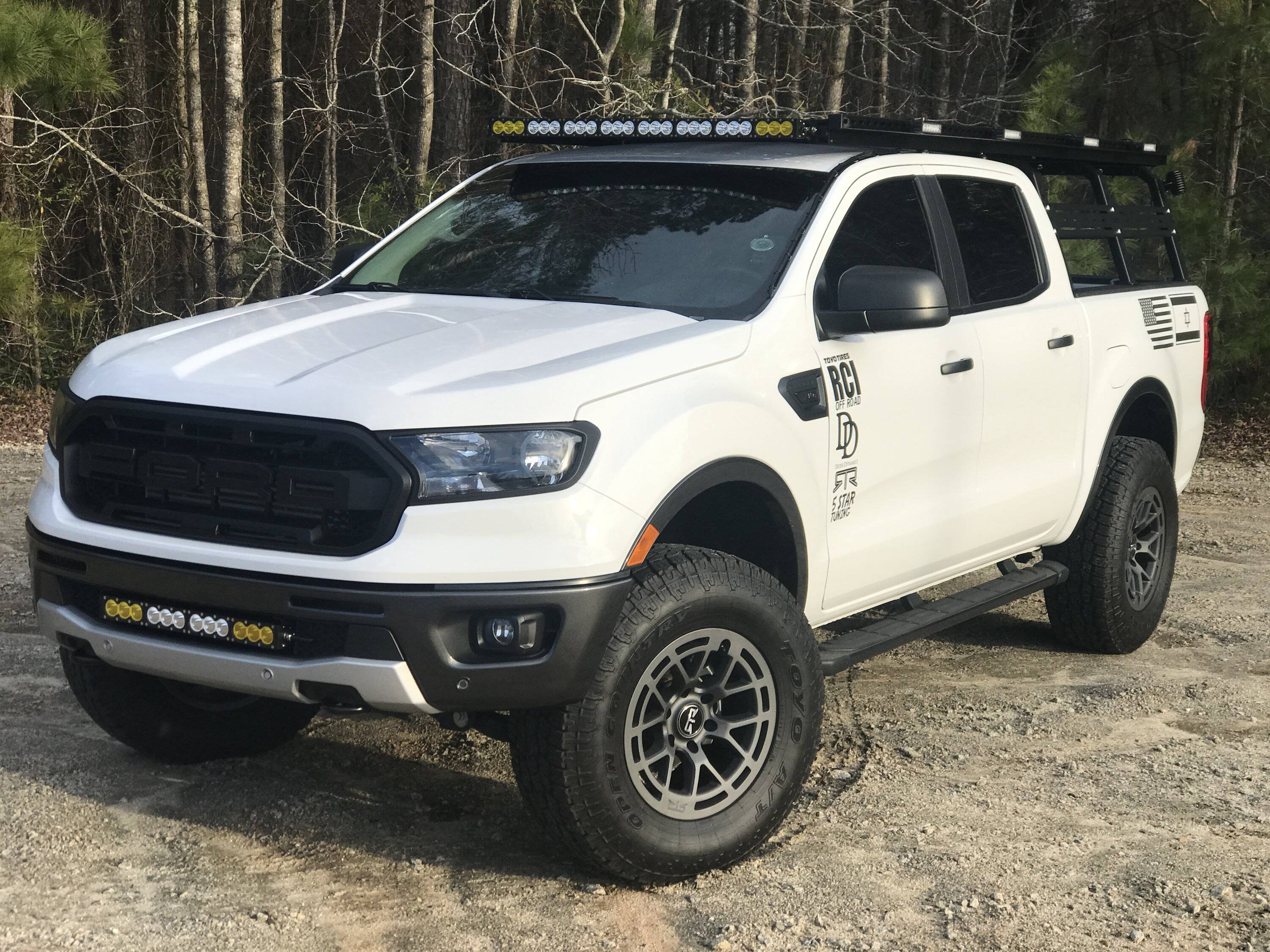

haha man talk about a long time ago. However I did not do that as rice, I was working on something at the time that did not pan out.
Dang, can't believe its the same truck. Way back on rack Version 1!
That's a pretty sweet-looking truck! I think SId's got you beat on lights, though.
But stickers don't bug me like they do some folks.
Stickers for components you don't HAVE is a classic RICE move.
I'm not accusing you of doing that, to be clear, just clarifying the difference between ricer and real.
