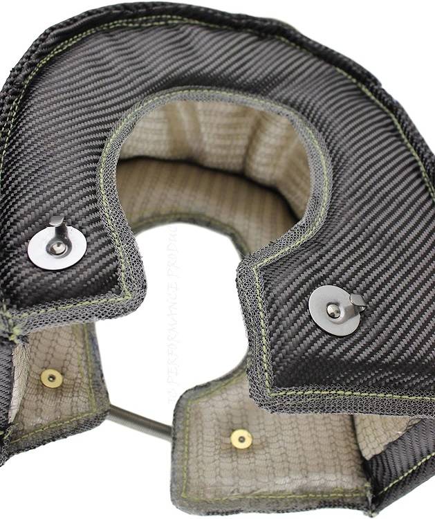

Has anyone installed a turbo blanket yet and if so is it worth buying.
Got this blanket for under $48. https://www.amazon.com/dp/B078WXQKHP?psc=1&ref=ppx_yo2ov_dt_b_product_details seems quite well made.
Very tough, heavy, seams are very well done, many layers. all the right stuff. I got the T3 size. Would not fit between the waste gate actuator rod and turbo housing. Also will not cover the wide body of the twin scroll turbo. by the time I was done trying to stuff and spread it, I had cut and beat it pretty bad so could not return. Don't buy a generic T3 Blanket, it probably will not work.
