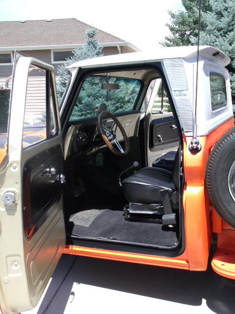

Off topic... but here's where I mounted the antenna on my '65 C10... Where the OEM gas filler cap was located.

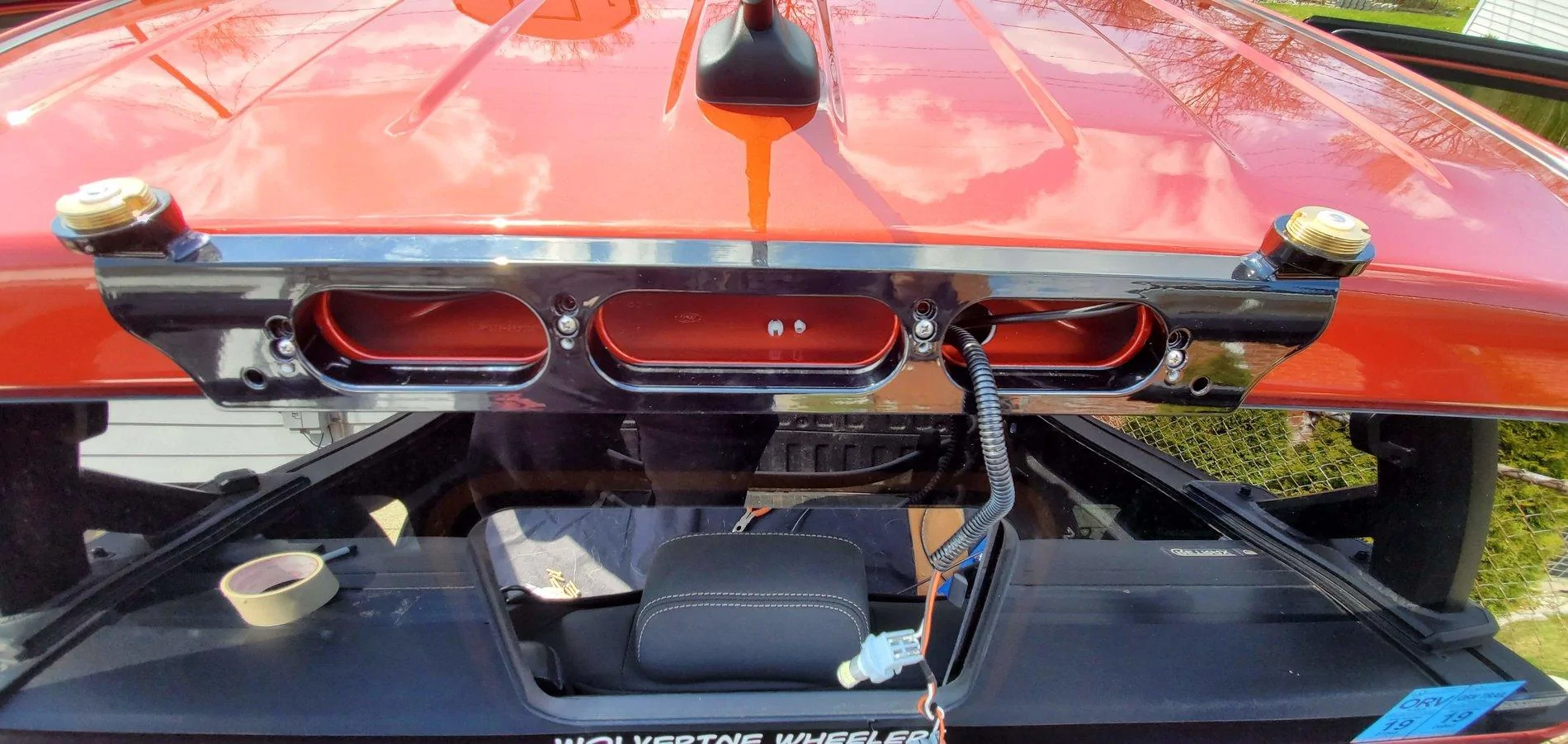

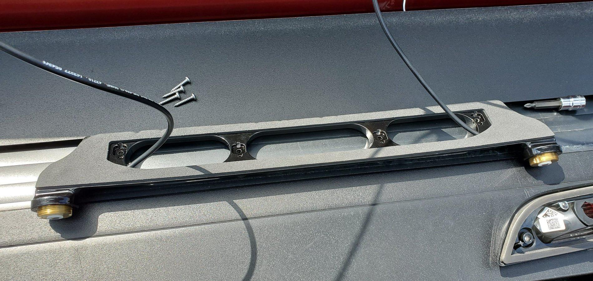

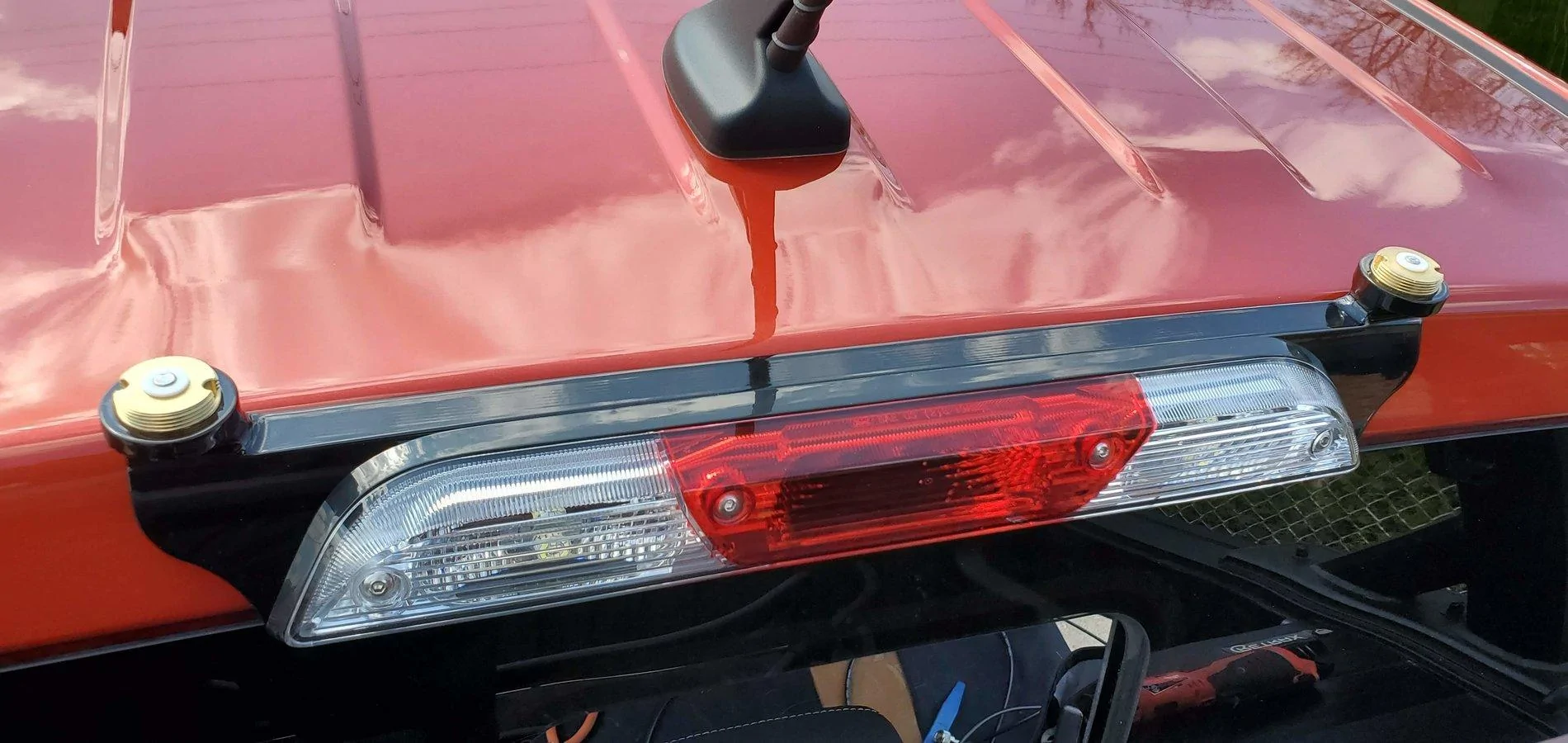

That antenna mount looks like a great option! I wonder if it fits the Ranger. Pricey, but better than drilling a hole in the roof I suppose. My antenna knowledge is a bit rusty, but I think I'd have to upgrade from a 1/4 wavelength vertical to a 1/2 wavelength vertical with this mount since there is no ground plane like you'd have on the roof.
How are you going to power your CB? Do you tap a wire under the dash, get power from the fuse box, or will you do a home run to the battery?
That brake light mount does fit our rangers...had some rains since install, seals just fine.

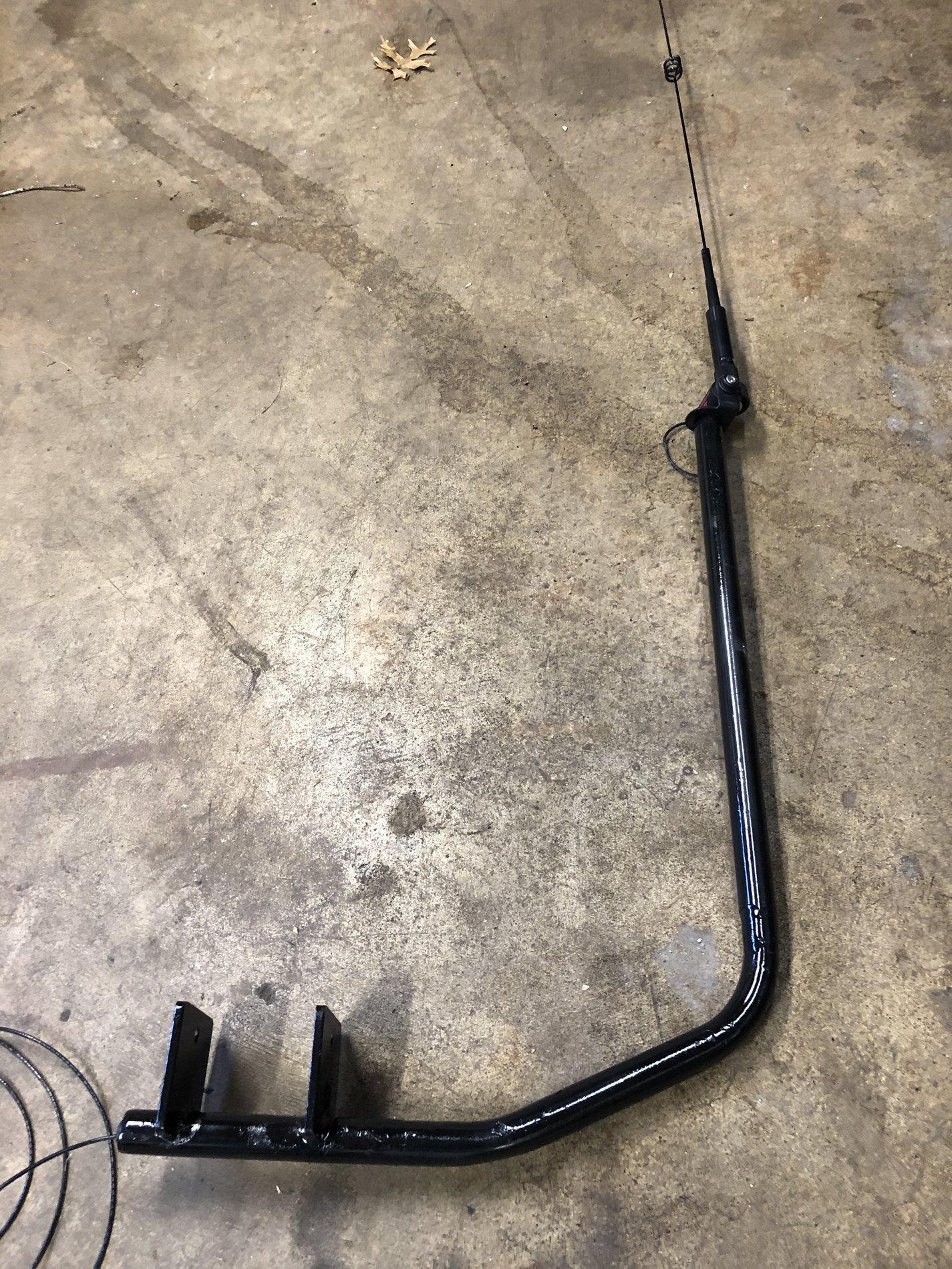

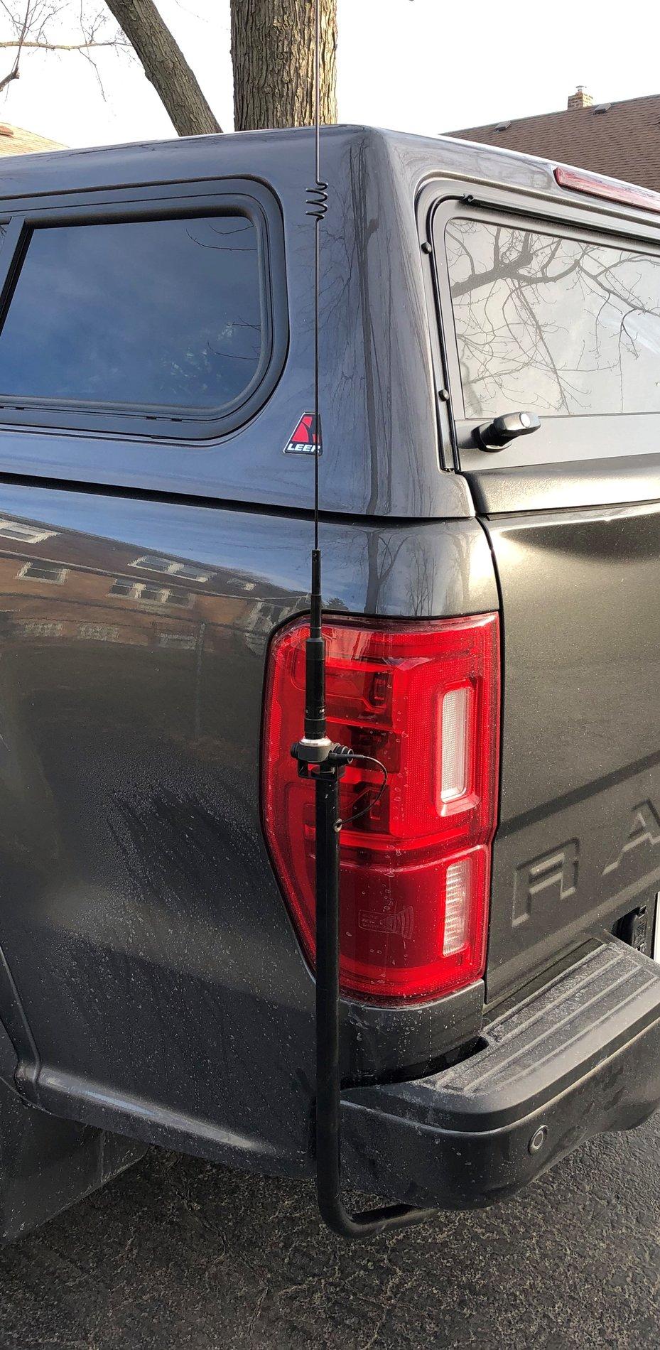

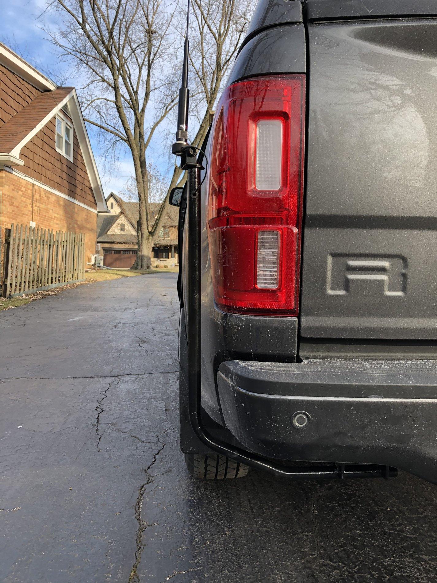

I didn't want to drill any holes or mar any paint on my new truck. I also wanted an installation that would get the antenna up some but still allow me to get the truck in the garage. So I built this custom mount which attaches to the left rear of the frame. There are two holes there which I mounted this bracket to. The coax is run under the bed and through a grommet on the left side of the rear of the cab. Had to pull back the lining to get to the grommet. The antenna folds over so I can park in the garage.
Running 50 watts from an Icom ID-5100. SWR is 1.2 to 1.

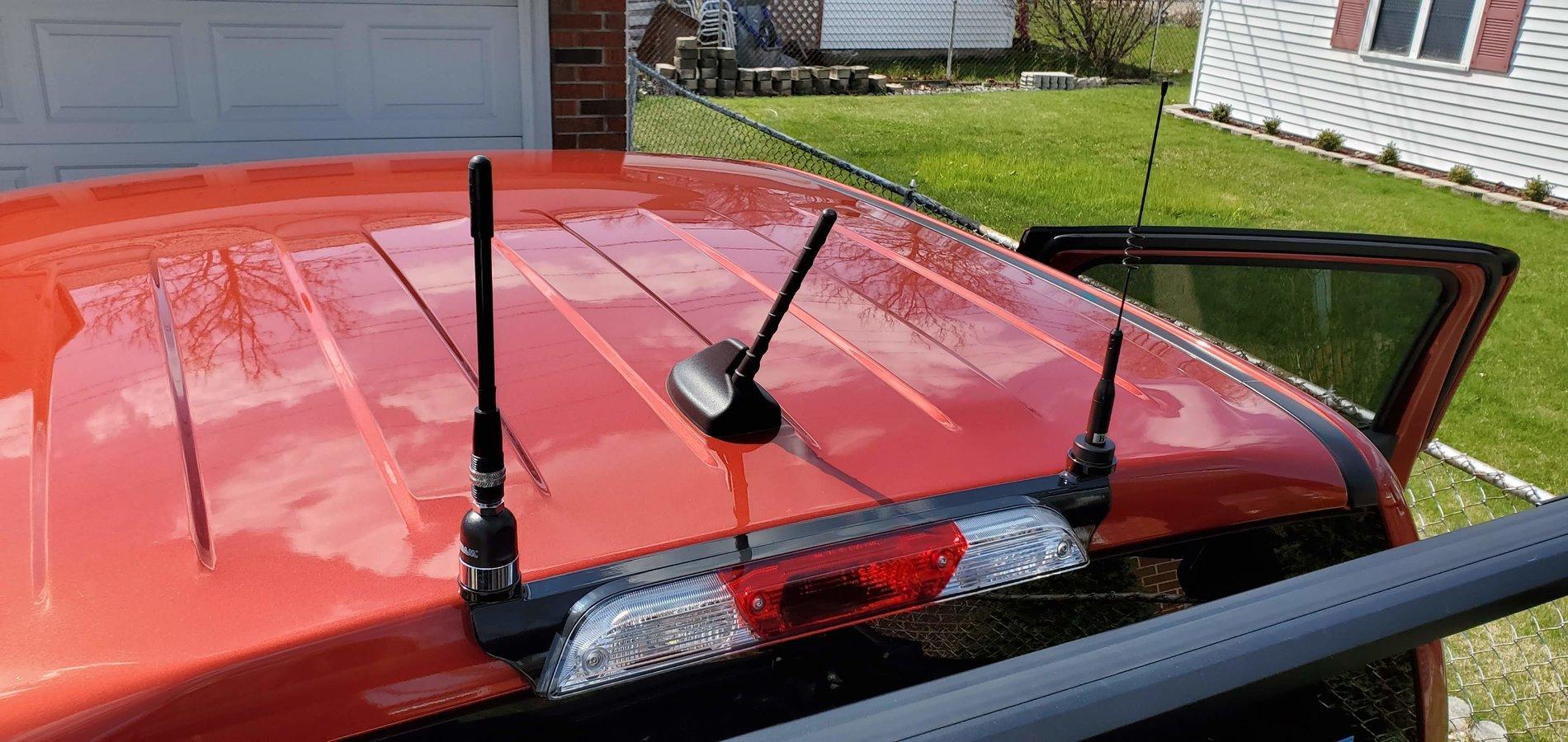

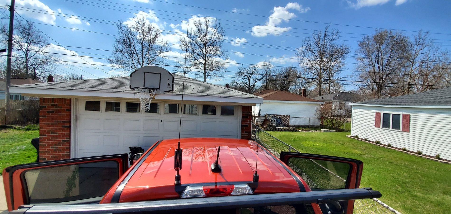

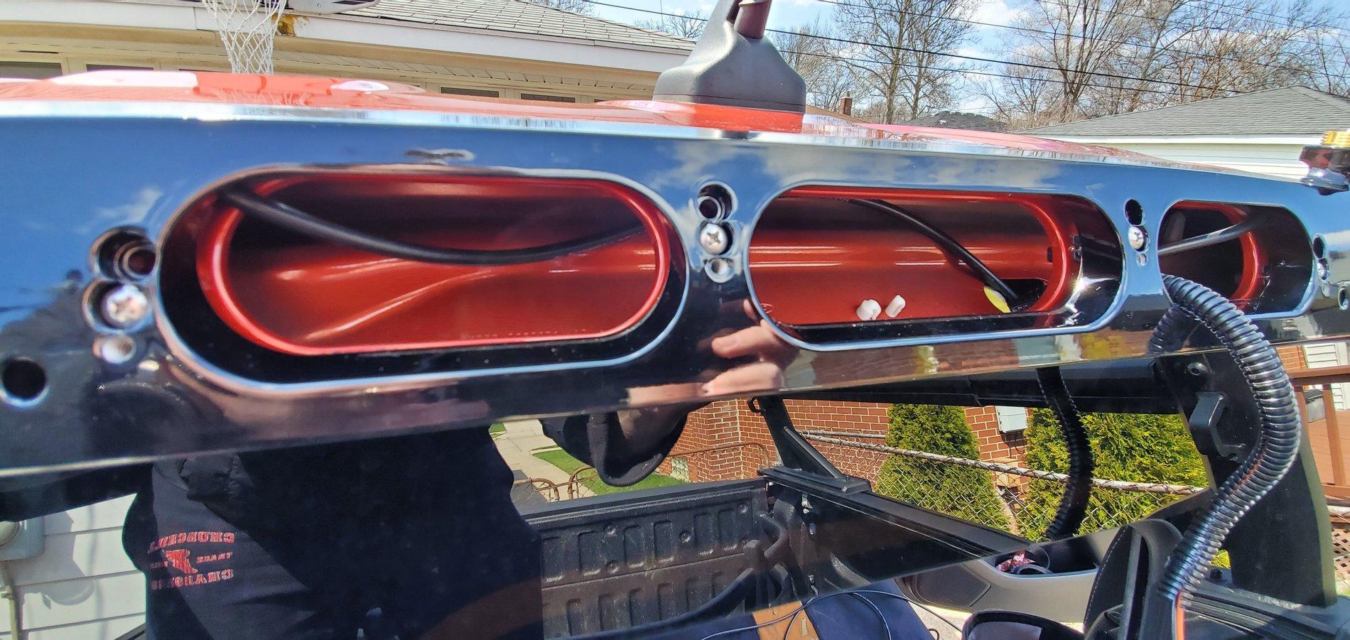

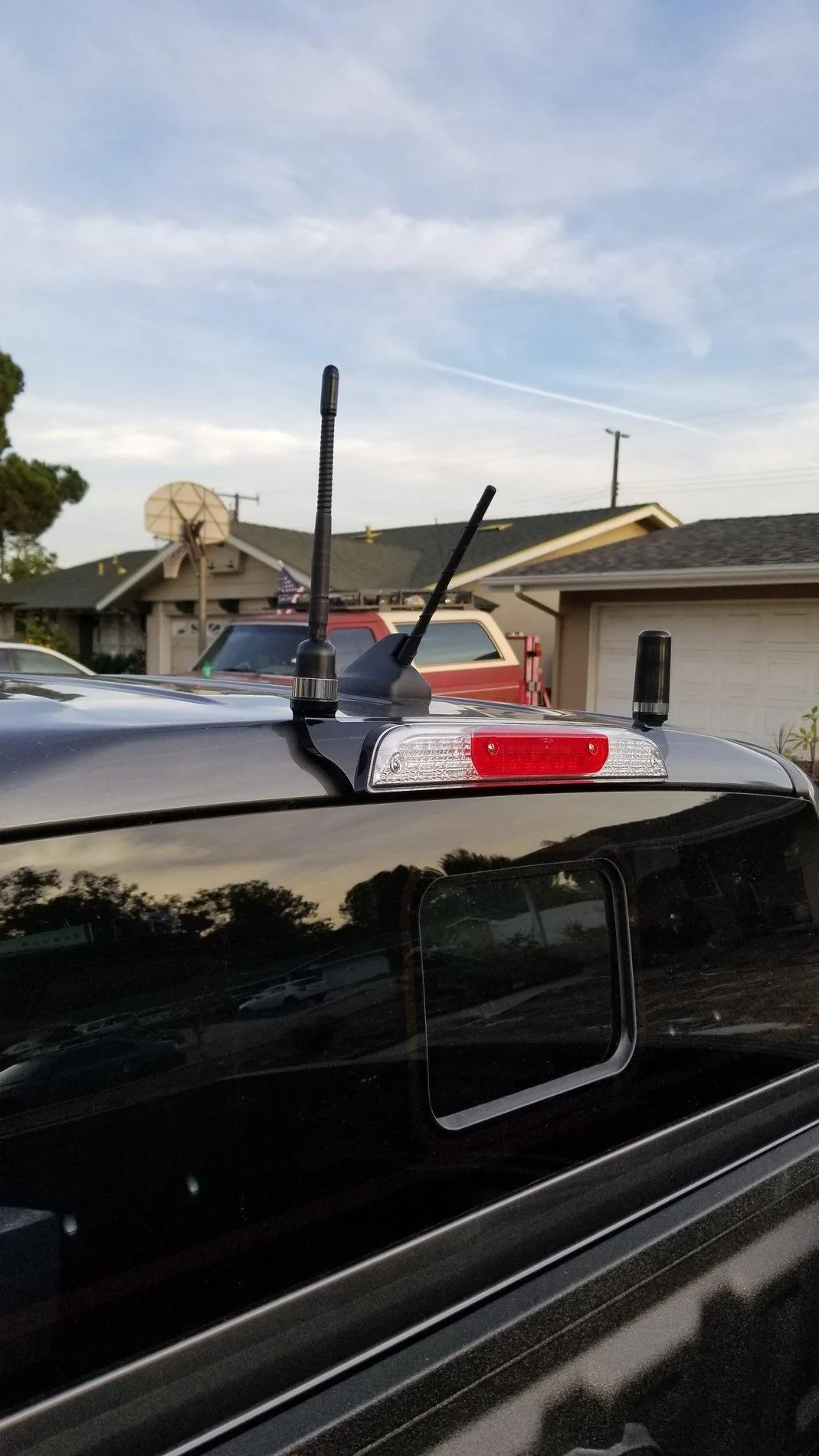

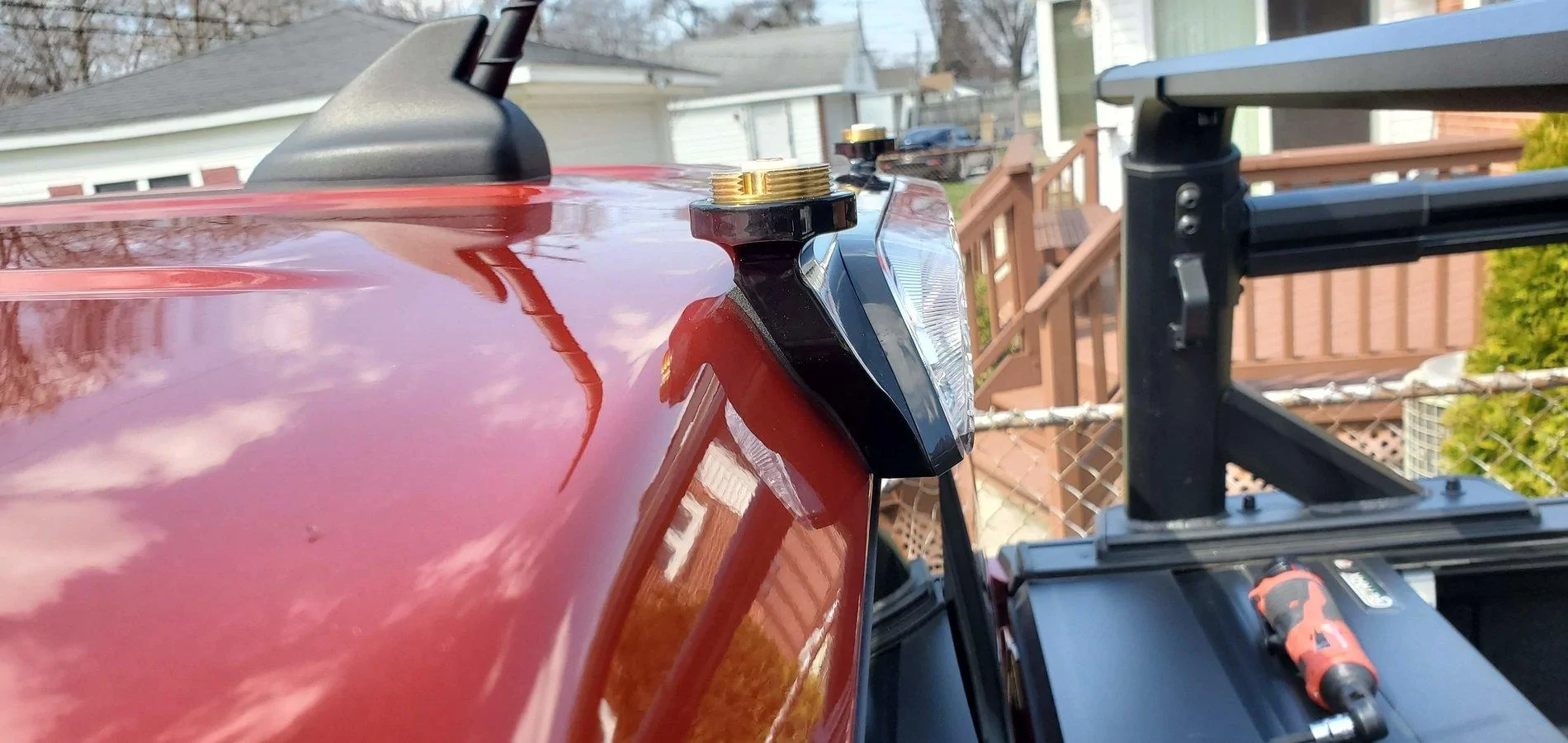

I installed the Bullet Proof Diesel Third Brake Light Antenna Mount with the Dual Antenna setup as well! I had a couple of struggles with the install initially, mostly with routing of the cable through the cab, but once I figured that out, the rest was pretty straight forward! Plus, I just love how OEM this mount looks, and the fact that you do not need to drill any holes or anything like that to get two great NMO mounts!
I have a full write-up on the installation and such of the antennas on my build page here if you are interested in further details.
