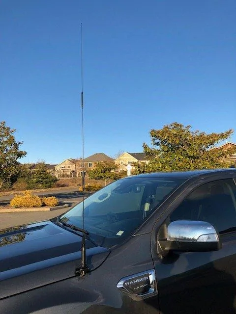

I run a Diamond 7500A on a SPM35 magnet mount (because I hit it on trees constantly). I routed the cable in behind the cab through one of the large vents. You might have to find someone with small hands to get it through the vent louvers though. I also mounted my radio body in the spot behind the drivers side rear seat where the B&O factory amp would be mounted in a Lariat with that option (I have an XLT). There is room for the radio body on the other side, or under the rear seat on the crew cab, but I don't know how well it would be vented.
The face of the radio should be in a picture somewhere in this thread, I mounted it with 3M gray in the tray on the dash.

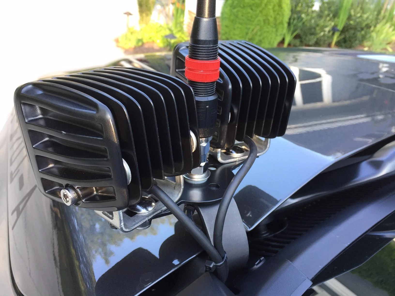

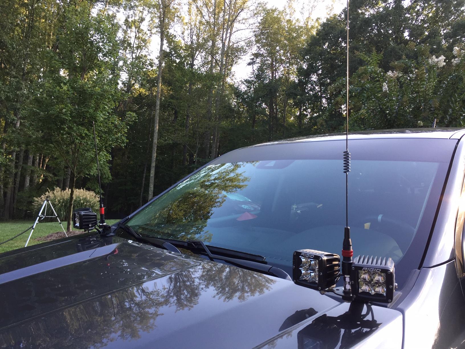

This is my solution...shortwave antenna lip mounted to hood on passenger and CB antenna stud mounted through ditch light bracket:)

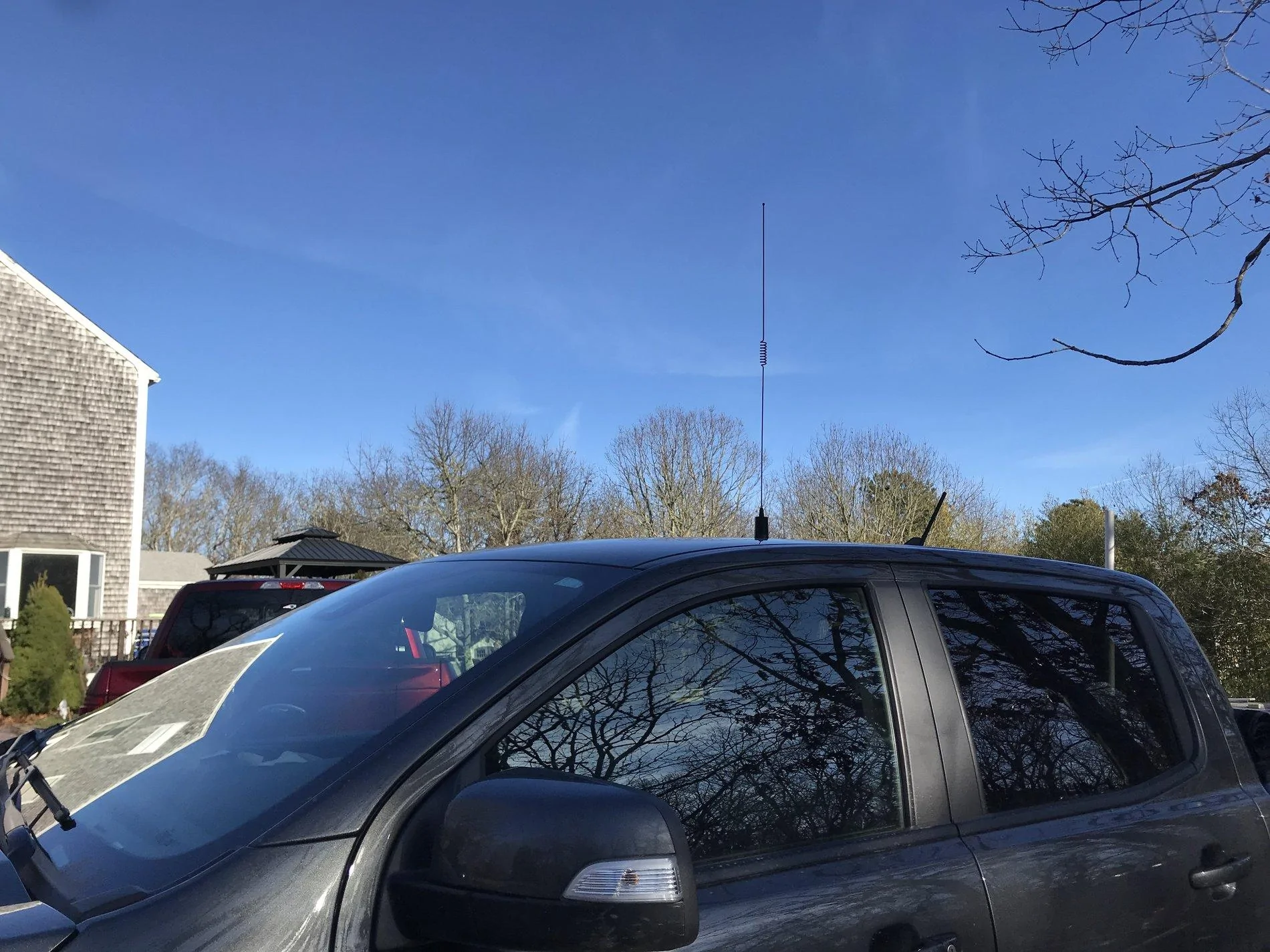

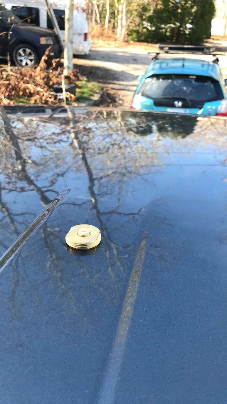

I went full commitment and did a permanent mount. I drilled directly over the second row dome light, so I can access the mount without disturbing the headliner. Going to remote mount the radio behind the rear seat, with the faceplate in the tray on the dash. Also installing a Lightforce fascia with their UHF jack to plug the speaker mic into, and a Magnetic Mic mount. Will update as the install progresses.
Currently running a Larsen NMO 2/70B. Looking for something shorter with a spring for every day use.

While it's probably the best option, I would straight break that off in short order, and while doing so, I'd probably tear a 4" gash in the roof requiring thousands of dollars in repairs. I stick to the magnet for that reason. Maybe someday I'll get one of those fancy third brake light mounts.

The 2/70 is a big whip to run up there every day, something with a spring base would be just as effective at damage mitigation as a magnet mount without the need to reset. We run spring loaded Laird antennas on the cabs of our dump trucks, which see some serious abuse in the woods, and they're all fine. If I dealt with parking garages or other height restrictions on a regular basis, I'd probably do a hood mount with a 1/4 wave antenna to keep it below the roof line.

I run a diamond 7500a so that I can reach my home repeater basically through my entire 50+ mile each way commute, and I park in a normal garage almost every night. The diamond folds over, so I have that covered. If I could run a 1/4 wave like you said, I would probably be better off. A hood lip mount seems like it would be an ok compromise as well.
