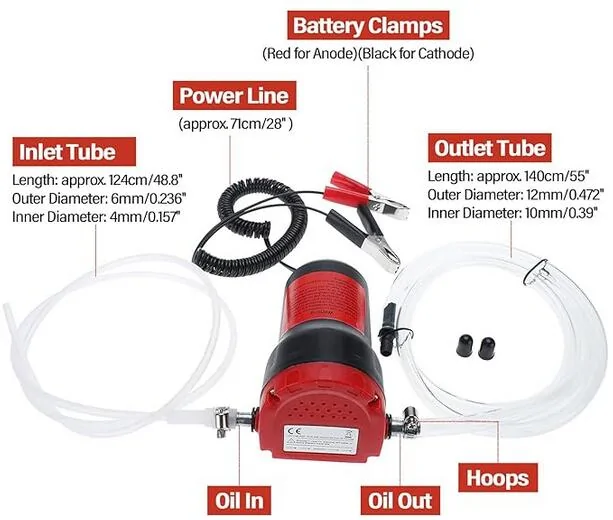

It is easier to do if you have the MBS Dispstick installed. Open hood and insert the tube down the dipstick tube, and it will fill the jugs just fast enough to allow you to monitor and not spill a drop. Put in the new fluid leaving enough room for the LubeGard platinum. I had an immediate and profound improvement. Truck shifts like new.

This is the pump I used $25. I hooked it up to a 40 year old 12v battery charger that I had in the garage. I am changing the trans fluid one more time when I hit 25K miles and change the engine oil. That will happen in another couple of weeks. or 350 miles, whichever comes first.
If you go this route add a brass fitting to the end of the outlet hose to help keep the hose in the jug. It will tend to want to fly out without the weight.
